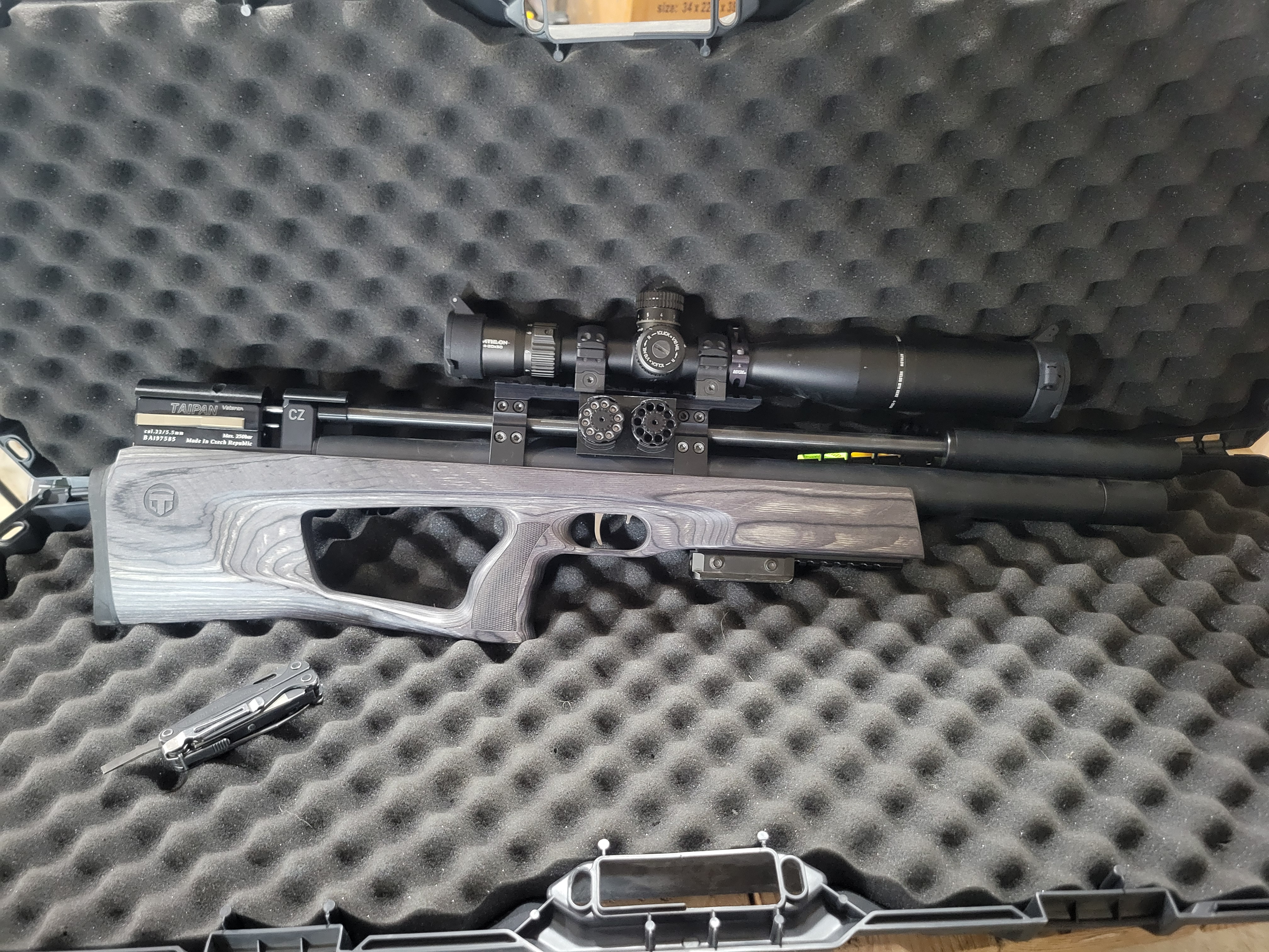

I'll start with a target I did the other day. Taipan Veteran Long .22 JTS 18gr at 915fps. 50yds. I will be trying this at both 75yds and 100yds when time permits. Probably try my Evol Mini which I tuned to 12fpe at 50yds for fun.

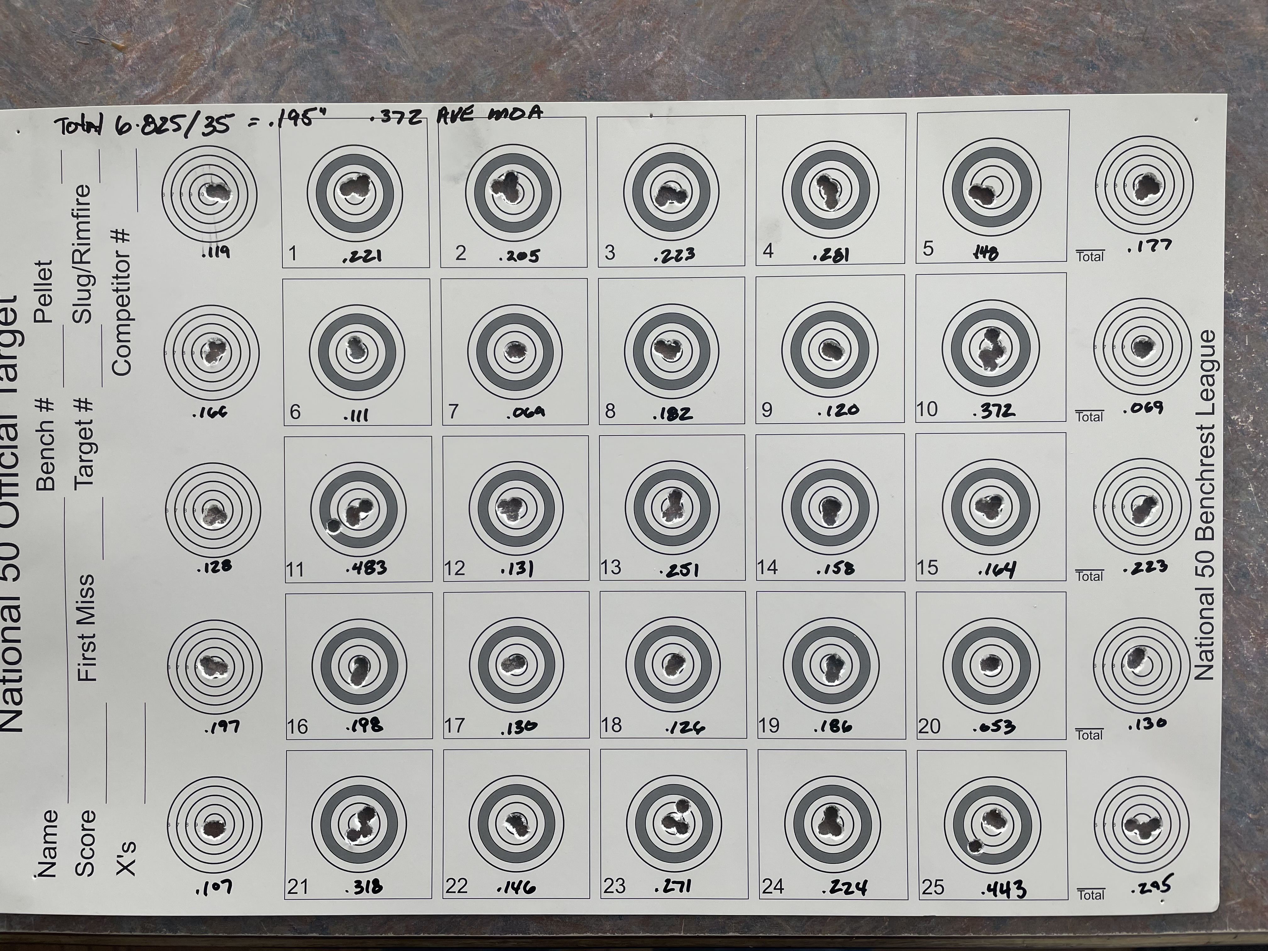

This was yesterday morning at 99 yards. It was taken while measuring BCs and the focus was getting those downrange shots over the Chrono eyes, but it turned into a good group anyway.
10 consecutive shots @ 99 yards, no sighters.
Just shy of an inch, probably something like 15/16"
There are three or four in that cluster at 630 of the 10 ring, and 3 or 4 in the cluster at 9 o clock of the 9 ring.
If scored I think it'd be about a 94/100, using the typical .30 plug. Which would work out to a 235 over an entire card. The gun in this configuration has had some high 230s but has been averaging low 230s so that seems reasonable.
Taipan Veteran Long also.
.22 Monster RDs from about 2022?
Barrel is a 1:32 6 groove polygonal (an RTI "LR").
I can share some 4x5s in the future. I really like the format of sequential shots, either all into one group or of multiple groups, no sighters. Showing all shots taken really shows what a gun can do.

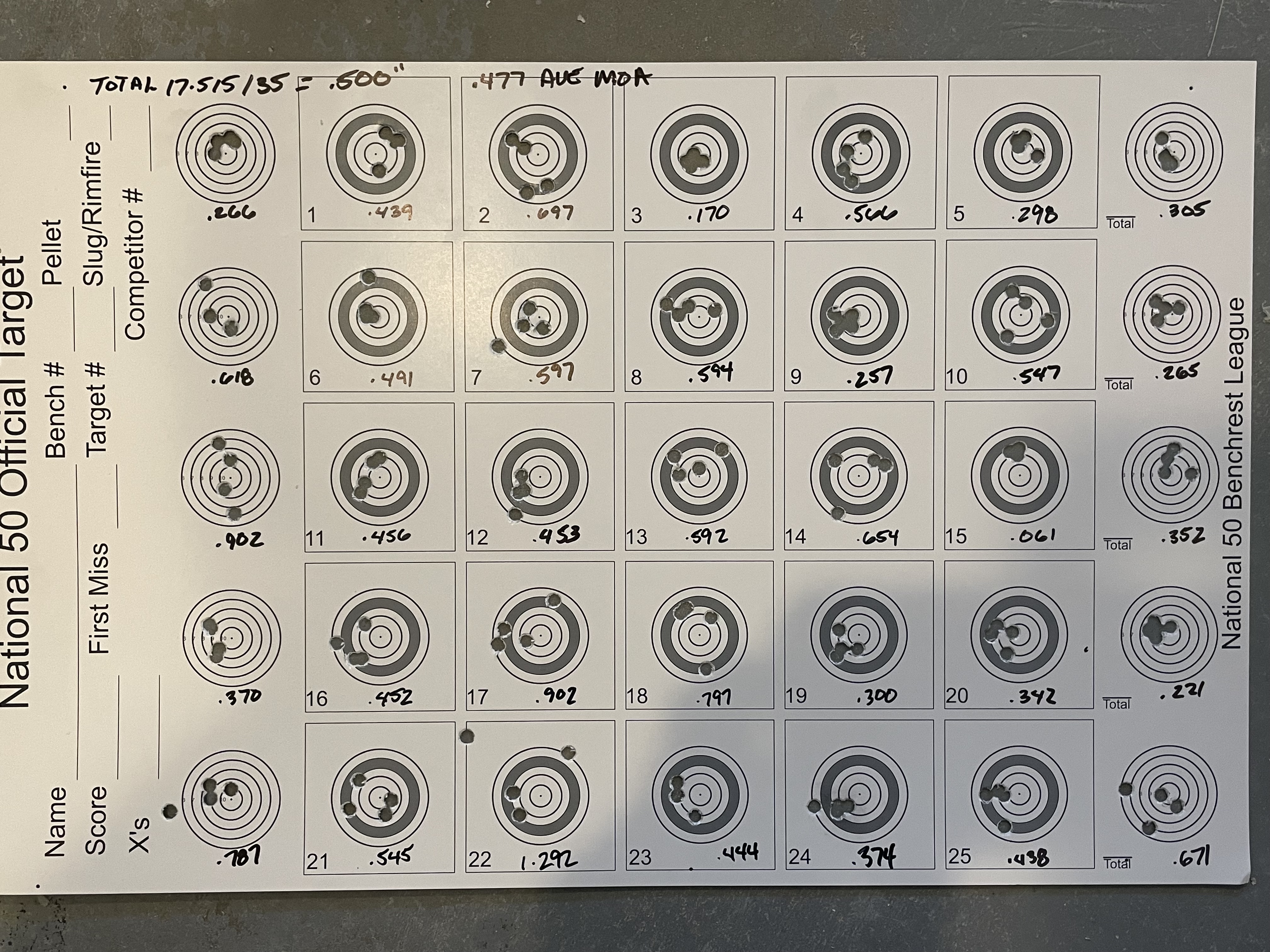

Wow that's awesome! When I had issues with my barrel, I was thinking about sourcing a .22 RTI LR barrel as well to try out a slow twist barrel. Clearly it's shooting very very well.
Reactions: Franklink
The best I've seen with MRDs, after a hard, 5 year long fight and lots of barrels.
Dunno if it's all "LR" RTI barrels, or if this one is special, but I'm so far very happy with the results.
Reactions: Dairyboy

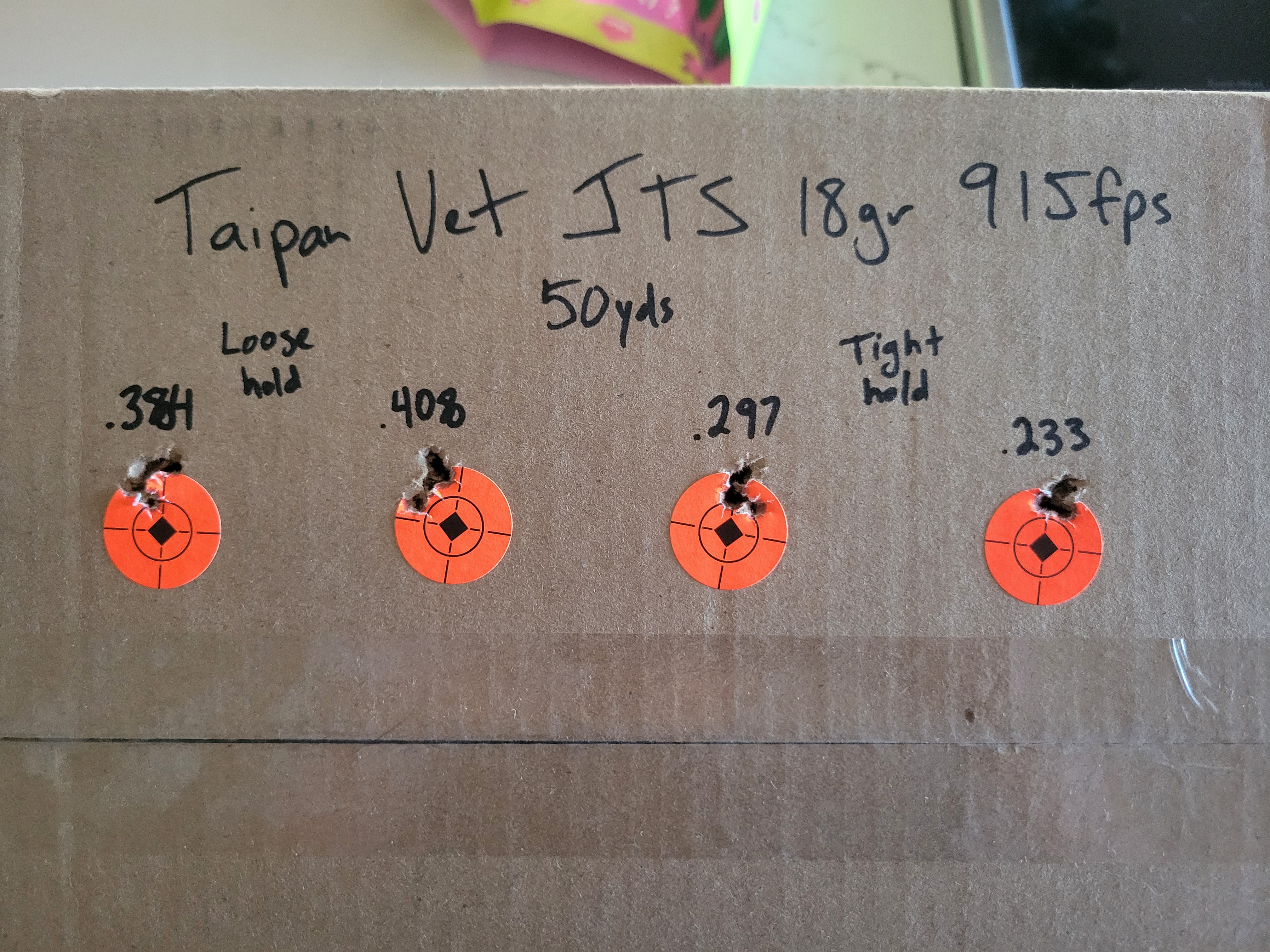

View attachment 464631View attachment 464630
Rightly tighty lefty loosey .
They seem to be made with 18gr pellets in mind . Nice groups. The bouncing around must have helped . Lol
Reactions: Dairyboy
@Dairyboy, Excellent shooting on your part. I will give the format a try when I get a block of free time. I suspect I’ll be the weak link in the four, five shot group shooting session. 🙏
Thanks! I was on that morning usually I'm the weak link too! Again it's just for fun nothing serious!

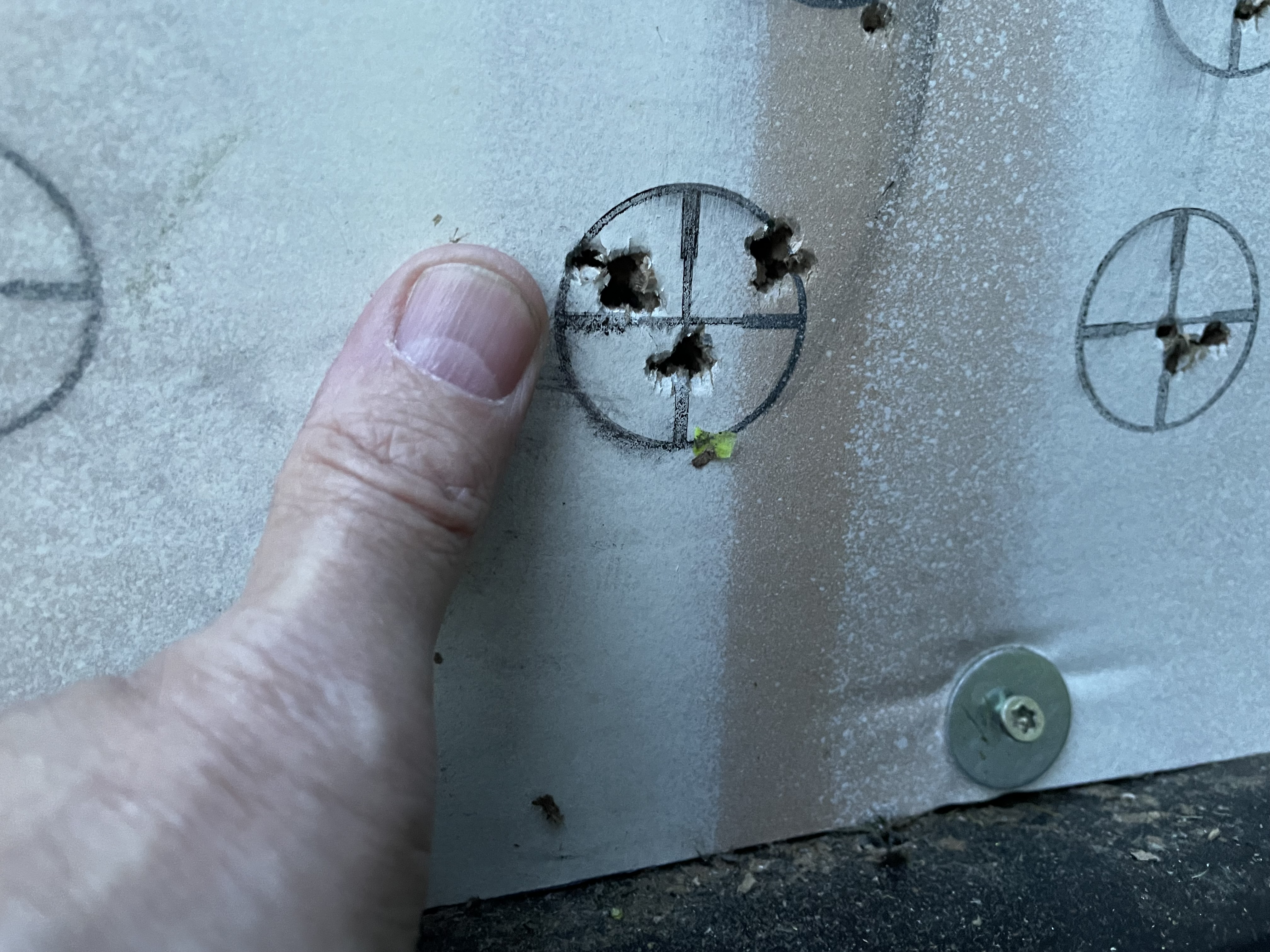

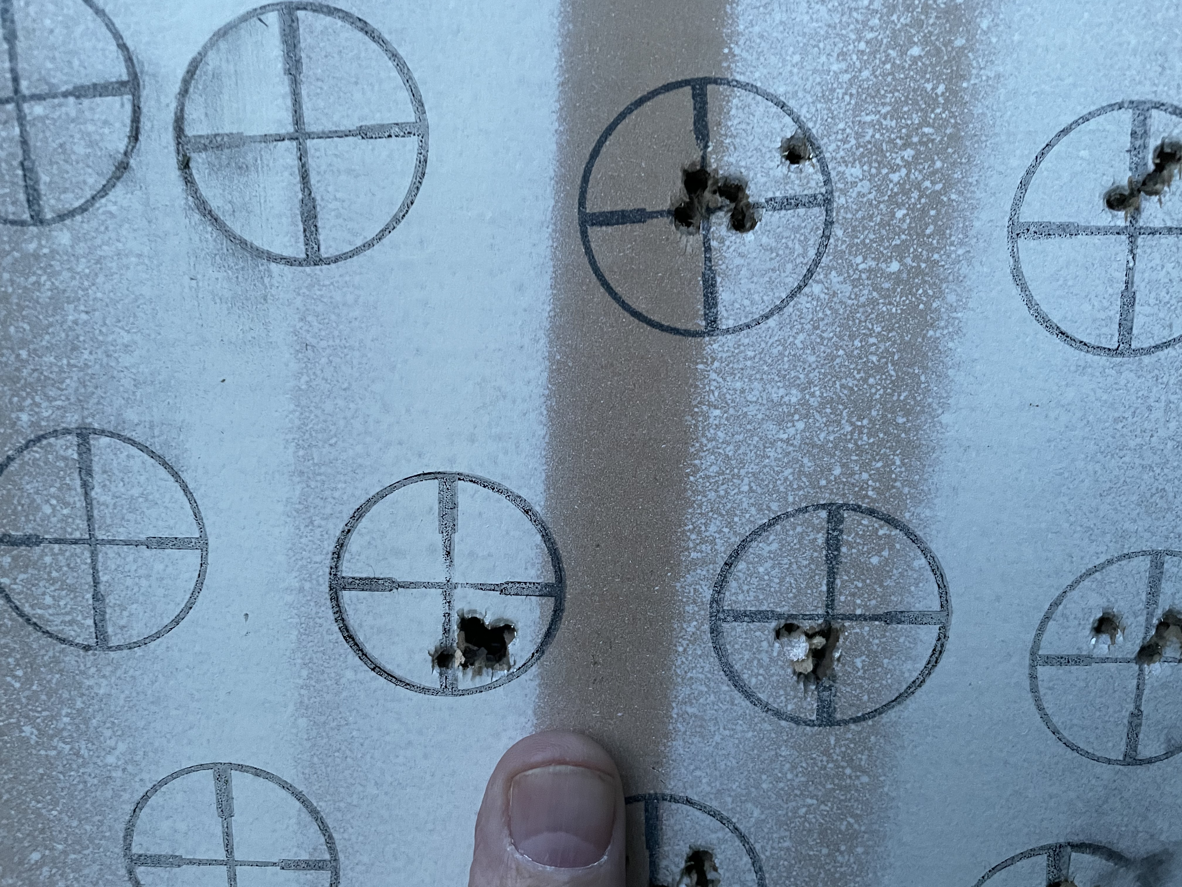

Here are 3 five shot groups on the single target, and then some others shot in the same sitting. JTS 22.07,and JTS 25.39 @ 54 yards. My thumbnail is just over 5/8” for scale. Skout .22 on a low wind morning.
All these Skouts sure seem to be shooting very well. My interest has been piqued in them recently.

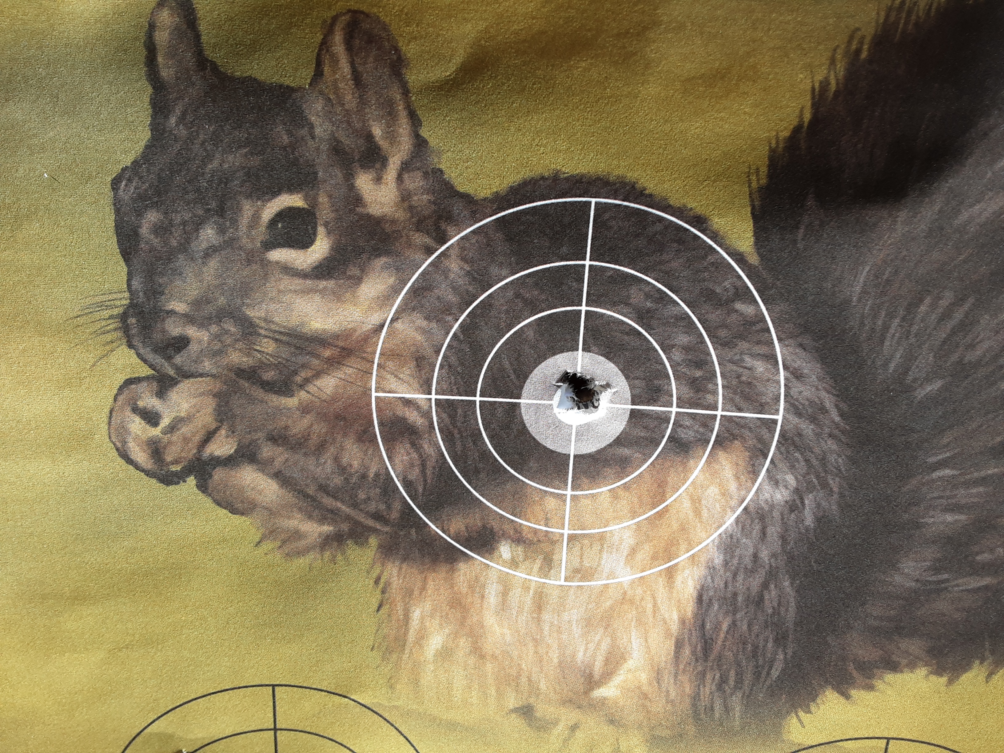

Consecutive shots at 100 yards. 10 ring 0.485”, 9 ring 1.2 inches. Obviously sub MOA. .30 Skout AEA 45 grain pellets.
I think this one was 6 or 7 shots. Not exactly sure but well inside MOA at 100 yards.
Like this also. Super impressive.
