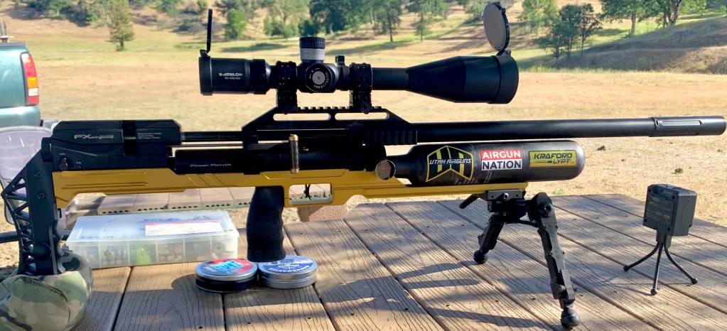

Take a look at Athlon Optics. Specifically, the Athlon Argos BTR Gen 2, 10-40x56. The things you’re looking for, high magnification and good optics for under $500 are going to be hard to find. My son and wife both have an Argos 10-40x56 and really like them for the price. All of the Athlon scopes have a seemingly bright white image that makes them seem brighter than they really are(as opposed to especially European optics with very saturated colors). They’re all great scopes, don’t get me wrong, the Argos is just not one of the higher end models in the Athlon line up though. It is still a very nice scope, especially for the money. As someone already mentioned, as magnification increases, the exit pupil decreases, meaning less light gets to your eye. This is figured by dividing the objective by the magnification you’re using. That is true, but at least you’ll have a large objective, 56mm and up to 40x magnification to help you see things better at a distance. My boys, wife and I shoot past 100yds often and like high magnification scopes too. I think the Athlon Argos BTR Gen. 2 10-40x56 will meet all of your needs. It’s also got a lifetime warranty and they’re a great company. The scope retails for $537 but actually sells for quite a bit less than that. They can be found on E-Bay for $300-$350 or so fairly often. Here’s a link to the Athlon website and the Argos BTR Gen 2 10-40x56. https://athlonoptics.com/product/argos-btr-gen2-10-40x56-blr-sfp-moa-copy/ Other than the Argos BTR, there are some higher magnification Hawke Sidewinder scopes, Falcon and Sightron but they’re all a lot more expensive. Good luck with you’re scope hunt, let us know what you decide.
Stoti
This is the Athlon Argos BTR Gen 2 10-40x56 on my son’s FX Maverick.
