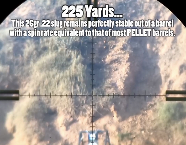

This is taken from one of Matt’s videos If the spin rate is the same when he’s shooting these pellets at 950fps the twist rate isn’t going to be 1:16
It will be very similar to the pellet line in my opinion
