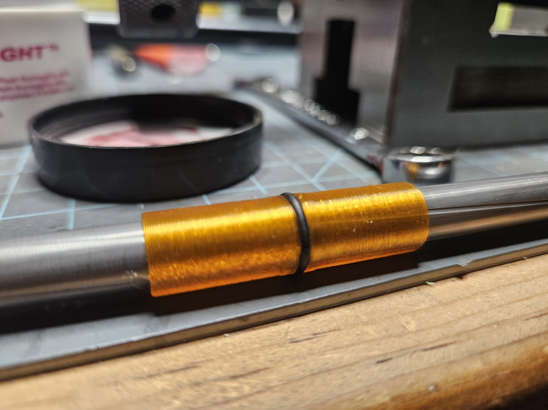

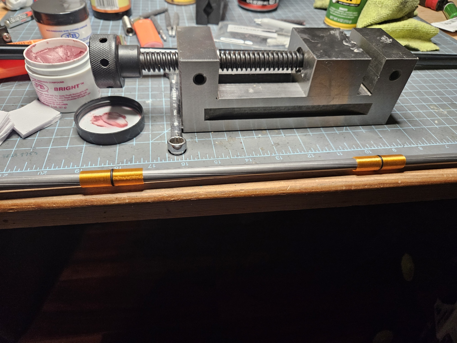

After lapping 5 liners yesterday and reassembling the barrel assemblies, I got tired of the orings moving around. So I printed TPU holders to lock them down. I attached a ZIP file with STL files for .22, .25, and .30 liners.
View attachment FX Oring Guides 22 25 30.zip

Ya I was using duct tape for awhile. I just needed an excuse to keep up with my drafting and 3D printing hobby.

Man I never would have thought of that. I bet it would work great on the .25 and .30. The .22 orings seemed oversized and a little tighter than the other two. The tube threading may have been an issue on the .22 liner

Ya I tried that but the heads of the zip ties are too large for the .25 and .30. The tube ID is about 11.5mm and the .25 liner is 9mm OD. The .30 liner OD is 10mm.
