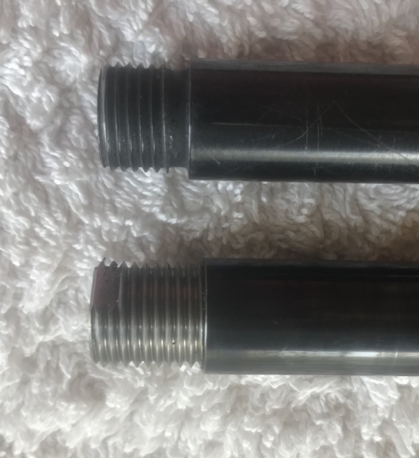

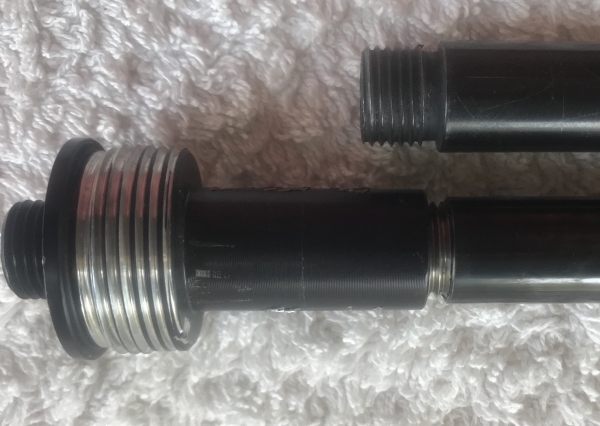

Also for anyone who buys the bare barrel upgrade. Although fx says you can use your original shroud don’t. The tread on the smooth X is longer and you shroud will float on the treads instead of locking up against the outer barrel sleeve. This will cause accuracy issues.
1543977139_17949212675c0738b3377ac4.32028887_23B08FB0-21E4-47DB-9AF1-88287AD2757D.jpeg
Michael
