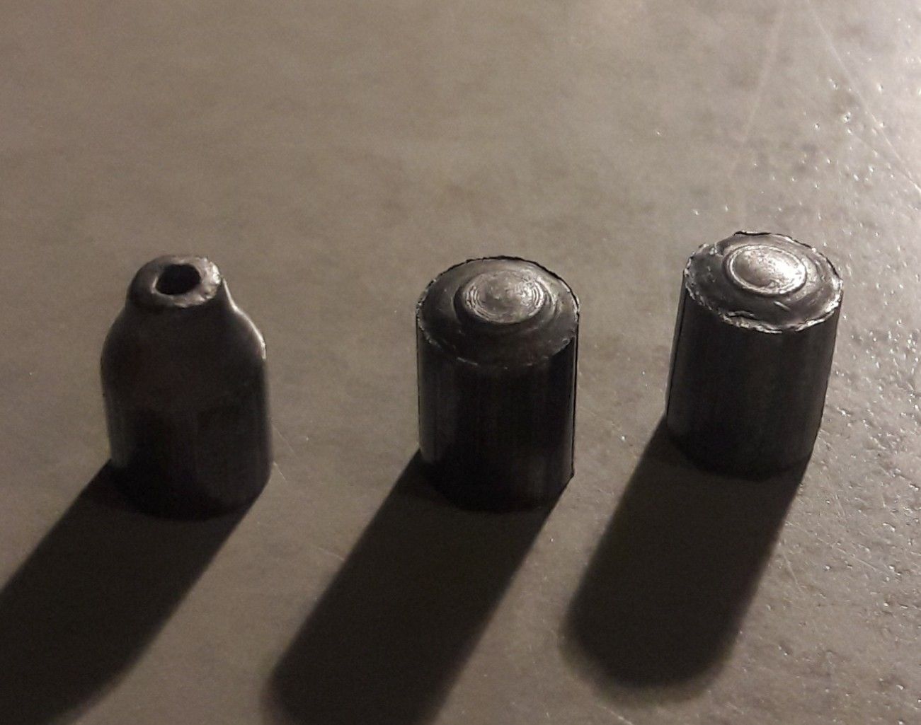

Slugs are NSA .217 and are extra tight fitting in the barrel. Was at a 10ft distance, loaded the gun and took a shot. Thought it misfired so i went to load the next slug and thats when i noticed it was stuck. The second one wouldnt feed and it was stuck halway out the breech/magazine so i couldnt take the mag off eventually got the 2nd one through to take the magazine off.
First time getting a pellet stuck in the prod...
2 hours worth of effort. 2 broke rod sections and a bent handle...
I did have to heat the barrel a few times to get them to push out. And i guess i was wrong, there was 3 slugs. 1 about an inch from the muzzle and the other 2 dirrectly at the breech.
The funny cone was the last loaded, first out the breach.

Not really nessicary. The prods favorite pellet are metalmags and have not had any issue with takedown. I just figured id try the slugs "on field" to see its end result... well the results were a firm negative. Il stick with the metal mags to feed my prods appetite.
Edit: And for future reference... p/m rod or other gun barrels with the breach oring in the barrel... remember/attempt to take it out if you plan on heating the barrel. LOL. I forgot, but realized after that it was impossible with where one pellet was stuck. Good thing a had a spare...
