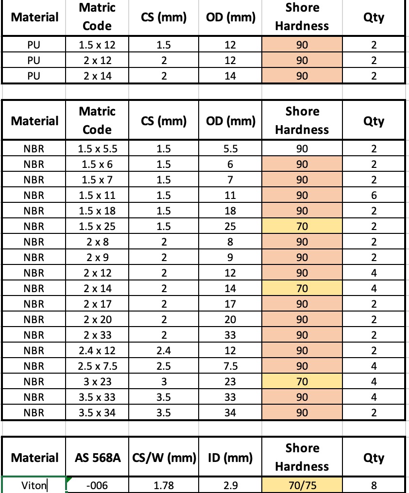

Was wondering if anyone vould confirm if all the oring sizes in the nova liberty assembly manual pdf shared in this thread, applies to the .25 caliber? The manual only lables the .177 & .22 caliber (M1000 & M900). I have compiled them into a lits with respective shore hardness.

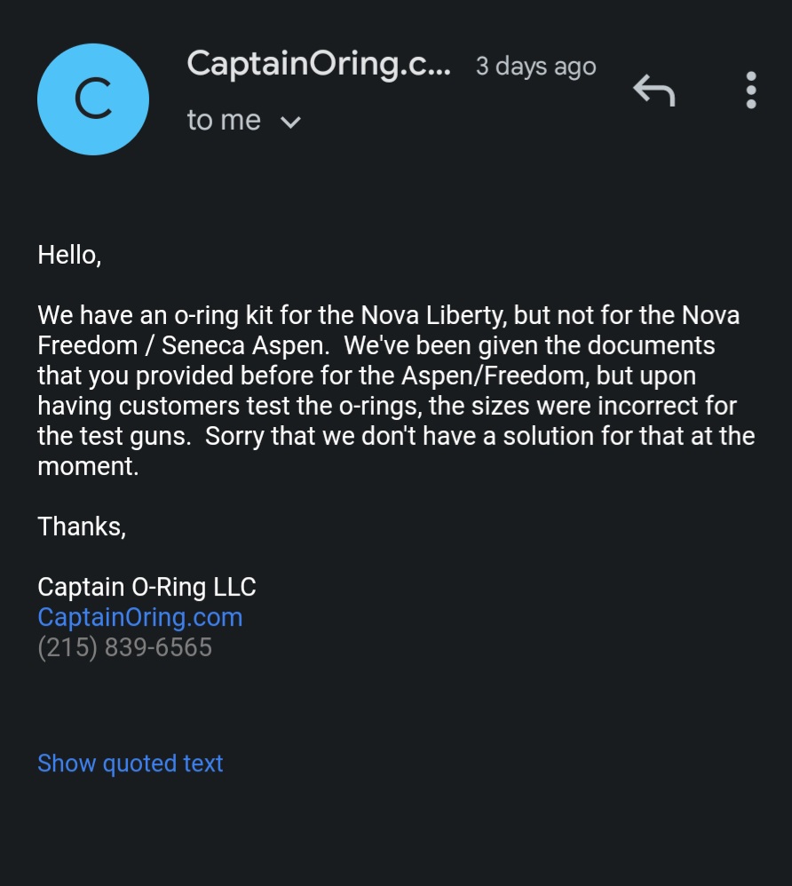

I also contacted captaining.com as they make sets for avenger and some other pcp's, however their response was that they had tried in the past with some customers, based on the specs from same assembly manual, only to have reports back that they don't all fit 🤔
Try calling Pyramid Air. They were very helpful for a problem I had with the pump in my Nova Freedom.

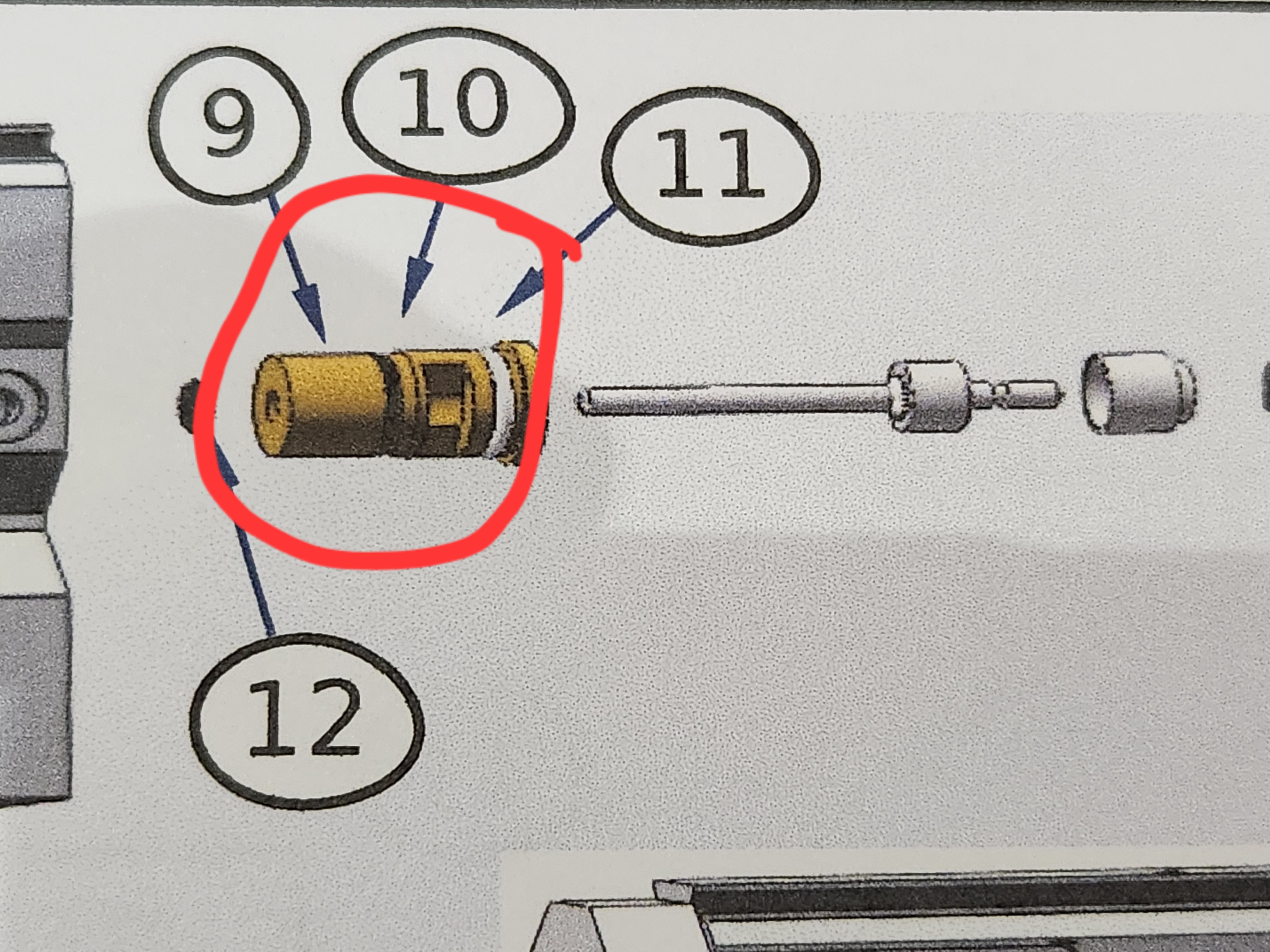

Guys can anyone tell me if they have ever had an issue where pumping up the gun for empty (bleeded the release screw) has air coming out the barrel after 3ach stroke. I can literally here the air releasing from the barrel. I just rebuilt the pump and replaced the seals in the air chamber. The only part I could no figure out how to remove was the "air release valve sleeve" as it is seated deep in the aluminum valve body. Any thought much appreciated.

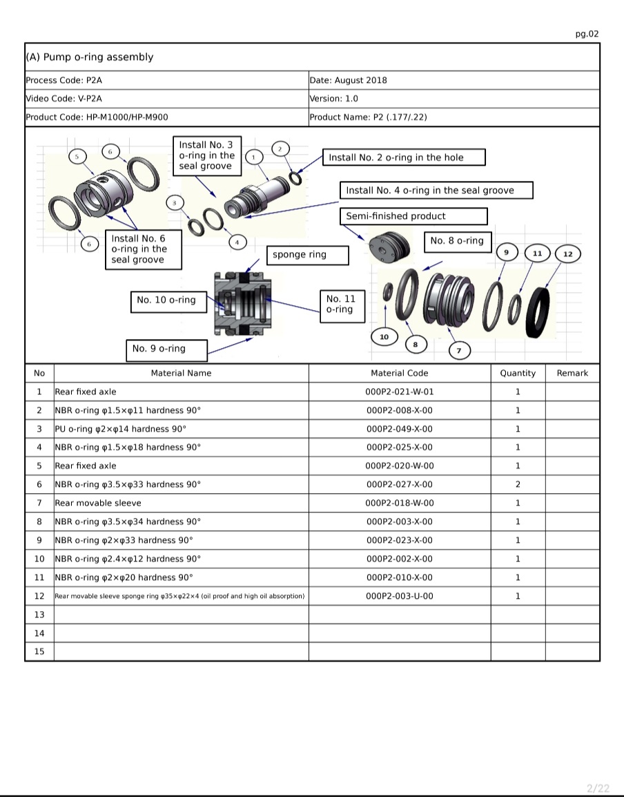

Please also find an updated 2020 version of the assembly manual which I acquired directly form Nova Vista. You will notice main changes are made to part numbers (includes .25 cal), small piston head and the pump check valve (now 2 brass parts). Also changes to the lubrication notes (includes graphite grease). Take note the old manual mainly had oring CS x OD, the new manual is mostly ID x CS. They seem to have replace many PU oring from the old guide with NBR shore 90.
View attachment P2 PNEUPUMP synthetic stock Assembly Instructions 11062020(1) (1).pdf
If air is leaking out the barrel it most likely is the poppet valve. Seeings how it was made in 2019 it has the old style poppet which has some really soft material inside the metal can. The material wears down until the metal can starts resting on the brass exhaust valve and won't seal. As far as being able to get to the valve you need to remove the air tube which the pre charge pressure must be released from. There's a floating piston that separates the charge aka the air pressure you've pumped in from the precharge air pressure that was in the rifle when you received it. I would suggest if you're not really sure about what you're doing send it to PA and have them repair it with the updated valve which will last a lot longer than the original.
Thanks for the details reply. I did manage to get the valve out and found that the original PU oring on one side of the valve had turned to a sticky mush. The other orin is nbr and no so bad. I have changed those orings and now all works perfect (holding charge at 2k psi so far. When looking at the poppet I did notice the rubber seal ring between the pin and can. Mine is still intact, but does have an indent mark of the opposing brass outlet. Do you think it would be possible to replace the rammer om the poppet? I don't live near the US so getting a valve from PA is virtually impossible.
