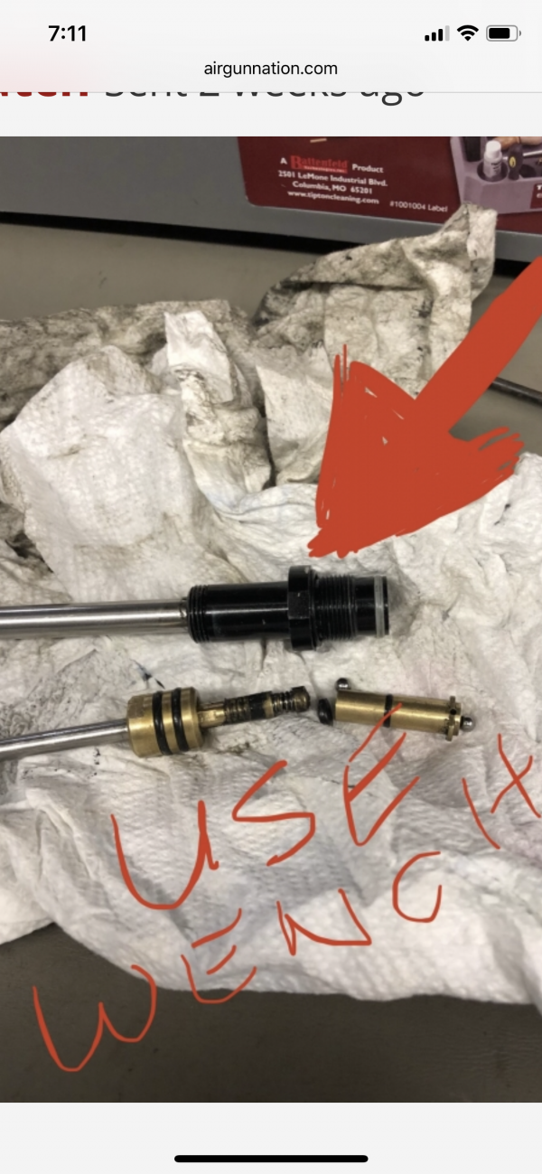

New member here and limited airgun experience level coming in. This pictorial instruction was very helpful in repairing my Seneca Aspen pump. On the high pressure brass piston I replaced the two larger O-rings with Mil-Spec M83248/1-905 o-rings, hopefully they live a longer time. The smaller inner o-ring I could not match to a Mil-Spec o-ring on hand so I bought the Harbor Frieght kit 67580 and used the on kit #008/P5 id 4.8 x od 8.6 x cs 1.9.
To disassemble the lower (closest to the receiver) desiccant tube holder from the stainless steel inner piston tube I used a large inner snap ring pliers, Matco TP25A and a 4" vice grip on the SS tube. The pins on the pliers are at 90*. It was tight, but that did the trick.
Reassembly I used Dow Corning DC4 silicone grease and Super Lube o-ring lube. Pumped back up. It took many strokes, 60, to get from zero to 2500psi, paused after each 20 for heat considerations and moving cautiously. Test fired a magazine of ten with the usual 4-5 pump strokes to maintain 2500psi. Seems to function normally so far.
The oiling, IMHO, will not adequately lube the high pressure piston o-rings. The oil just has too far to go to get there. My rifle made it to about 3000 shots with very generous oiling. The factory assembling was not done with mil-spec o-rings and aerospace grade silicone grease so my hope is that I will have to do this less frequently, but I'm sure I'll be back into the pump again.
Thanks to all who have contributed to this repair information. It's been a week and no replies from Pyramyd tech support emails. The phone call was returned to tell me I was out of warranty and perhaps I should have considered the extended warranty, ouch!
Whitz
1551143623_10224086095c7492c7355542.90582797_579885FB-C8AA-45DE-9A82-E0FF968F9649.png
Yes, I raised it from the dead. That brass piece and 2 check balls are what is giving me fits!!!🤬🤬 I just can't get them to seal. I've cleaned and cleaned and cleaned. Used high quality silicone grease and it still leaks.
