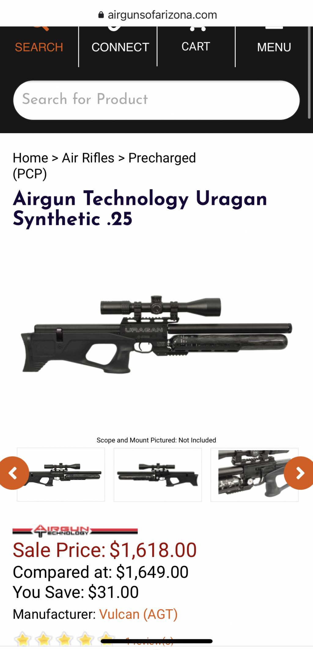

Uragan = USD 1,619 at AoA
You made me go there and check, true but for the mini, I was talking standard. $1889... At this price... Other guns will compete.
I also checked with Utah airguns and the Taipan Long and standard are both at $1400 right now. I'll say price difference is important, because you can grab a nice scope with the difference.
