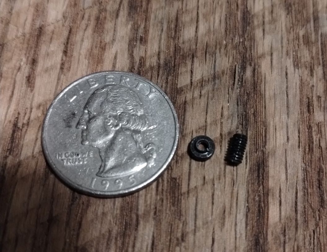

Stripped 2240 Breech Screw...
Try squeezing the breech and tube together. Should help to take some of the pressure off of the head of the screw and let it turn a little.
If you drilled down into the screw shank itself, and not just the head off, find something that will fit tight in the hole and epoxy it in. That should give you something to grip to turn the screw.
If it's really bad, finish drilling the head off and lift the breech off. Then pliers to unscrew the rest.

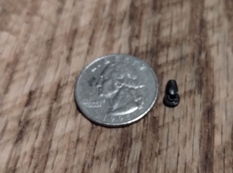

I started looking on the work bench and found the one I removed around 3 months ago in a repair for a friend here is a pic of the successful removale when using the clamp that was suggested to you. I hope you are as fortunate as i was in your endeavor.
It can be a lil tricky lol.
