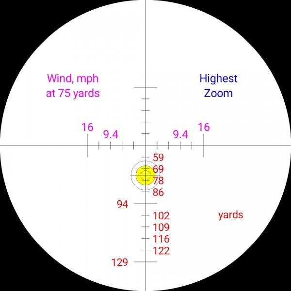

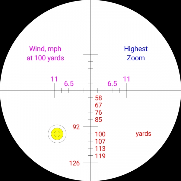

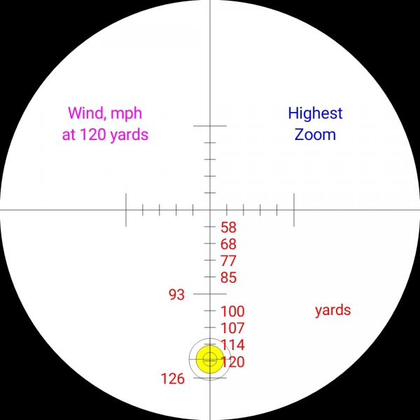

Thanks LDP, I agree wholeheartedly! I just happened to catch an offhand remark recently regarding the fact that there is a free version of Strelok... so I went to my Google Store on my phone and downloaded "Strelok Ballistic Calculator" free version instead of the Strelok Pro just to chuck it out. It turns out that it does everything I need it to do so that I have no need for the "Pro" version. I am not terribly sophisticated when it comes to electronic devices...wouldn't even know how to play a video game... but I had this app up and running perfectly in no time. Here are a couple examples I even emailed to myself! This is exactly what my Sightron reticle looks like except mine has a floating dot in the center.... man with this on my phone and my Athlon Range Finder I am going to be set to the bone! :)
For this one at 100 yards I put in a 10 mph cross wind coming from 90 degrees right.

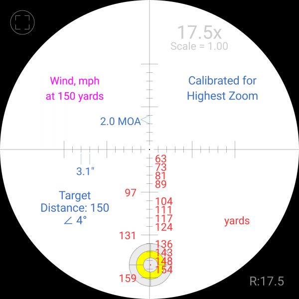

Here is what my Sightron STAC MOA-3 Reticle looks like set for 150 yards:

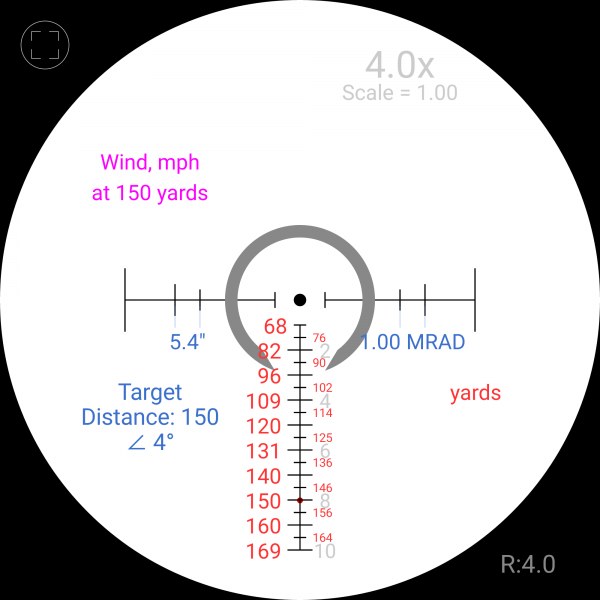

...and here is what my Bushnell Prism Sight Reticle looks like set up for 150 yards:

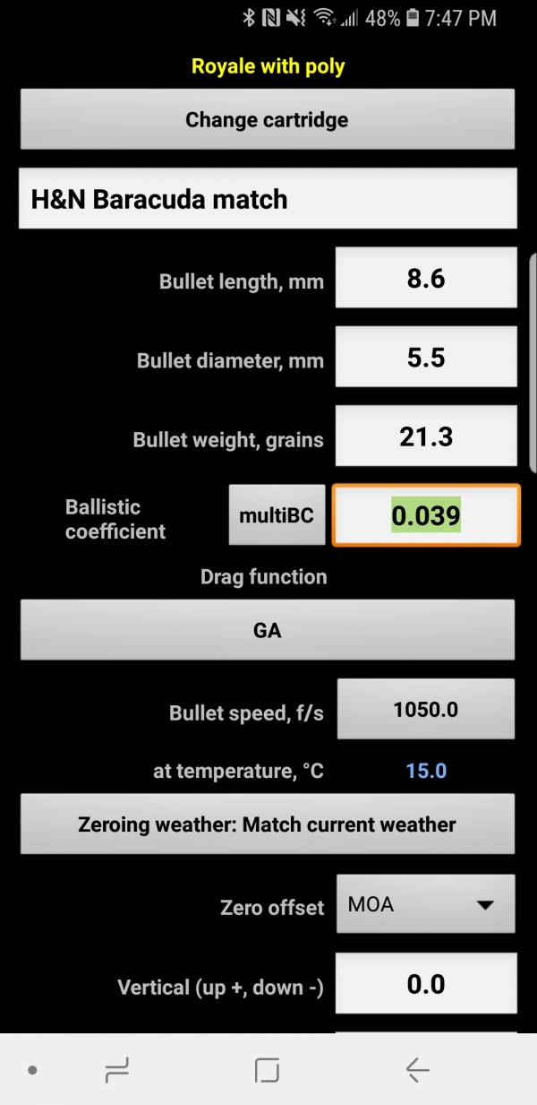

I don't think that the airgun specific drag curve GA is available on the free and on the + version, only on the Pro version (but correct me on that, pls).
If we get more airgun users onto Strelok, maybe we can convince Boris (the developer) to get us a few functions that ChairGun (PC version) offers -- like calculation of BC using two different velocities. Or kinetic energy, by entering velocity and weight.

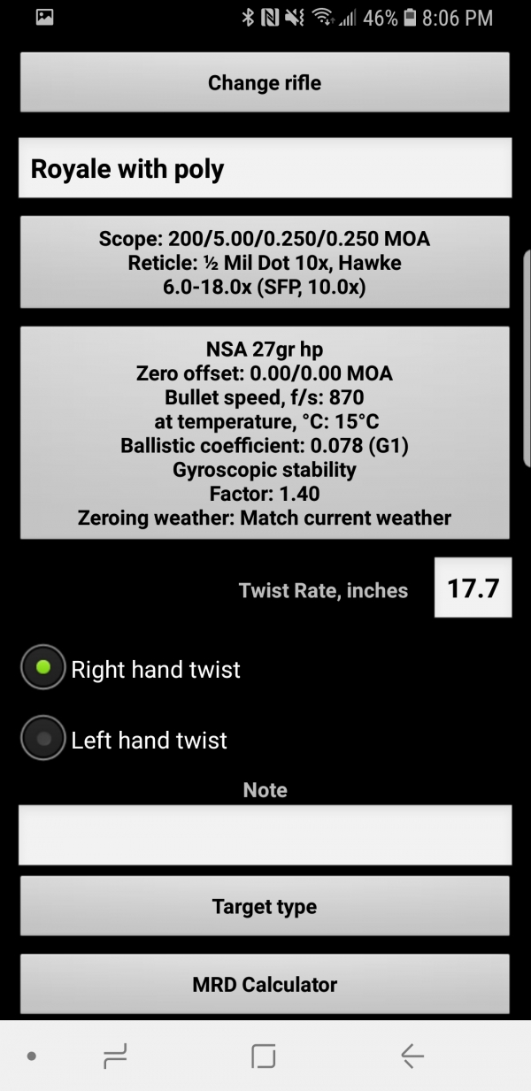

Another cool thing just below BC in this screen it says "gyroscopic stability factor"
That factors in pellet/slug length, weight, diameter, speed and barrel twist rate to give you an idea if the projectile is stable.
1.0 is barely stable anything lower is unstable the higher the better, so far its been very helpful as to whether slugs of a certain length/weight/speed will be stable or not.
1545883426_7977873195c244f221c0b78.00689504_Screenshot_20181226-195352_Strelok Pro.jpg
Compare that to the 27gr NSA slug, more stable than the baracuda but both are stable to 200m
1545883632_9371720135c244ff05c8568.36967724_Screenshot_20181226-200615_Strelok Pro.jpg

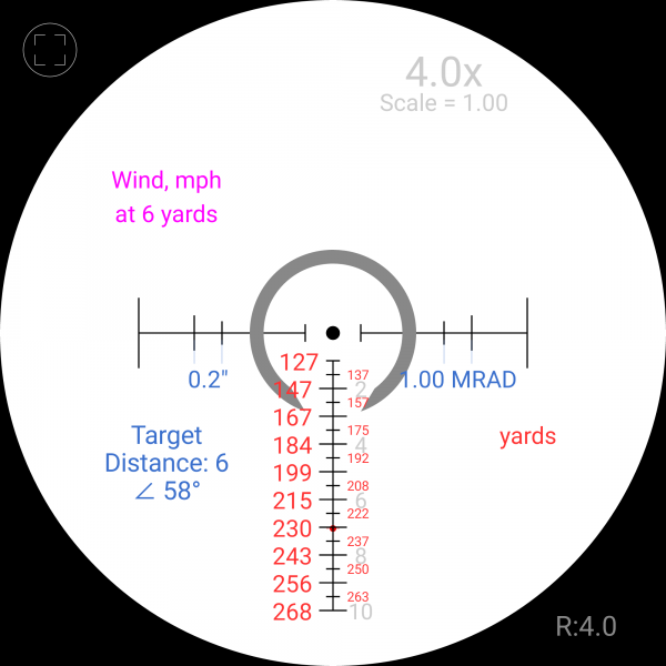

Wow I just changed it on my Strelok Pro to GA! Thanks! I am just blown away by this program! For example, I have a big coconut tree in front of my porch that is just loaded with big coconuts at this time. So this afternoon I ranged one big clump of coconuts at 6 yards with an upward angle of 58 degrees... and hit calculate and BAM! it shows me a red dot on the reticle where to holdover exactly 7 mils! And it works perfect! Here is what it actually looks like... and I know someone is going to want to know what happens when I shoot a coconut with my Wildcat at 63 fpe so I will tell you now. These coconuts have a very thick fibrous outer husk and a hard inner nut that is filled with water. A 34 grain pellet at 915 ft/s punches a hole straight through and out the other side like it didn't even feel it! I think at close range you could drop a buffalo with this much power! Well maybe a small one... :)
