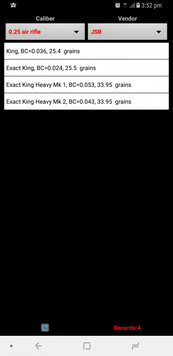

I think I didn't explain it well in my original post. All those who are using strelock pro can check that while setting up a gun, there is a cartridges database where you can select the pellet that you want to shoot. While in the database, If you go to the .25 air rifle pellets and select JSB it shows two types of 25 grain pellets. I am not talking about the 34 grain King heavy pellets here but the usual 25 grain pellets. Have a look at the below picture. I never knew or have never seen two types of 25 grain pellets as listed in strelock pro. I have looked at several tins of 25 grain pellets and all have JSB EXACT KING printed on the label. So which one should I select from this list?
