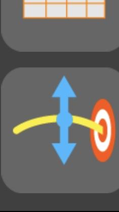

There is an application to true the bc You do it by entering your vertical correction at a distance past your zero distance. It
will then work out your bc based on the pellet drop
Here

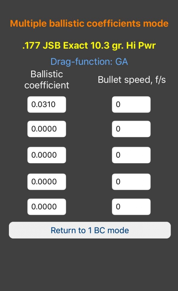

Yeah, it’s confusing. I think you may be on to something. When you look at the Strelok section here.
So
You can enter a single BC for your pellet and muzzle velocity or you can select multiBC and it goes here
Now you’re on this screen. Say you’ve calculated BCs at various distances and set up so you measured velocity at 25 and 50 yards. Then you calculated your BC at 25 and 50 yards with those two velocities. So do you enter the velocities at 25 and 50 yards used to calculate those BCs or do you enter the muzzle velocity, which would be the same?
