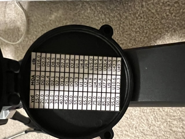

I love the Strelok app and use it often. I use the GA function for all projectiles and it works very well. When I tune my gun I plug the info into strelok and set the app to make a table or chart with 5 yard increments that show moa adjustment and number of clicks. Then I email it to myself from my phone and head to the computer. Pop that puppy in excel and print out a micro dope chart that I usually stick inside my scope cap or simply tape to the stock of the gun. I write what the chart is for on the back. Example: jsb 25.39gr 885fps athlon scope 0@35yrds. Also I use clear packing tape to seal the paper so it doesn’t get messed up. I’ve yet to reuse the same chart twice but they hold up well until I make another.
