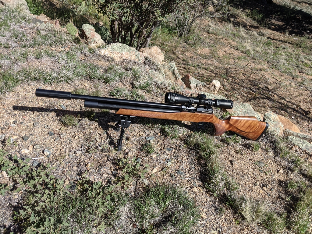

l was trying out a couple of LDCs on my Streamline and today I noticed it was shooting in the mid 400s. Long story short, the barrel had moved forward about 15 thousands of an inch and the probe was not seating correctly. Just another thing to check when trouble shooting.

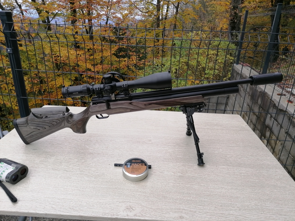

@ Freddie - Thanks for the tip! Man, I bet that was frustrating until you discovered the issue. Nice stock on yours! What LDC is that pictured? I’m guessing the TANTO? What caliber is your SL?
Thanks, and yes that's a Tanto in the photo. It took me about 2 hours to find the problem. My .22 Streamline is a great shooter, you're right, they don't get enough attention.

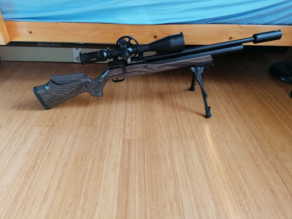

Love my SL .22 walnut a lot too. It took some time to tune it after the installation of the Huma reg. But now it shoot better then out of the box. Fantastic rifle !
