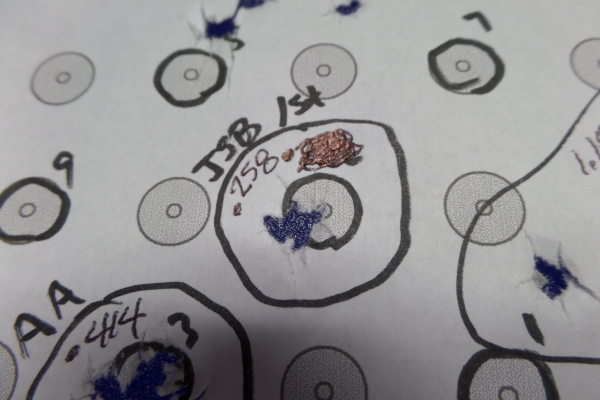

First up was the JSB 25.39.
This pic is the very first three shots for the warm up. Notice there is not much need to worry about the reg setting in as I have mentioned on other threads. This gun shoots pretty well after a fill with little to no POI change with fresh air fills to 230bar, 225bar for this test.
Take note that this was a warm up 3 shot round, was not suppose to count in the story, actually I didn't plan on even showing these, but as it turns out I must be a little shy about performance....because this was the best group of the day. .258 for three shots. JSB 25.39g

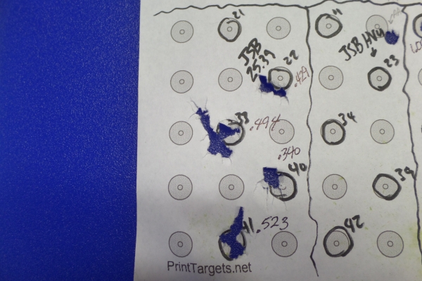

I then shot the "competitive" groups for the JSB 25.39 and they are shown in this pic.
I shot 4 different groups. Groups range from .340 to .523 for the JSB 25.39

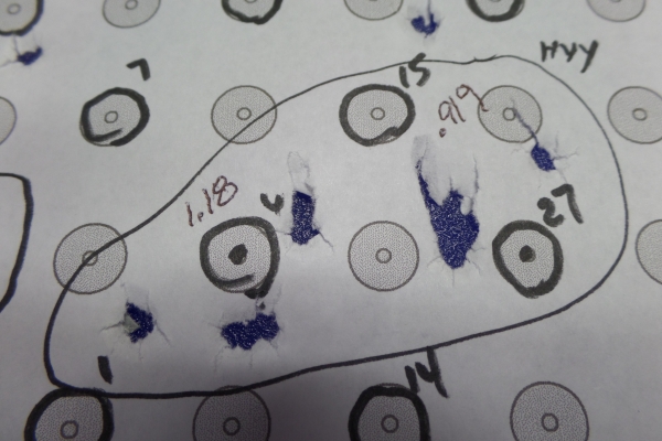

My POA is for the #6 bull and the #27 bull. The groups were 1.18 and 0.919 respectively. These were shooting so sporadic I didn't feel comfortable shooting them in the competition part of the target, for fear of hitting out of the respective grouping and ruining the bulls outside the designated area. So these are the only shot I took with the Heavies. I have shot these before with the Streamline, in the chrony thread I started a few days ago and they grouped much better, still not as good as the 25.39's. I don't know if it is because the wind is out of the east today and normal prevailing winds are out of the south? I just don't know at this point.

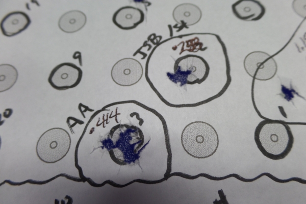

So the next pellet up is the AirArms Diabolo Field at 25.4g(AA). Here is the practice group.
Very respectable grouping here at .414 for the practice. Keep in mind these were shot just after shooting the JSB Heavies and with a fresh fill to the gun at 225Bar. This gun is so sweet to stay on POA after a fill, it just makes me giddy. lol. Sorry, I digress. Here are the competition shots for the AA pellets.

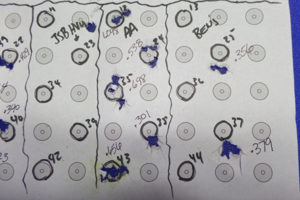

The AA column is bulls 12, 24, 35, 38, and "43" for fun. Basically the center column of the 3 column shown in full. The results ranged from 0.301 to 1.098. The 1.098 group had one flyer that hit just above the 23 bull over in the JSB HVY column. I really think that was on me, I noticed I had the gun somewhat "pre-loaded" between the bags after the shot. It is what it is, so I included it since I was shooting in the "competition" area. Still not a bad grouping string for the AA pellets. The reason I said "43" for fun was because it was hidden in the grass. I could just make out the top of the "3" in 43 and had to extrapolate where the bull was in the grass. Hence why the green stain. lol.

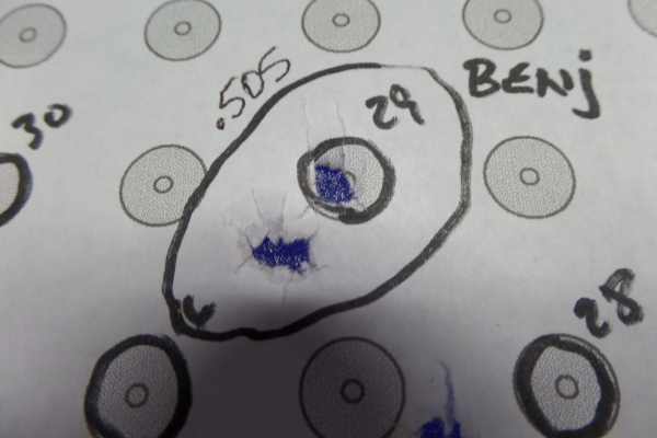

Next up we have the Benjamin pellets. Again the gun is filled to 250bar before the shots are taken. Here is the practice pic.
First shot was in the bulls! I was excited! And I think it probably shows, since the next two shots were well grouped together but were down and left slightly. Yielding a 0.505 practice group. Not bad Benji, lets see how you do in competition. Here is the comp pic. for the Benj.
I only shot two groups with the Benj in the competition part of the target. Simply because that was a total of three groups all less than the .505 from practice. The competition shots came in at .356 to .379. About the best I could expect from these pellets so I stopped there.

JSB 25.39 groups range from .258 to .523
JSB Hvy MKII groups range from .919 to 1.18
AirArms 25.4g groups range from .301 to 1.098 (.698) if we delete the flyer, due to me.
Benjamin groups range from .356 to .505
How I would rank as the favorite pellet of the Streamline would be JSB 25.39, then the AirArms, then the Benjamin, then the JSB Hvy MKII.

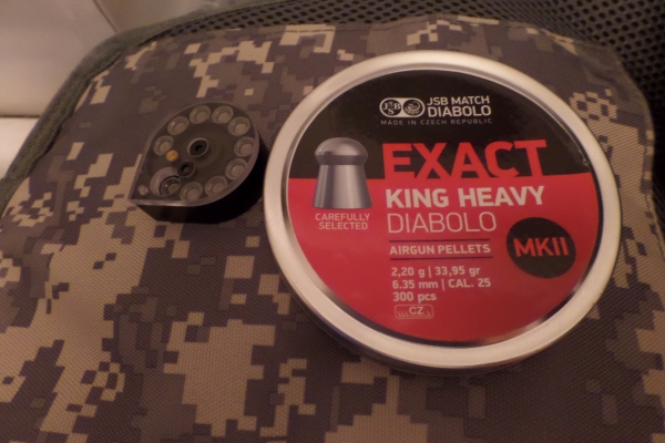

Any issues with the Jsb king heavy mk II fitting in the mag? I have king heavies but haven't tried them yet, but was told the mkII are really tight.

"Quintoona"I'm surprised the MKII isn't shooting well in your Streamline. They shoot the best of the 3 pellets I've tried in mine. (JSB King, King Heavy, and King Heavy MKII). They all shoot well. Do you know what velocity you are shooting at?
I was surprised as well. I did a thread on the velocities a few days ago and posted it here. If you would like to take a look.
http://www.airgunnation.com/topic/fx-streamline-25-chrony-data-jsb-25-39gr-jsb-king-heavy-33-95gr/
To answer your question the Heavies were averaging 831.9fps and the 25.39 JSB's were averaging 945.4fps.
I actually used the SST (single shot tray) on all the shots, but I think I have loaded the MKII without any issues in the mag in the past.....let me go check real quick.....yes they load just fine in the magazine. I think that was part of the reason for the redesign on the heavies to create the MKII's was to shorten the pellet a little so they would load better...I could be wrong on that, but that is what comes to mind. Looking forward to your posts on your results and thoughts on the Streamline.!!!

My gun was purchased in January and the MKIIs didn't fit the mag and I returned them. Don't know if they have changed anything since then or not.

Here is my, as supplied magazine with 33.95gr MKII pellets loaded and ready to go. They cycle just fine so far. Would be happy to load the poly and give them a try, but I don't have any. Sorry. Mine is only a couple of months old, so maybe they did make a change?
