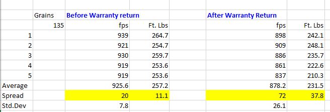

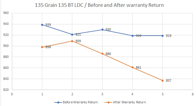

Anyway, still hand pumping, pumped it to 4500 psi, tested with 135 grain BT LDC from Griffin. The results weren't that great, in fact, from my perspective, worse than before I sent it in...but more on that later.
Here are the results.
Graphically:

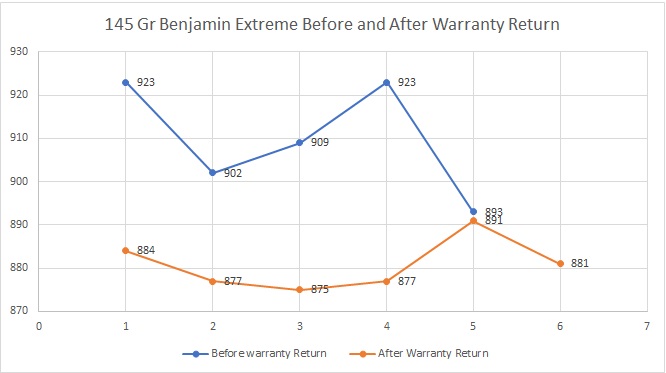

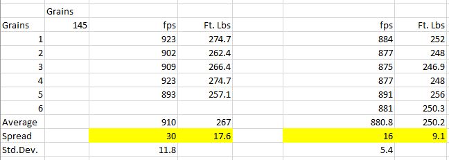

Anyway, so I cleaned the barrel, pumped it back to 4500 psi, and tested with the 145 Gr. Benjamin Extremes, and got better results.
It both cases(135 Griffin and 145 Gr Benjamin eXTREME), the power spring was turned back 3 full turns from full tight.
I'm new to this, but I am guessing I was wasting air on the 135 and need less hammer spring. Either that or the fouled barrel had more of an effect than I would have guessed.
