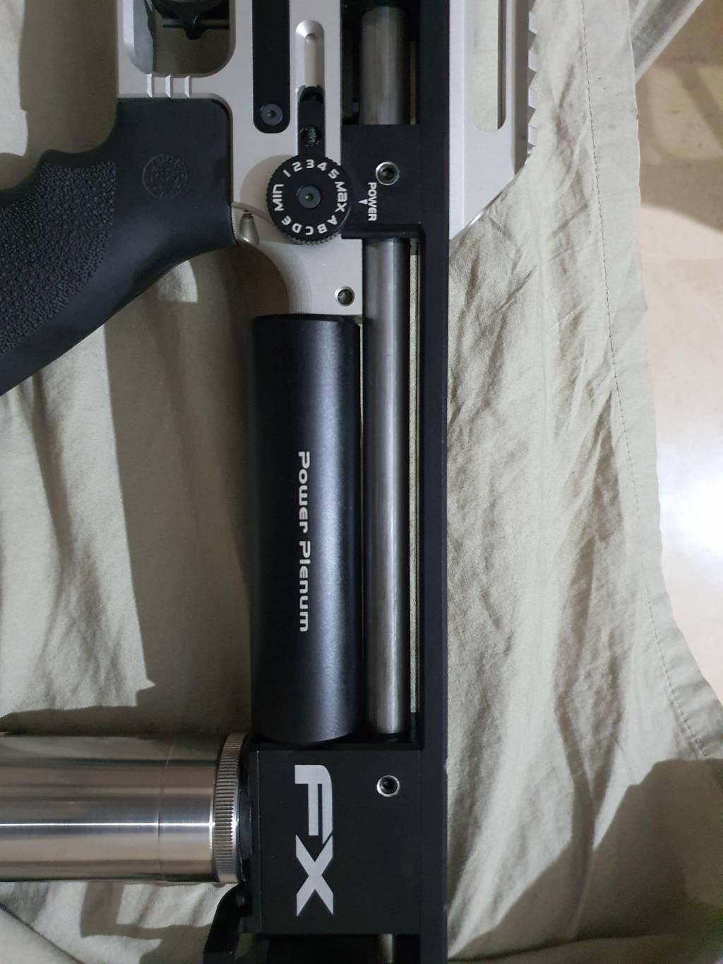

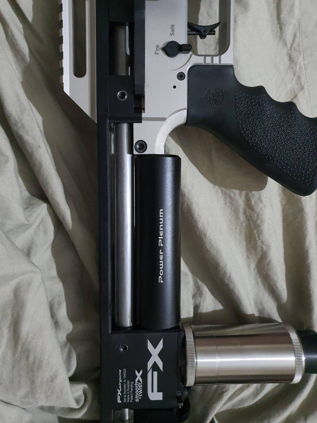

Today I happen to shoot my Impact mk2 .25 34 grain jsb pellets with LW unchoked polygonal barrel at 100 yards.
It was shooting at 940fps but group size was 2.5" CTC.
Then I picked my RAW HM1000X .25 with BSA barrel and shot the same 34 grain pellets at same 100 yards distance in same conditions of 18km winds. To my surprise all 8 shots landed in 3/4" CTC without much effort.
Then I again focused on my Impact and tried to retune it. Finally I could achieve 1.5" groups with same ammo in same conditions.
I understand that if I give more time to tune Impact, the group size may shrink further.
But at the same time I am surprised that how easy it is for me to shoot RAW HM1000X with extreme accuracy without detailed tuning.
