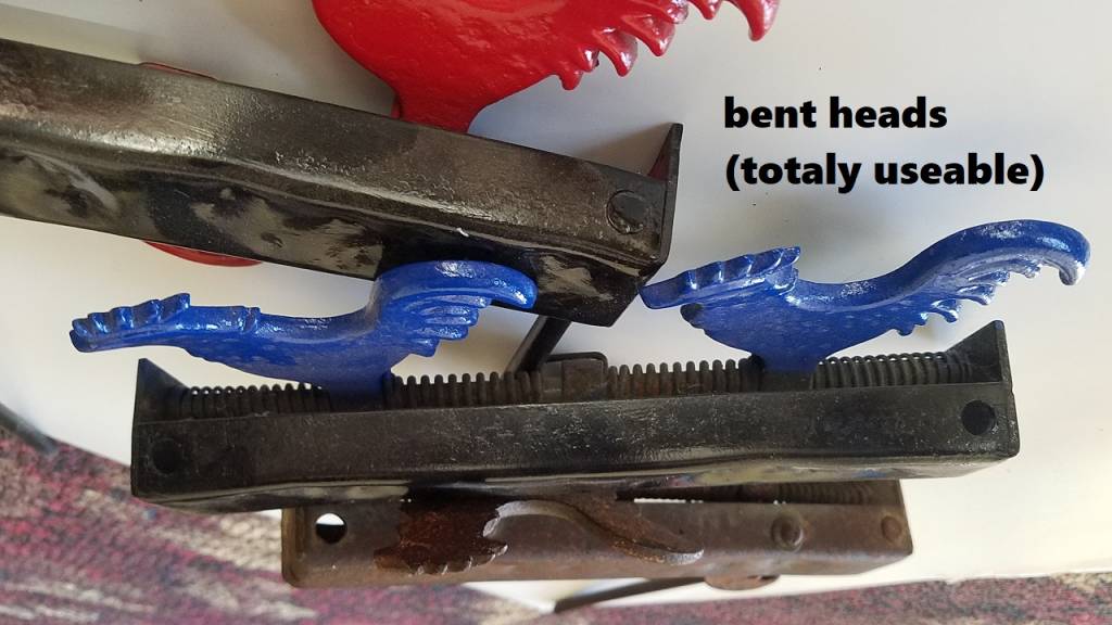

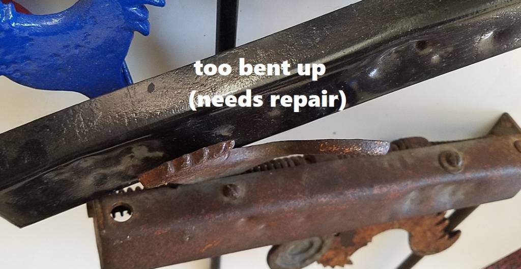

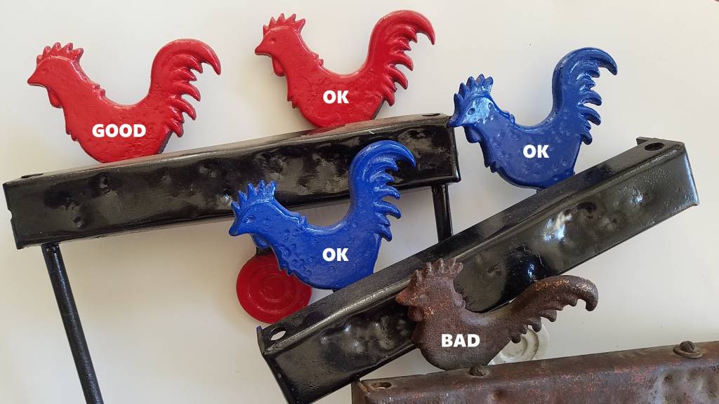

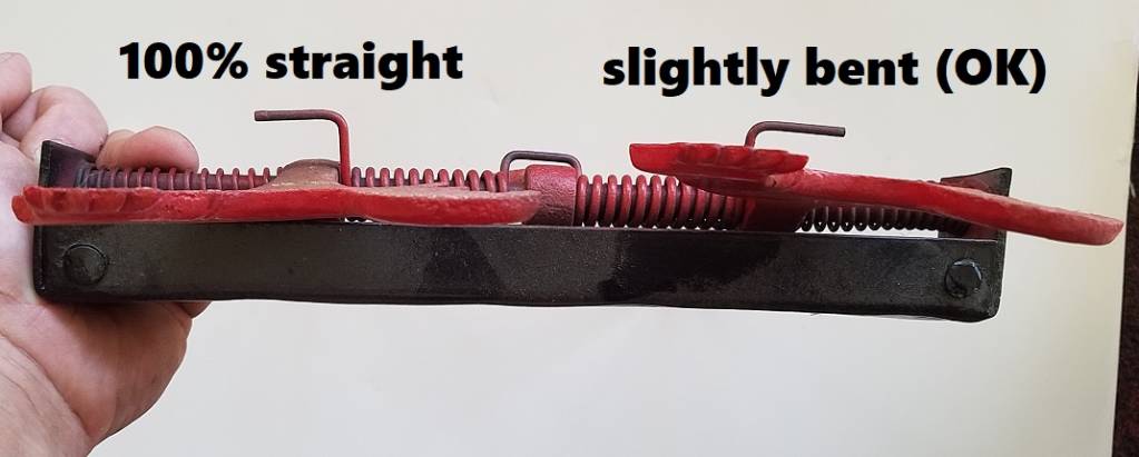

I have a bent up chicken I would love to straighten (the unpainted one). Before I hit it with a sledge hammer (he's worth about $150)...how would the proper way to straighten this cast iron be? I can heat it with a blow torch or even chuck it in the coals of my burning wood stove for a couple hours...then whack it. I have no idea. I do think maybe if I hit it at room temperature it may break in half or crack before it straightened.
Anyone know how to work with cast iron? Also, would it be "not strong" after I bent it back? Thanks -Nate

Thanks for the info! It must be wrought iron. It definitely was shot with PB's. I'll heat it up in my wood stove. Thanks! -Nate
