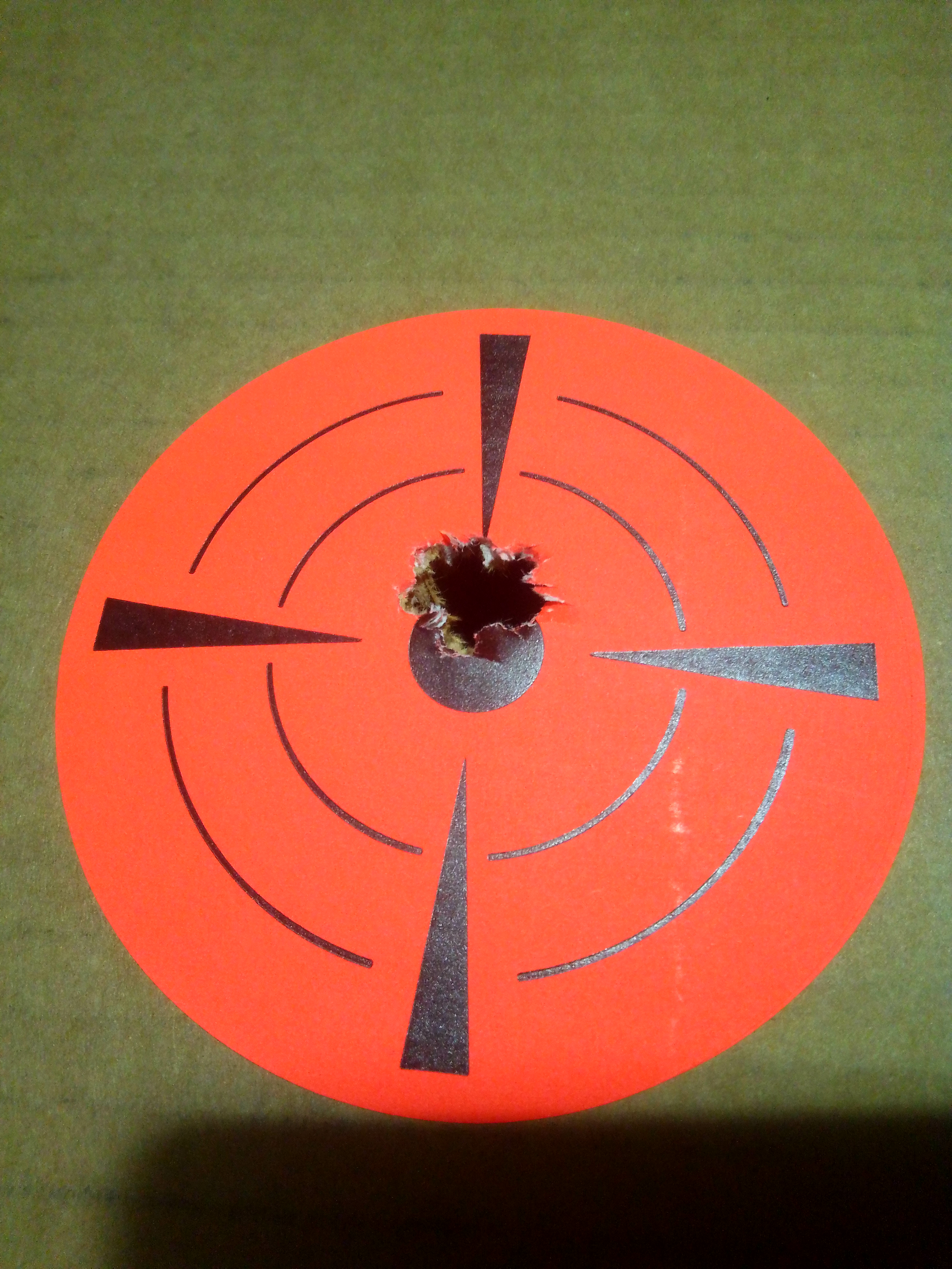

I just received my Crossman Icon in 22 caliber last week. Installed a barrel band from Buck-Rail and cleaned the barrel, installed the scope, filled with air and sighted it in and shot a half inch one hole group. It must be an anomaly or something as it's one of my most accurate rifles out to 25 yards. I bought it from Crossman during the Christmas sale for $129.00 with free shipping and free extra mag. Now the price as of last Monday is back up around $270.00. Check out the first group I shot below. I've run 100 rounds of JTS 18 grain pellets thru it since and it's still giving me the same accuracy. It's my new favorite rifle and I am having a blast with it! Surprising results for sure.

when I got the 2250 I didn't expect alot either" but it printed tight groups.
And then the hpa versions like avs shooting 50yrds and beyond showed for a cheap gun it had an half decent barrel.
Looks like the icon Carrie's the same trait.
Just goes to show you dont need too spend a fortune to enjoy your shooting
Hopefully it puts a smile on your face for years to come 👍😁

Oh,man. It's getting more trigger time than my Avenger or Gauntlet. Weather has been lousy here so I've been couped up to long. Snows melting off so hopefully this weekend will bring out the sun and the gun, lol. Happy New Year!
