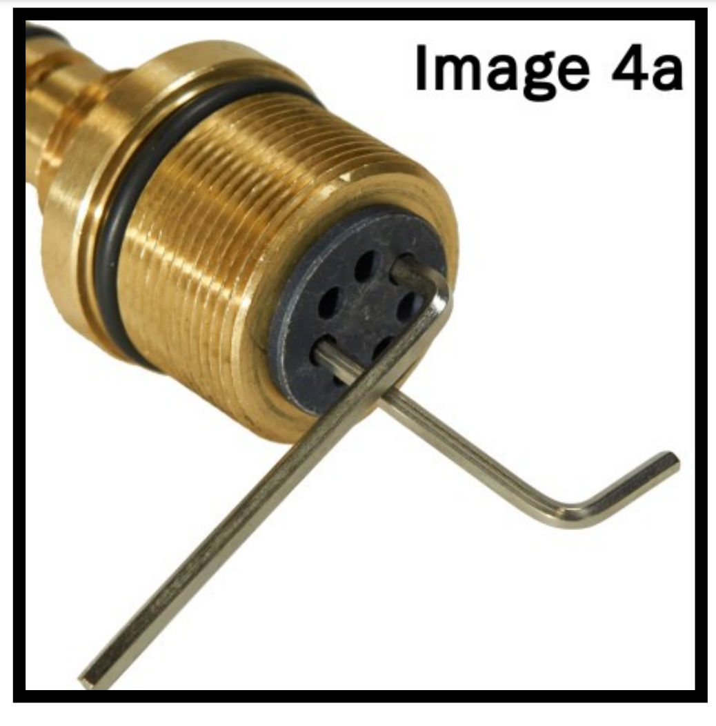

But I got enough information from this page and the Factor RC parts diagram to remove the regulator.
Using two allen keys like in that PDF worked great to remove the aluminum cap that was under the bottle connection part which screwed off by hand once the slotted lock ring was loosened. I used a brass punch to loosen the lock ring. The threaded in cap looks similar to the black part but is silver and has a brass part in the center of it. Sorry about no photos....
