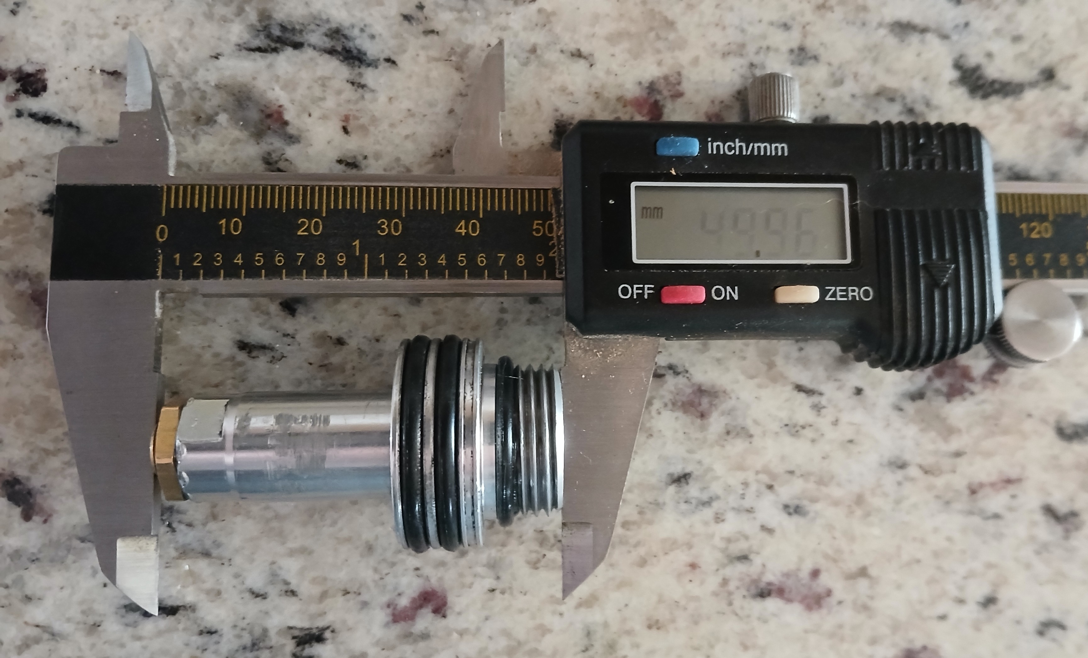

An advantage of taking the regulator out is you can more carefully control your adjustments. I've started measuring the total length of the regulator with my digital calipers. Lengths around 50.5mm seem to work. I measured the regulator of my P35-22 at 50.57 inches and then shot it down. I think it came off reg about 140 bar but it is a little unclear because the velocity started to modestly climb, not go down. I think the hammer spring might be a tad light for the regulator. It is not a terrible way to have it, however, since I was still getting very usable shots at 130 bar but it was going down at that point. The velocity peaked about 15fps faster than it had been. A full turn of the regulator screw will change it's length by 0.5mm.

The useful range for the SPA regulator appears to be from about 50.4mm to about 50.6mm. This is probably a bit wrong due to manufacturing tolerance but it is a range to try. That is less than half a turn of the adjustment screw.

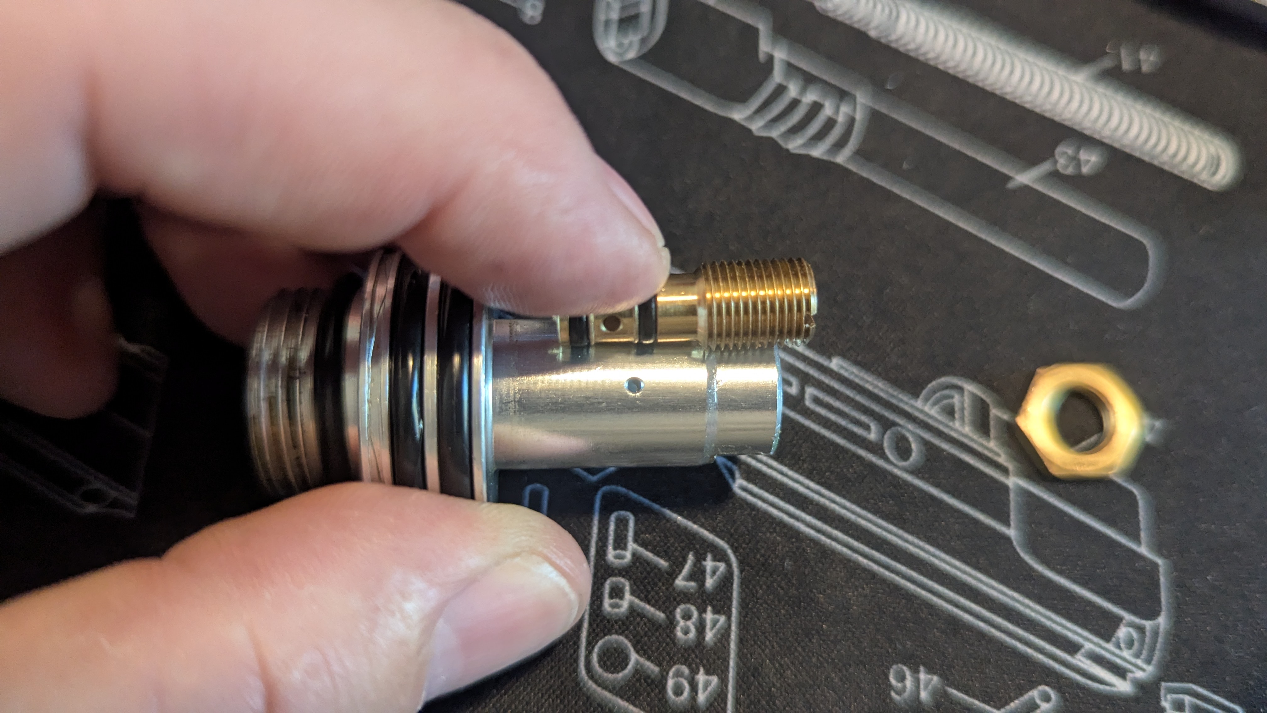

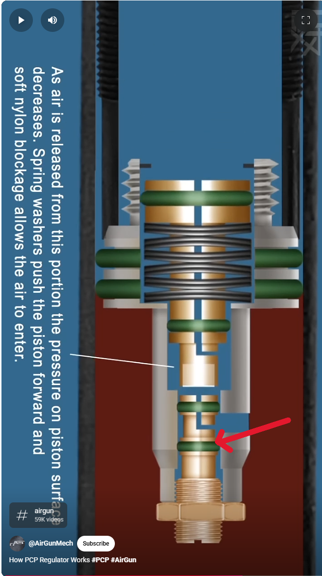

Ok got the regulator out and measured where it currently is at. 54.1mm which is after I maid the initial 1/2 turn CW through the tube. So I am assuming that I did adjust it correctly the first time. @JimD when you say the useful range is from 50.4-50.6mm, is that basically the range between the 2 o-rings? I'm trying to understand how this works. I'm assuming the outlet hole needs to stay between the 2 o-rings, and by adjusting the adjuster screw clockwise until the lower o-ring (in pic) is almost touching the outlet hole, this will get me the lowest setting for the regulator?

IF that is correct, I'm thinking I could get a more accurate measurement with the adjuster out of the housing to have a better idea as to how many turns I need to make to get the lowest setting. Or do I have this all wrong???
There is a picture of how I do the measurement in post 18 of this thread. It is not based upon a theory of how regulators work, it was just a guess initially. Then I tried it a couple times, made measurements and then shot the gun down to below the regulator setting. Experimentally instead of theoretically determined, in other words. The range of lengths I suggested is based upon the length of the regulator in my P35X right now which seems to be giving me about 90 bar and the length of the regulator in my P35-22 which seems to be about as high as the hammer spring will open (140 or so).
What I don't know is how much variation there is between SPA regulators. I wouldn't be surprised with a 0.1mm variation. But that is purely a guess.
