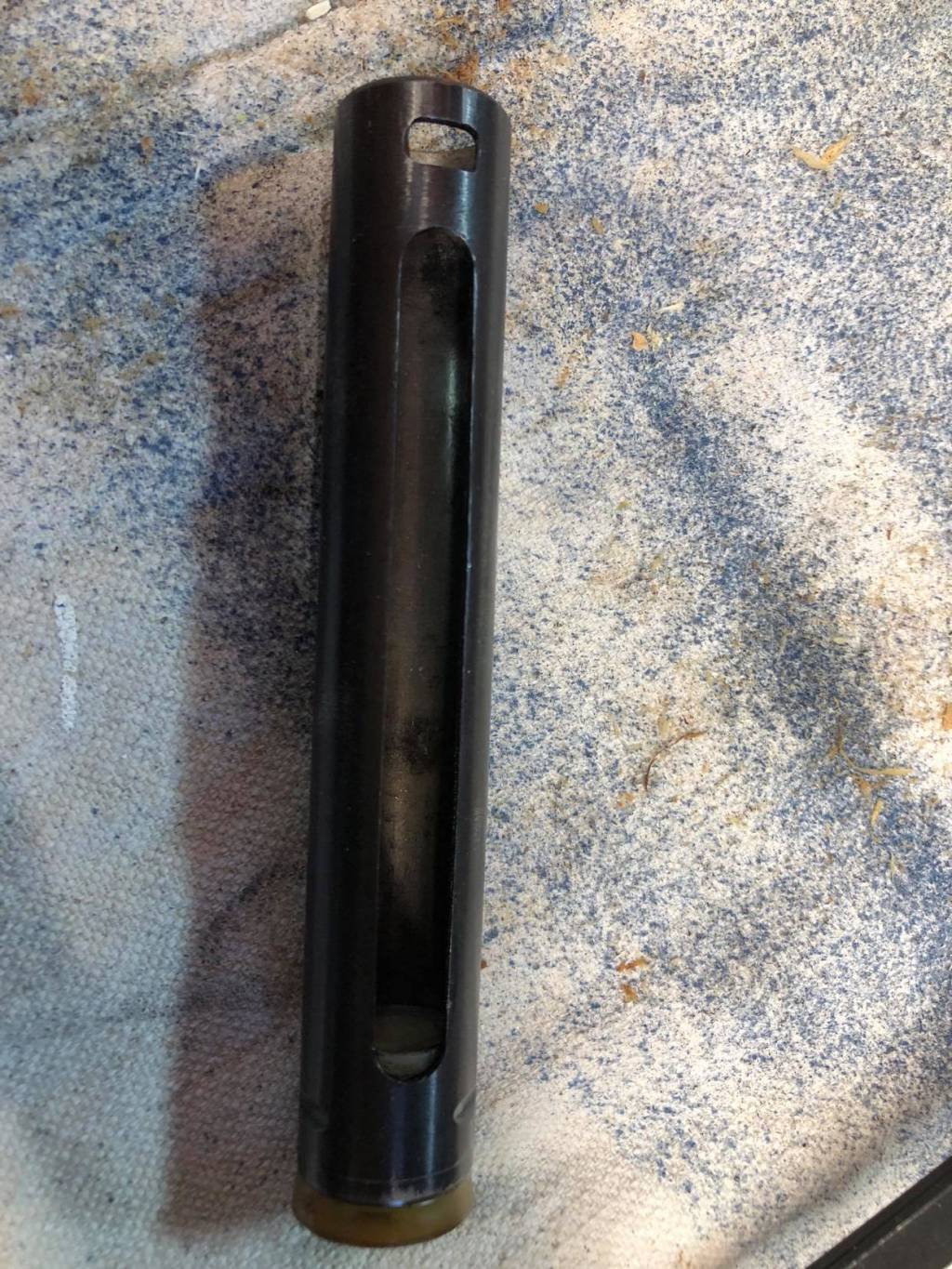

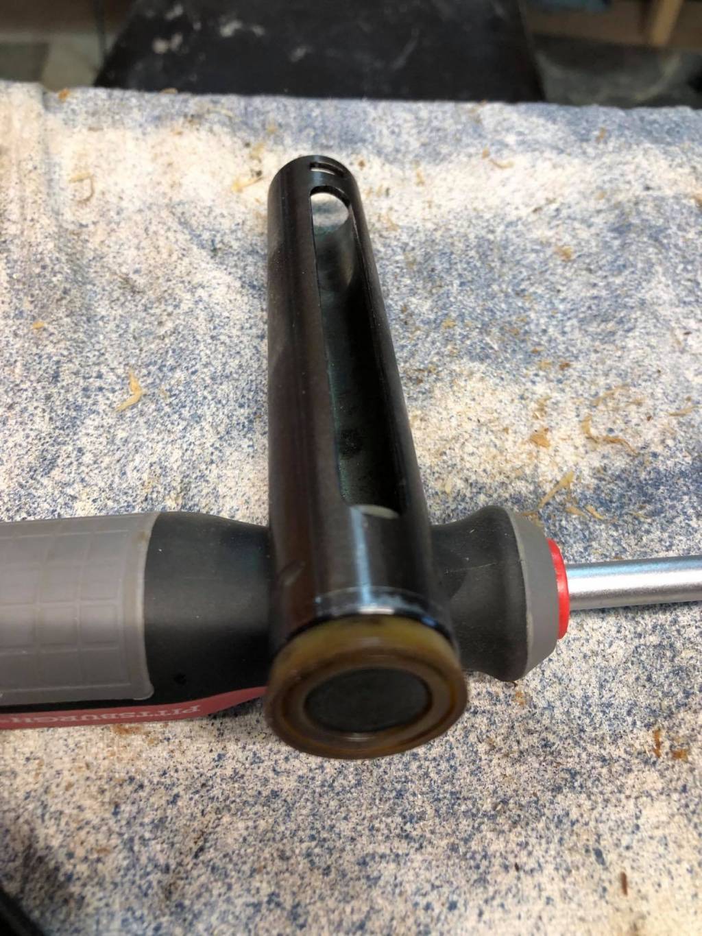

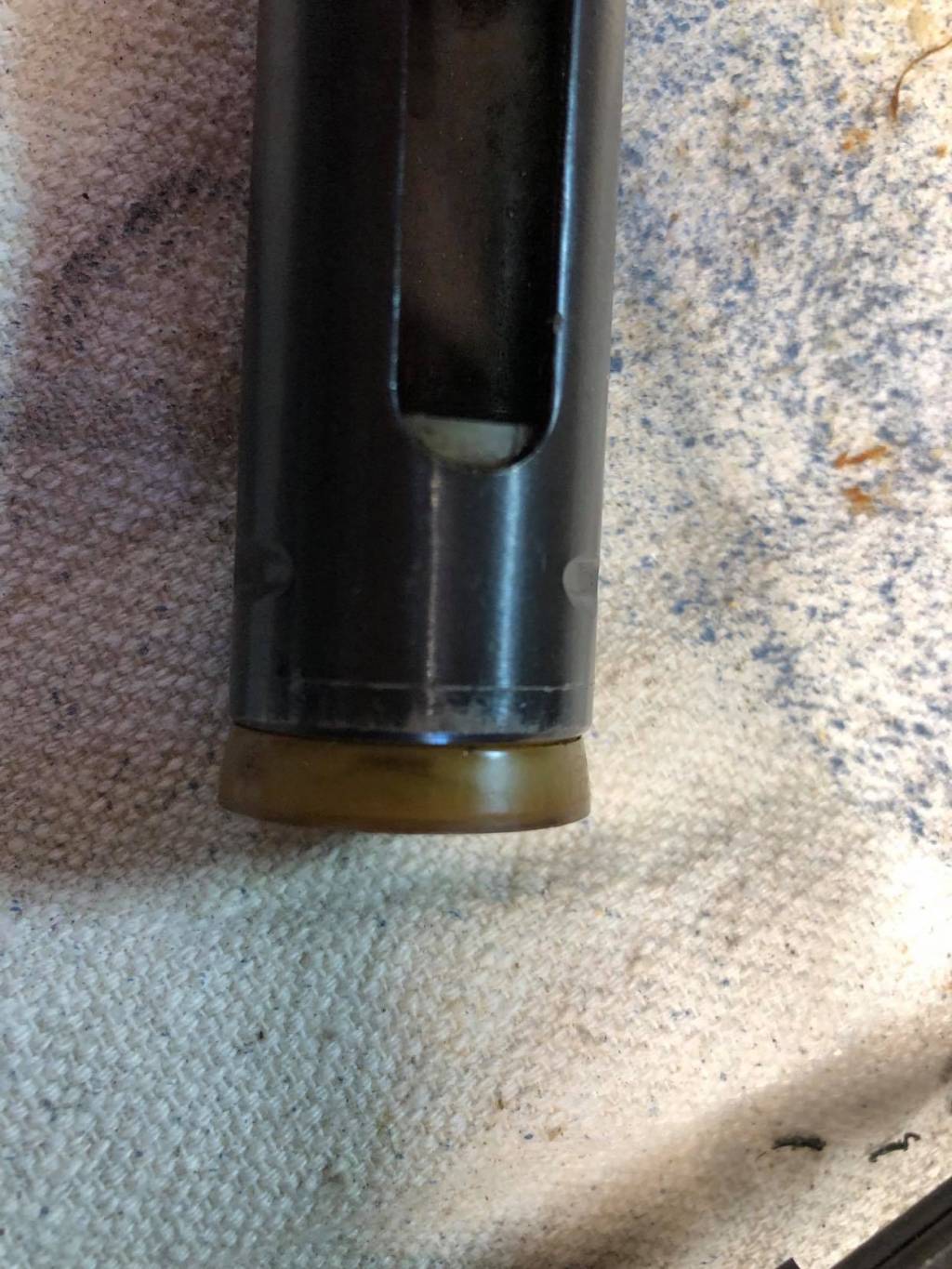

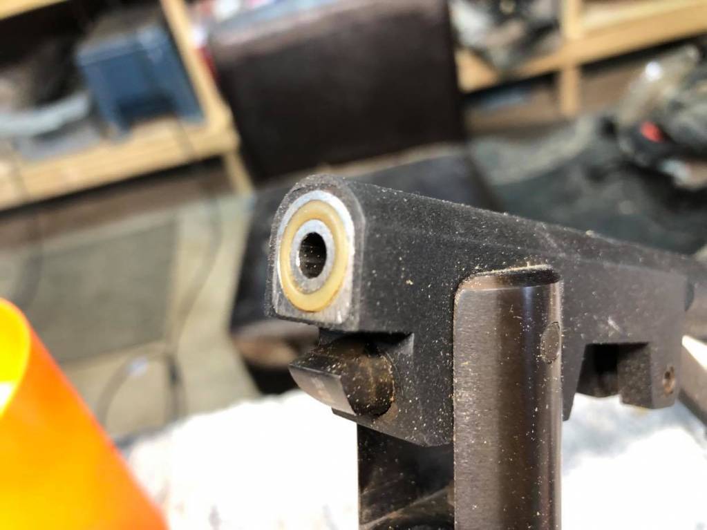

Well looks like you guys were right. I disassembled the rifle and found the piston almost fell out (not much friction) so piston gasket wasn't great, and EVERYTHING was soaked with oil. So I cleaned out everything, warmed up the gasket and reformed it slightly, added a little silicon grease (as my other grease wasn't here yet), reassembled, and viola! No more clank.
I've only fired about 6 shots through it but so far so good.
Going to order new seals and replace and re-grease it when the Moly gets here.
