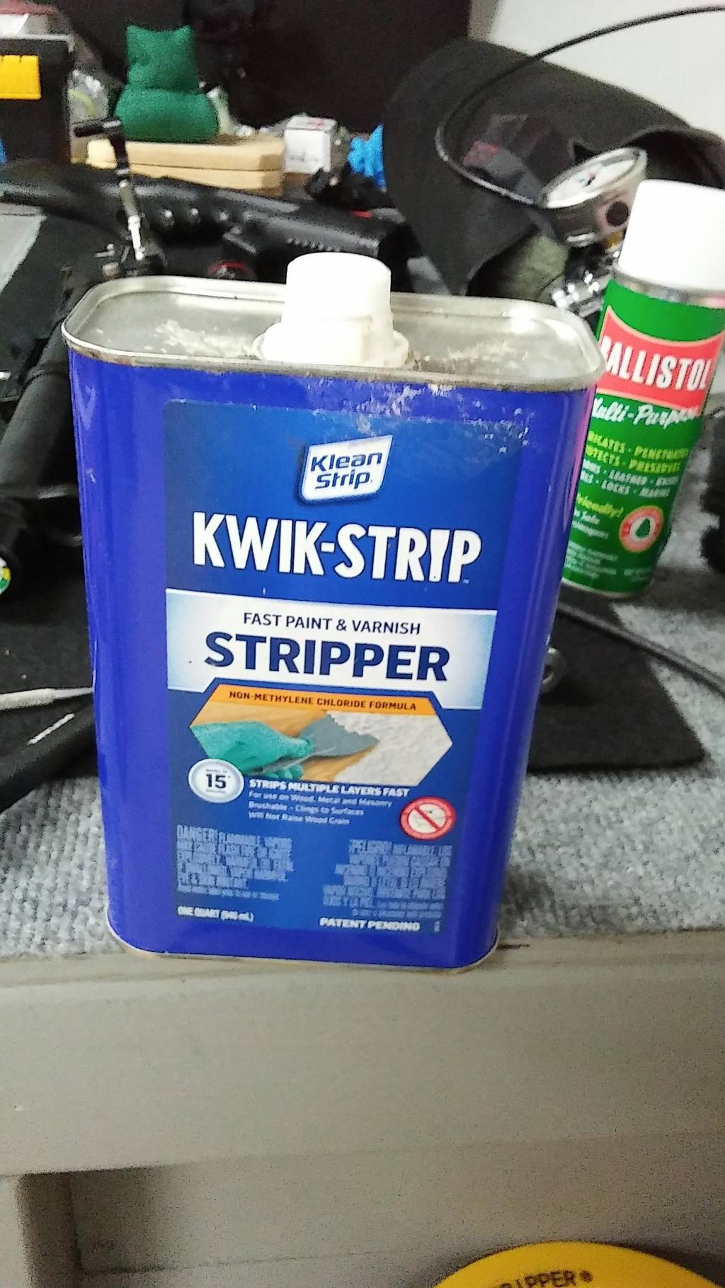

This is what I have used on a gun stock & two cabinets . The stripper I got from True Value -not sure if you have that store around your area . It works pretty fast
Put the stripper on one of those cheap Harbor Freight paint brush's around 59 to 89 cents , the ones that are made in china with like horse hair on them .

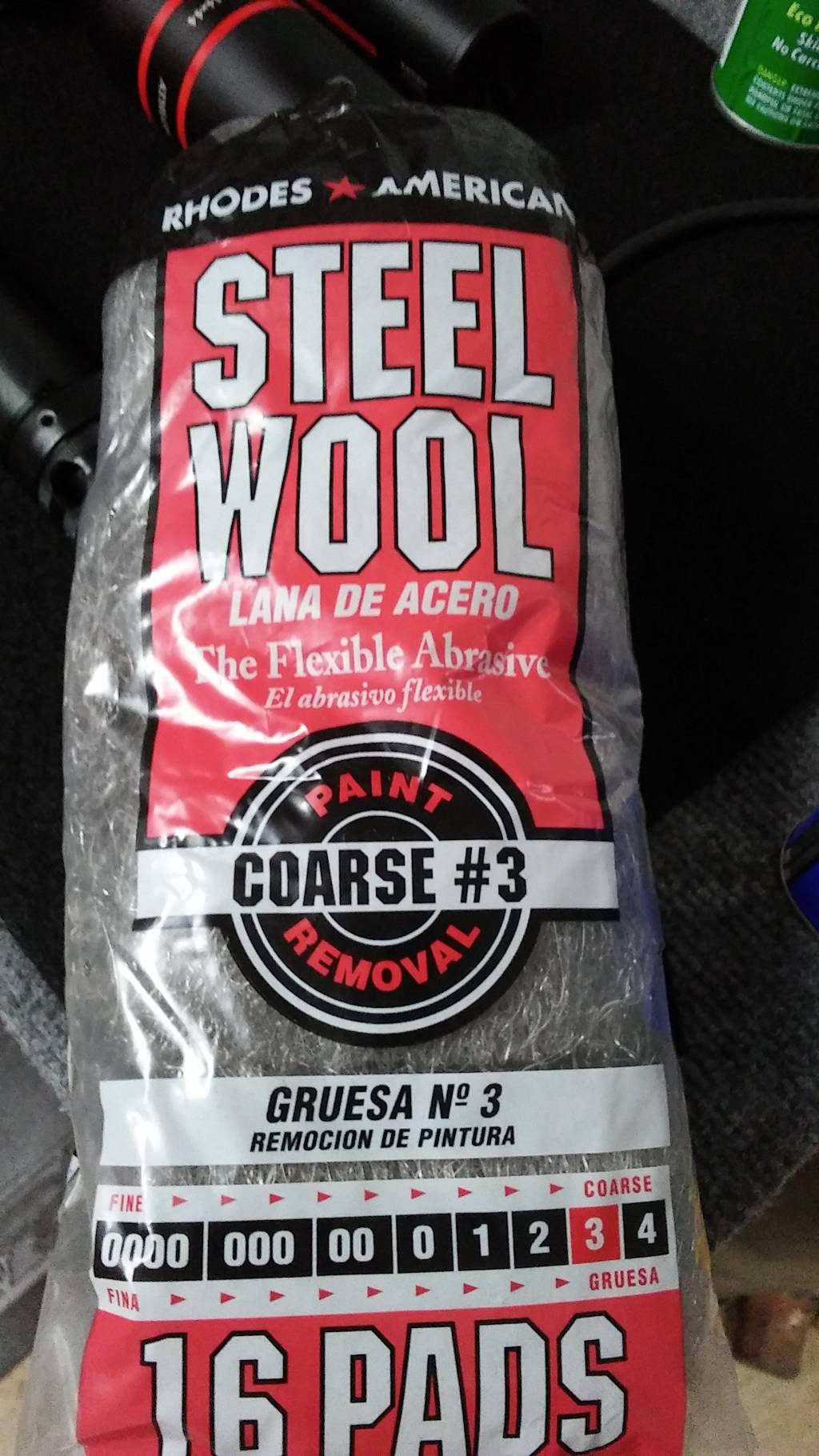

Also got the steel wool from True Value .
Depending on temp let the stripper set for 5 to 10 then take off with the coarse steel wool do not press real hard and watch so that the stripper does not start to dry.
For the checkering use a stiff plastic brush to remove the stripper
Let the stock dry for 24 hrs before sanding
If you use the fine steel wool it will just clog up so go with the course stuff Good luck Darell
