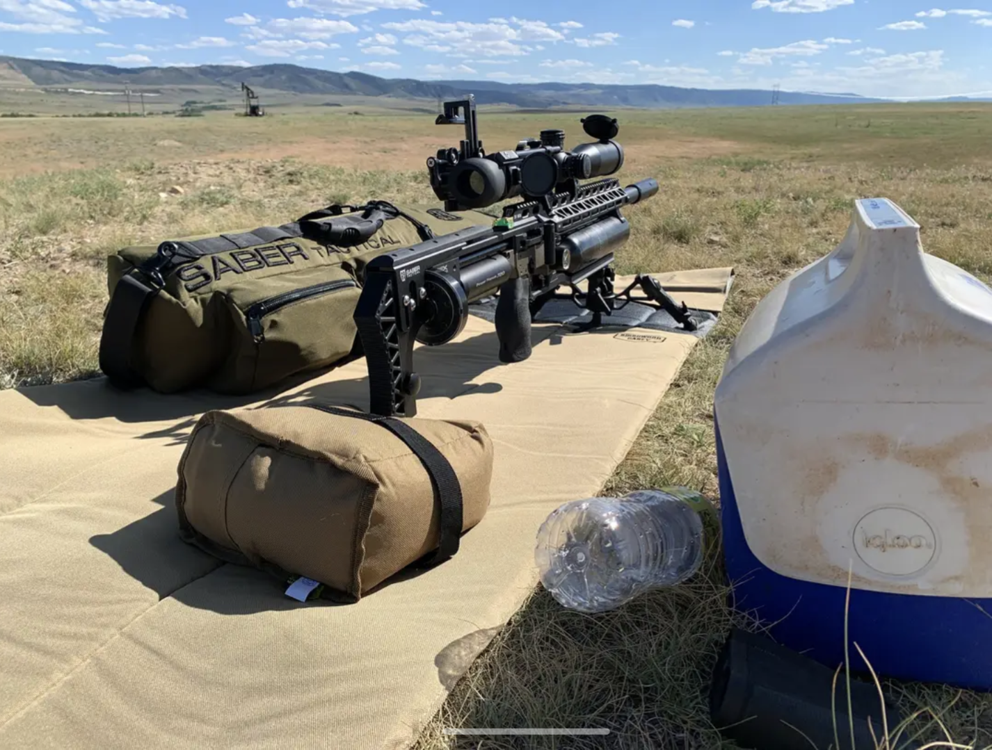

Stock M3 .25 slinging 46g at 910fps
So my 700mm .25 M3 is "stock" internally. Just had a powerblock
Right now it is pushing a 46g dishback slug at 910fps
143reg
4 on micro
16 on power wheel
Valve adjuster is at 5.5
I am impressed with this really... for a stock internal m3 rifle. But I wanna get 1040 at the peak adjustment so I can tune back down 5% and then dial into where the slug groups the best.
I have a slug kit on the shelf that has a 14.5g hammer weight in it 😳. I'm don't really wanna dive down that rabbit hole but ... I just got the Panthera and it is shooting damn good out of the box. So I might be able to deal with the time it potentially will take to get this thing dialed.
Just curious as to what my fellow AGN heavy sluggers think. And I'm not looking for a lecture from the pellet guys. Wind blows 10-25mph here constantly and my shots are 75-200y. Pellets don't hang.
And why such a heavy slug? 46g? Well I put the heavy liner in it and everything under that weight has shot like total crap. This 46g shows promise. With the standard superior it was 100y MOA with 33.5G. So cheers to never leaving a good thing be lol. The hot rodder in me follows me into every hobby 🤦
