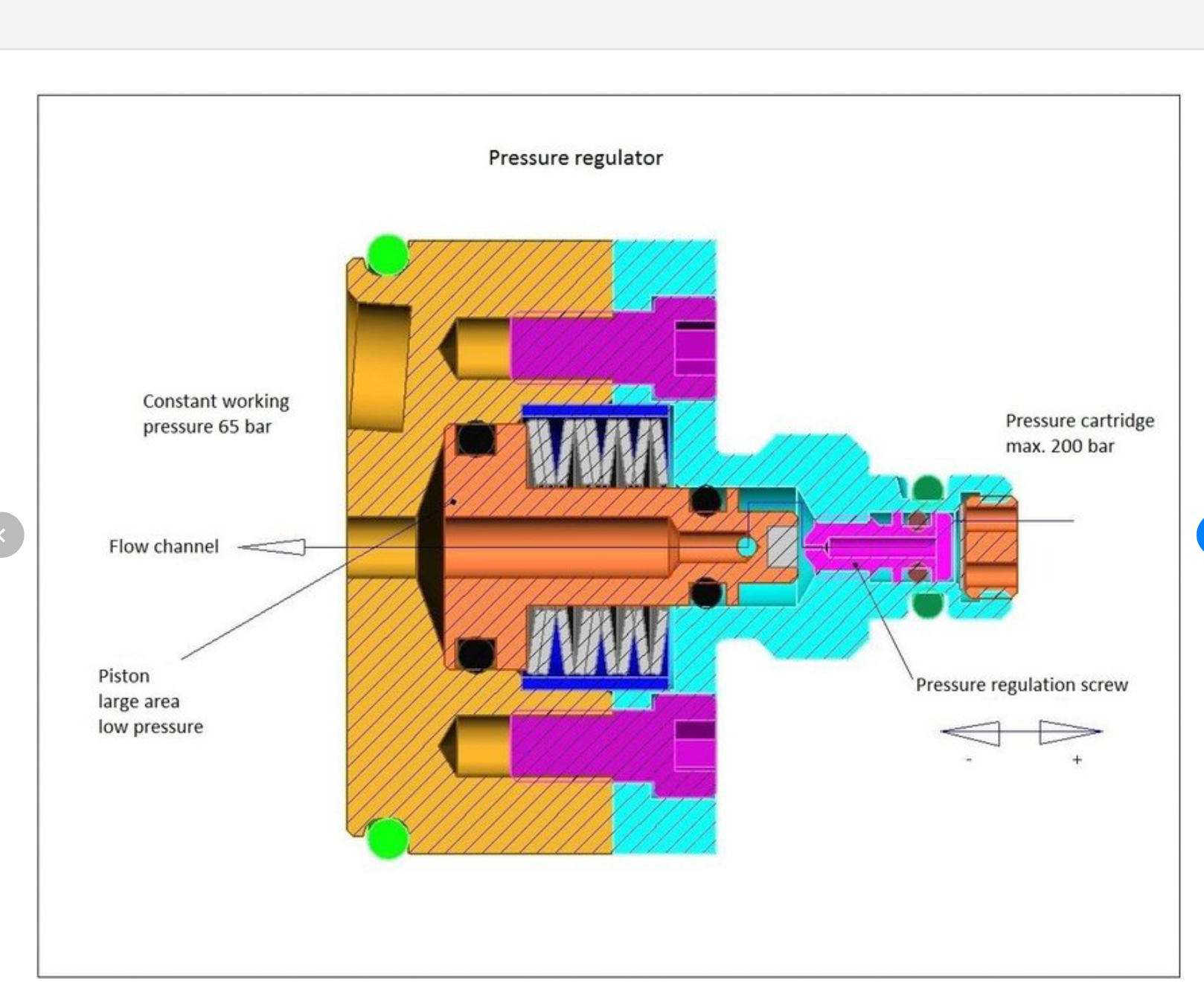

It’s a new rig so likely doesn't need cleaning. According to the gunsmith at Pilkington (where I got the gun) the regulator likely needs to be bumped up a bit. It’s supposed to produce 29.5 ftlbs and the gun won’t cycle semiauto once I hit about 25-26 ftlbs. I can get the additional power but the magazine won’t cycle in a semiauto mode because I have to screw the hammer spring in too much and evidently when the valve stays open too long it affects the cycling. Or something.
So I’m going to loosen up the hammer spring a bit and incrementally unscrew the pressure regulation screw and see if I can sneak up to about 28.5-29 ftlbs. Shouldn’t need to disassemble the regulator. Or at least that’s the plan.

Rod,
Yes you are correct, but keep in mind, the diagram that you show, at 65 Bar is for a 10 meter air pistol or rifle. My 12 ft.lb Steyr needs 85 bar to operate at that power level, and the guys that use sub 20 ft.lb guns, their regs are set to around 110 Bar or so for the output.

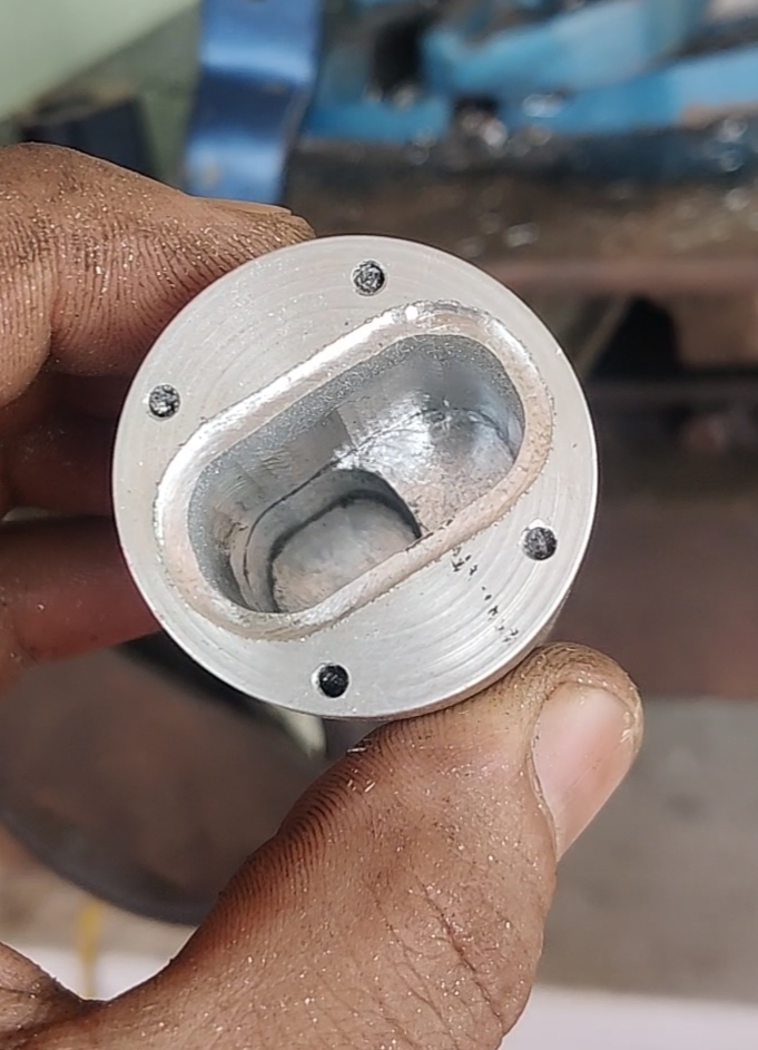

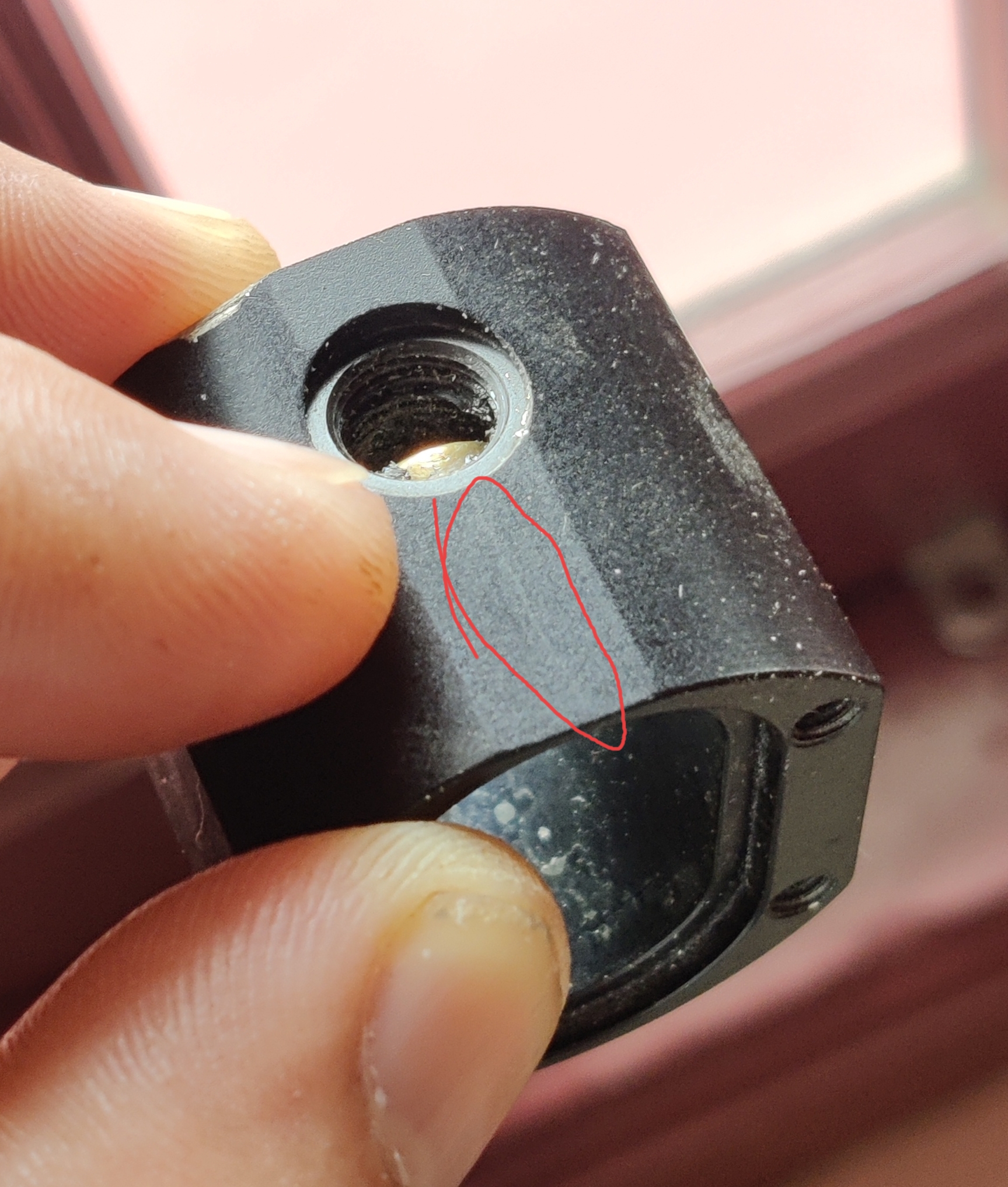

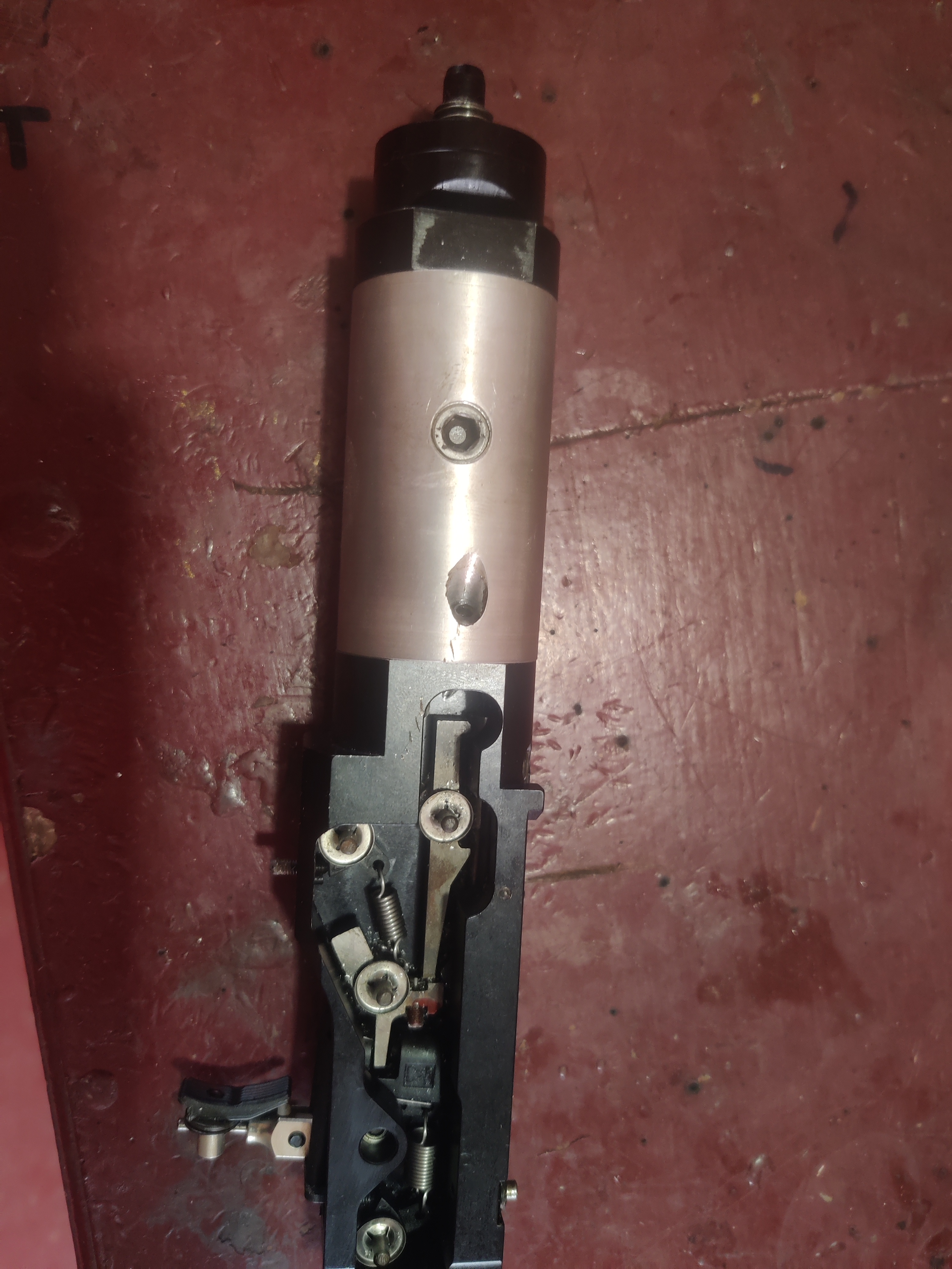

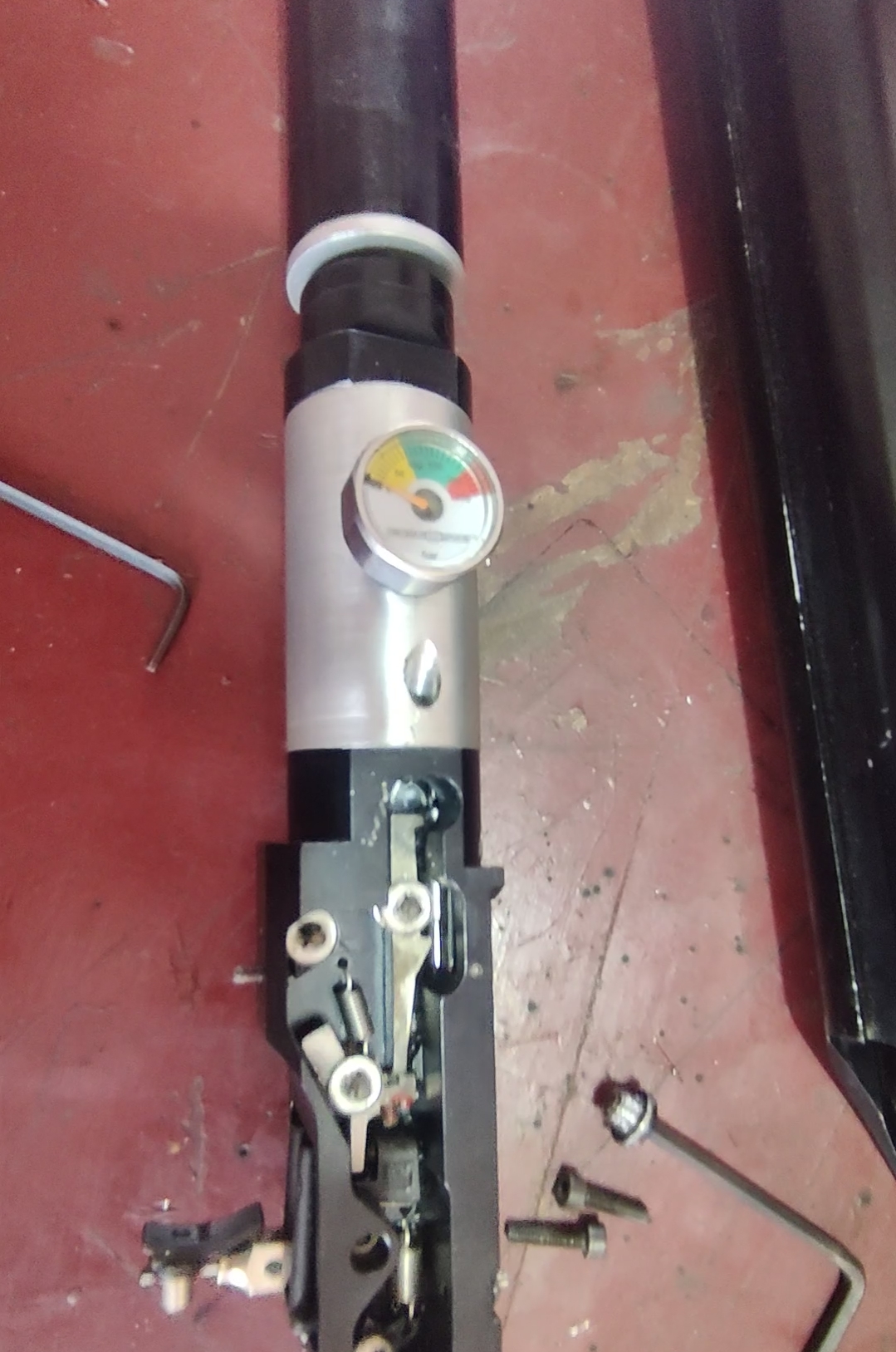

Actually the original intention was different to start with, due to this crack line formation. This model Steyr may not be suitable for reg pressure pushing higher; plenum wall are actually thin CNC cut out. Any way I made the wall thicker, longer so more air space plenum (slightly larger plenum then original now) on this grafted 7000g aluminium part, along the way just tap a 1/8bsp and seal plug because enough material was there (i didn't face mill the side of the cylinder like original one but left round as it is). In future I can install a reg guage dial also by just boring the gun chassis the size of Guage OD
