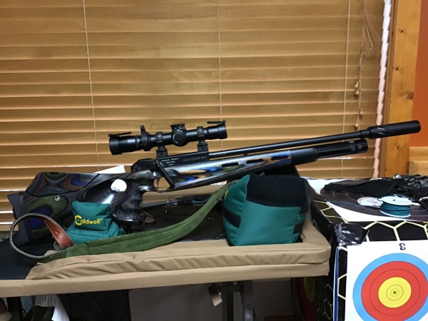

The March 1-8x24 FFP scope arrived today. This scope was about 5 times as much as I've ever paid for a scope before. So I'm either committed or need to be committed...don't ask my wife for her opinion.

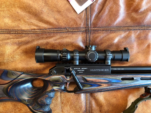

I tried a variety of 30MM rings and bases until I found the combination that put the scope the lowest I could and still get a perfect sight box picture. It is higher than I like but that's what works. Then I shot 5 shots. That group was at 6 O'clock about 5" low. Too much at 12 yards for adjusting turrents. I want the scope optics as close to zero as possible. So, took the scope off and got out my Burris Z Ring Shims. I put the -10 in the bottom of the front ring and +10 on the top of the same ring. I put the Zero's in the back ring.

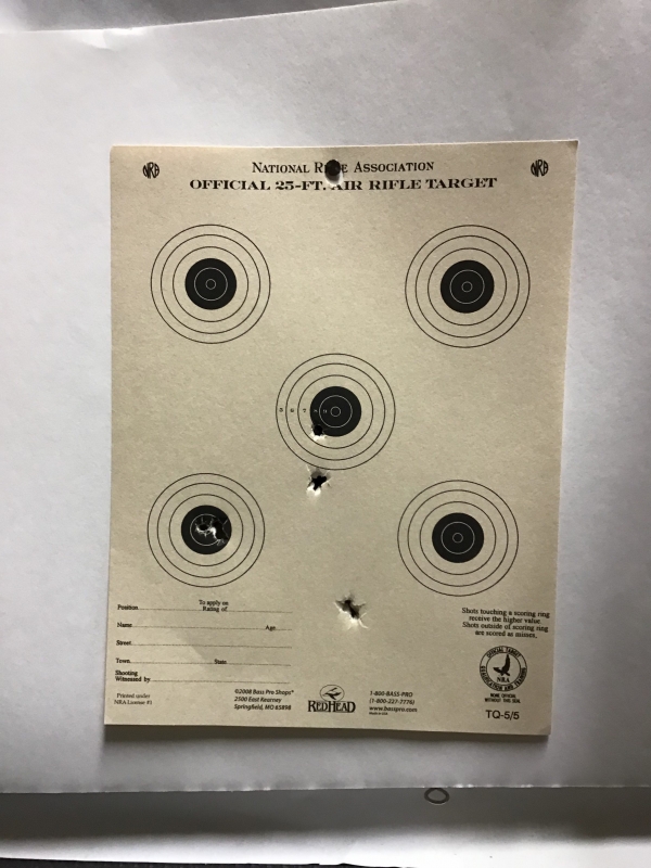

Next group was less than an inch low and a tad left. Close enough (I think?) to use the turents. First I turned the elevation up to 1 (reckon that's 10 mils?). That moved me touching bull. Then I moved up to "2" (another 10 mils?) and moved the current windage right to "1". The last 5-shot group is the lower left bull. That's good enough for now. I can take it to the squirrel woods in the AM! I know I have to do some figuring at 20 and 30 yards before I'm really good to go.
