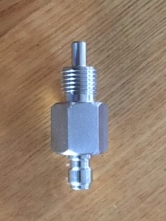

I bought an LP5p steyr ap which is on its way to me. I’m thinking of getting a hill mk5 pump for now and need to know how to connect the pump to the cylinder. It comes with a 200 din adapter (whatever that is).
I’d like to set it up with quick disconnect fitting on the adapter so in the future I can also connect it to a compressor.

gun should come with the above adaptor , hopefully it will come with the adaptor already set up for a pump , also there is an adaptor that will quisk connect to a pump high pressure line
got it on amazon i think , was a while ago
Thank you for your replies. Tried pasting link without any luck. It just says steyr compressed air filling adapter. I think that the one Richely posted might be what I need.
