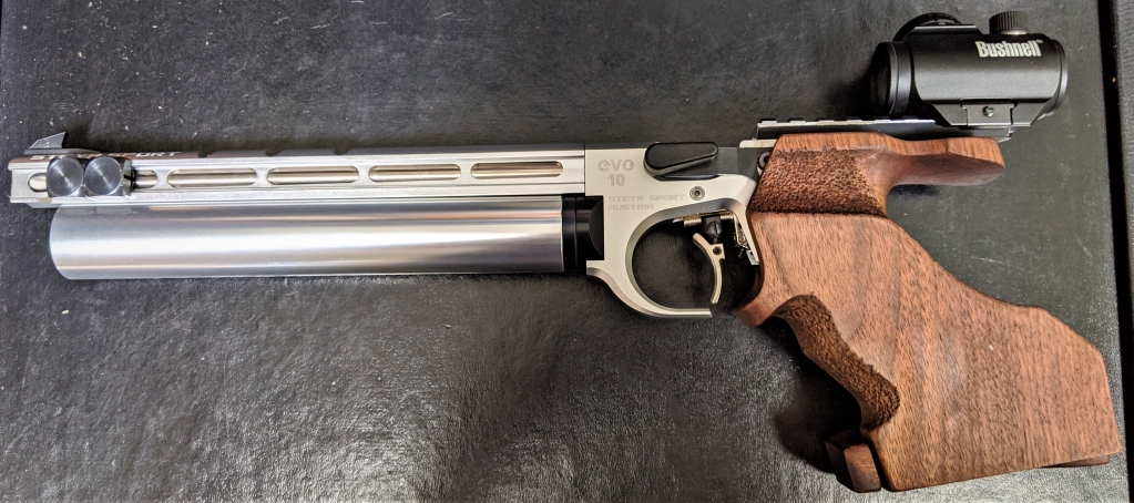

Yes, total bummer that Krale no longer sells Steyr to the US. Good call on the bullseyeforum, I have seen used LP50's for sale there also. I was just about to buy an EVO 10 from Krale when they changed policy. Luckily I was recently able to pick up a used/like new EVO 10 off TT for a great price!

My new EVO 10!
