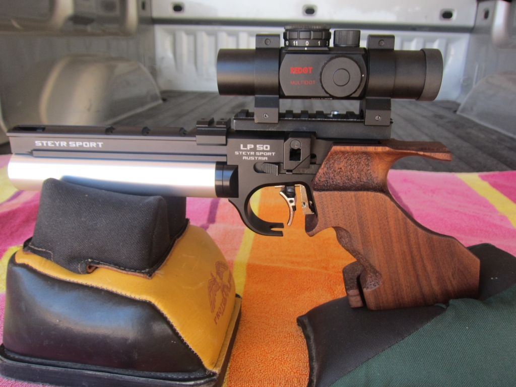

I've tried the wad cutters at point blank range on dead squirrels and the pellet doesn't penetrate the hide but the pellet is significantly dented. It will however penetrate the top of the skull at point blank range and I assume it will at distance. I have found that the wad cutters will bury themselves into a 2x4 at 20 yards so I'm hoping that something pointy will do the trick. I do have a LP10 and all of the pellets I mentioned easily fit into that, but it's open sights and set for 10m competition so I'm reluctant to mess around with it. The LP10 seems to have a bit more zing than the LP50 but I don't have a chrono so I can't say for sure. Thanks for your input. - Paul

Paul, do you have the compact or full size barrel on your LP50? My full size (not HP) came from the factory shooting a 7.72 JSB match wadcutter at 524 fps, or 4.72 ft #'s. Velocity is easily increased and I believe you could get to 6 ft #'s + if you wanted with a full size. The AA or JSB 7.33 domed shoot exceptionally well from my pistol. I can walk you thru the velocity adjustments if you want. Not saying this is the best answer for pesting as a bullpup or carbine would be better, and you would be getting a new toy!

Nick, I have the LP50 compact. I went with this model because I wanted to emulate my Walther GSP that I use for Bulls Eye competition. Pilkguns will convert mine to an LP50 HP for $50. Apparently some of the latter models are easy to upgrade. Unless you know differently I believe that there is more to it than just adjusting the regulator.
