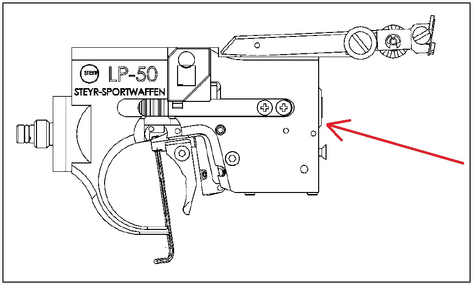

If luberiacting the internals won't make any difference, and the gun worked well when put away, it's probably one or more of the o-rings that are damaged. I would start by replacing the two o-rings on the regulator piston (ø3x1.5mm and ø8.92x1.83mm, ø9x1.8mm will also work) and the o-ring on the valve house piston (I don't remeber the size of this o-ring, but I think it is either ø4x1.5mm or ø5x1.5mm). Since this is an LP5 I guess there is an o-ring on the valve house piston, but somewhere along the way towards the LP50, this o-ring was replaced with a teflon split ring, probably to make the gun less sensitive to wear and lubrication). Also be aware of the screw for housing, that is not supposed to be flush with the housing, but rather to be turned 1 turn out from flush. Se picture below. If this screw is turn to far in, the gun won't cycle.

Yes, these two screws are the set screws that are located on top in front of the housing. They are used to fix the barrel to the housing, and you can adjust the gap between the barrel and the magazine by turning them. First you put the magazine all the way into the slot, then tighten the rear screw a bit. Then you will experience the magazine will not index or move at all. Then you tighten the front screw until the magazine moves freely. But by OPs description, this is not the problem as the magazine seems to be moving freely, but will not index when the trigger is pulled. But worth a try never the less.
