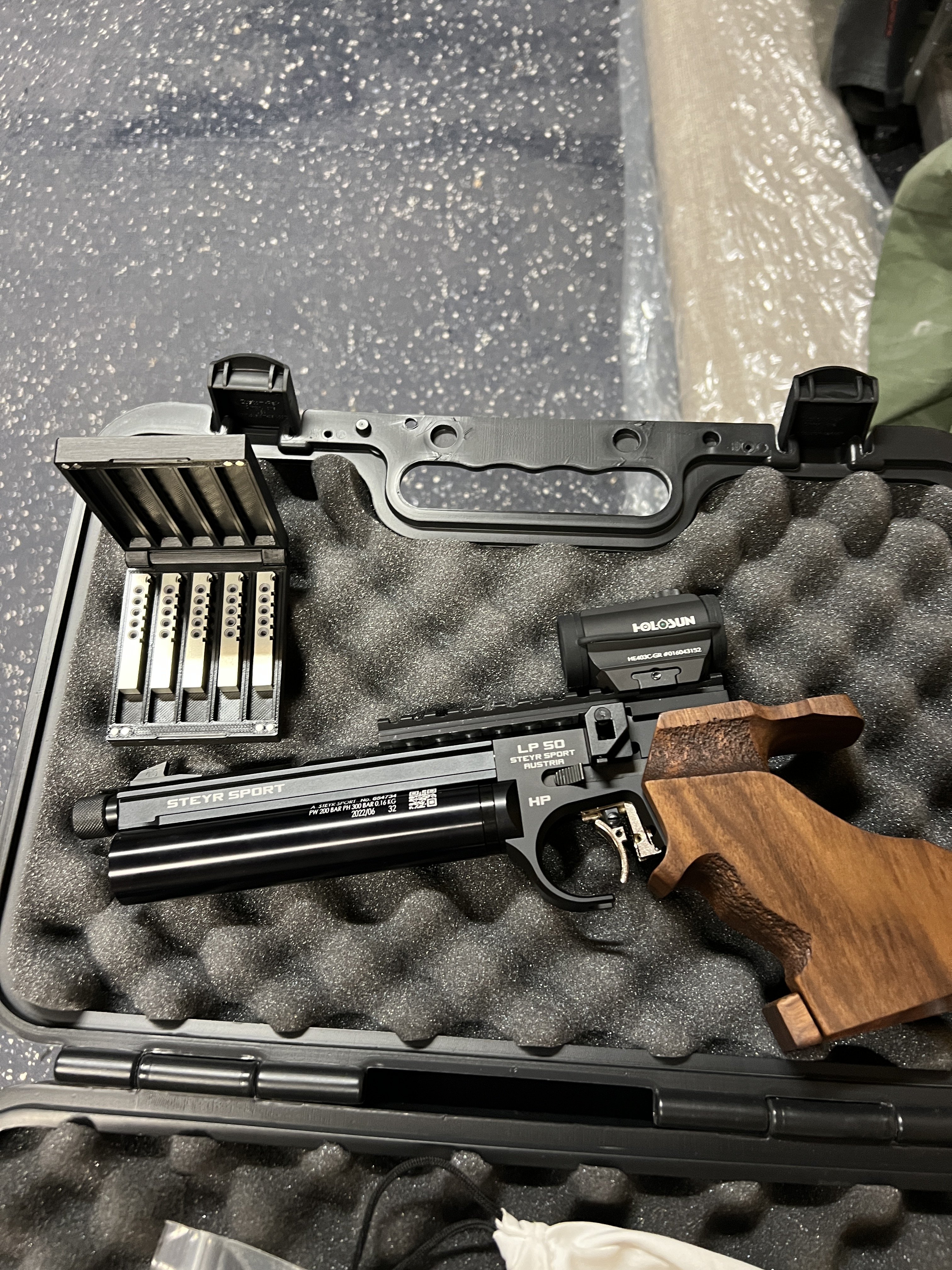

I've had a Morini 162E which is single shot Olympic pistol. Of course it was awesome! But I found myself shooting the Steyr LP5 most of the time so I eventually sold the Morini.
I'm a decent pistol shot and when shooting offhand there's no way I could shoot the difference between both pistols even though the Morini was slightly more precise. Your talking the difference between the Steyr shooting a larger one hole group vs the Morini's smaller one hole group. This is off a rest at 10M.
I just use JSB 7.9 or 8.4 gr dome pellets to stretch the distance out. Using a red dot sight it's pretty easy to hit my little 1.25" steels at 30Y when its calm out. IIRC the 8.4's are going about 450 fps. Much the same on 2.5" steels at 50Y. It's the wind that is the problem when trying to hit stuff farther out not the precision capabilty of this pistol.
The fun part is using semiauto to shoot as fast as you can to make hits! A ton more fun than single loading!!!!!!!!

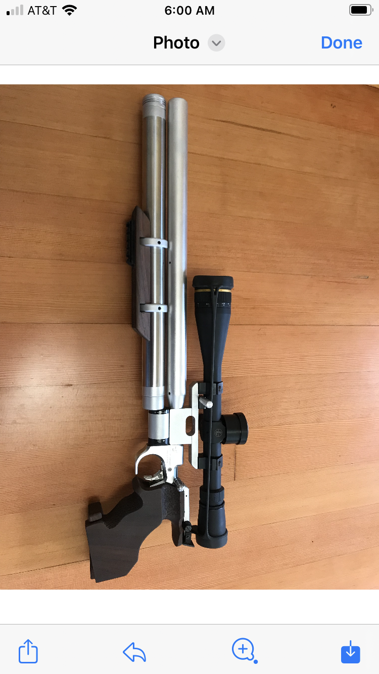

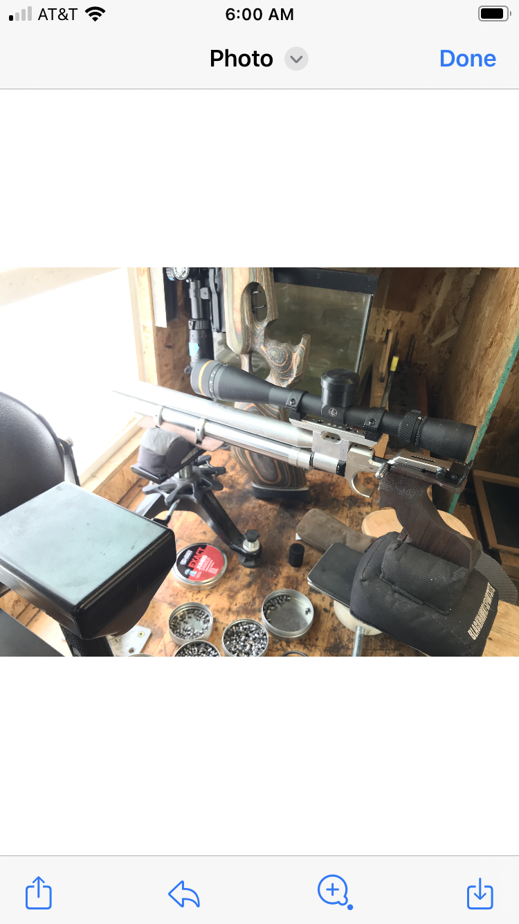

They are incredibly accurate and such a pleasure to shoot.
Allen Zasadney built this Steyr LPS for me, (on the blanket) it’s a .177 that’s shooting in the 800’s.
He has two LP50 actions right now that he is going to convert to this incredible pistol, I took one so he has one left.
They are .22 and will have the FX superior liner barrel and his shroud, along with his scope riser machined out of one piece of aluminum.
He just finished this one and sent it to a lucky customer.
He told me that he could shoot it more accurately than a rifle off of a front rest and rear bag, because there’s no cheek weld and only the trigger hand touches the gun.
I believe he said they are shooting in the mid 800’s so pretty hot for a short gun.
No idea when I’ll get mine, but I will definitely post about it.
If you want to have a dream pistol, these definitely fit the bill!

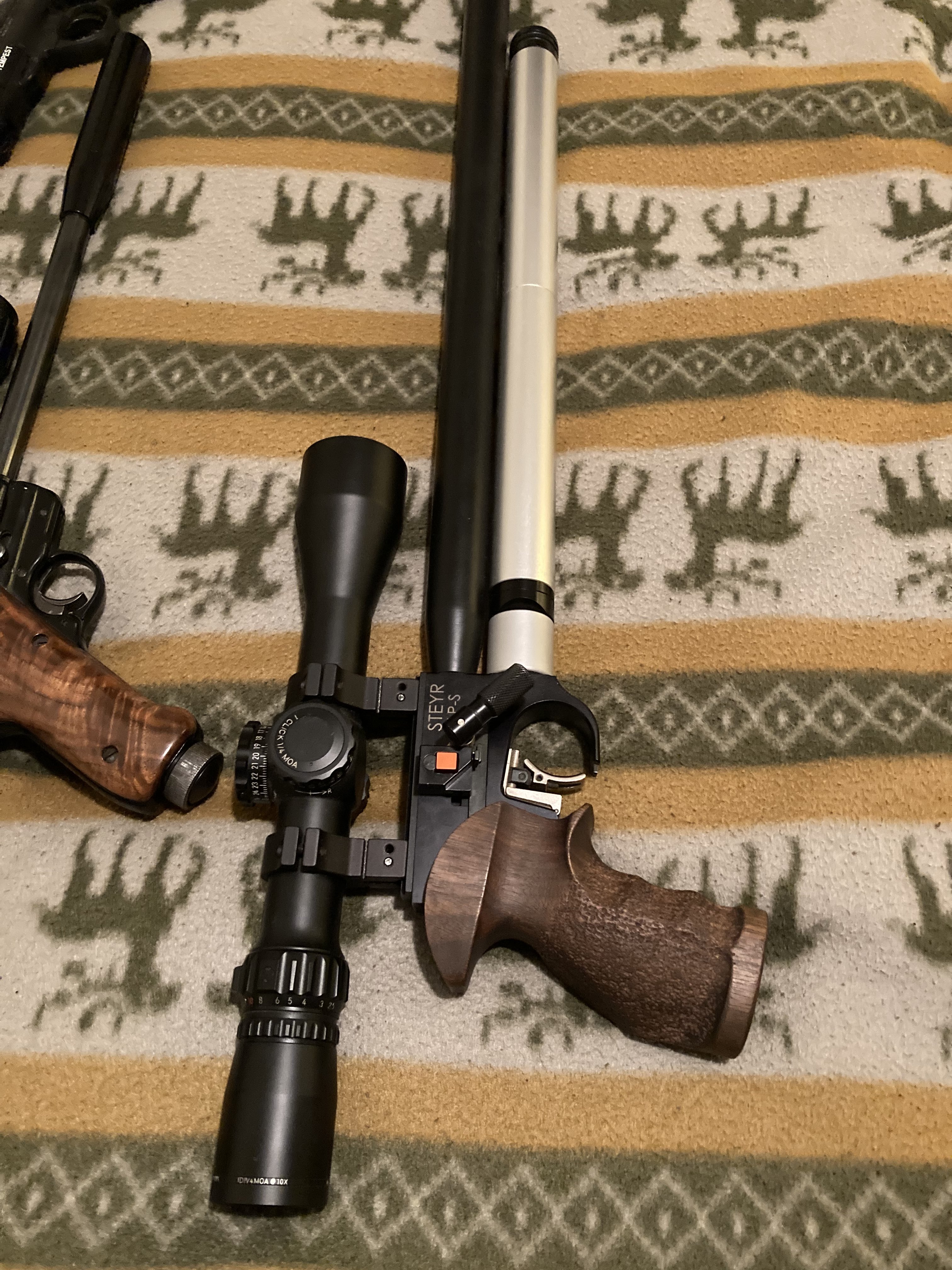

Fred, the Steyr LPS stayed .177 caliber it’s a five shot stick magazine with a biathlon cocking lever.
The Steyr LP50 is single shot.
The pistol’s are so much fun to shoot, and with the power cranked up they are pretty flat shooting and hard hitting as well.
I just spoke with Allen and mine should be done in a few weeks, I’ll be sure to post about it!
