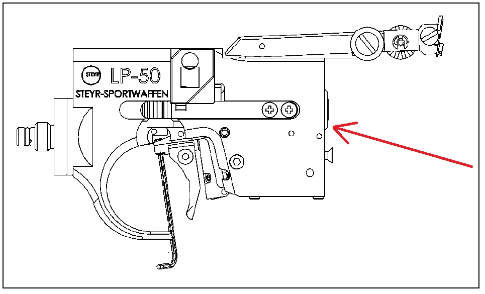

--a. The housing screw (red arrow on picture below) should be one turn out from flush, if this screw is screwed in too far the striker can't move long enough backwards for the mechanism to cycle properly.
--b. The hammer spring screw (in center of the housing screw) should be flush or up to one turn out from the housing screw. If this screw protrudes within the surface of the housing screw and the muzzle velocity is low, this is usually a sign that the hammer spring is worn.
