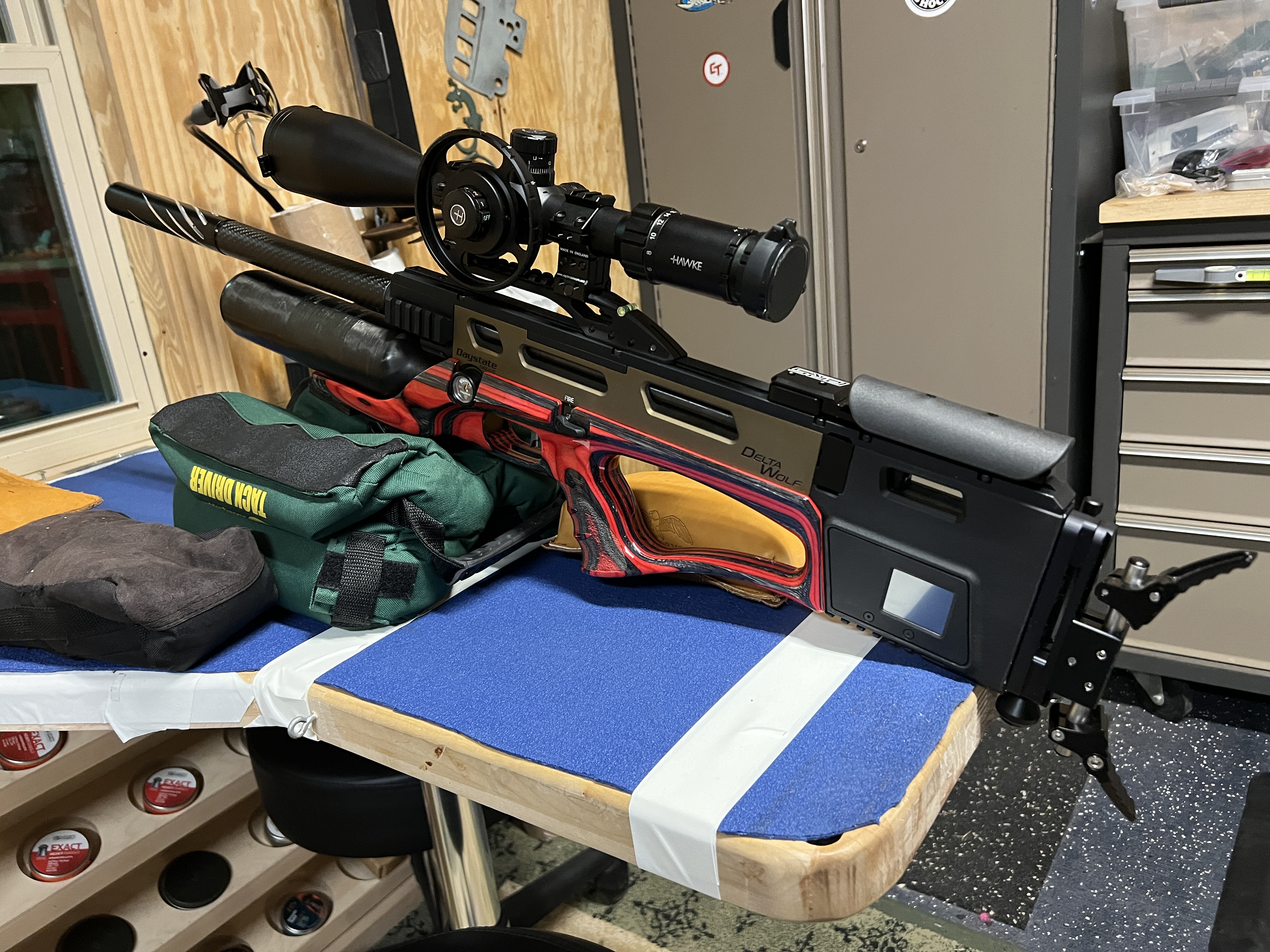

Cavedweller,
I like the Alpha Wolf picture! Does that scope rail have a built in MOA? There is a reason I ask.
Where do most folks measure scope height? I ask that question for a reason. In playing around with various ballistics programs and trying to understand how they calculate trajectory I realized what an important role scope height plays. For my FX Crown MkII with a 500 mm barrel shooting 13.4 gr pellets at 820 fps a 1/10 inch change in scope height gives a .25 MOA difference in POI at 30 yds. That is two clicks on my Falcon scope. Maybe not terrible in FT but I have been shooting a lot of AGN 30yd Challange cards and that 2mm difference could change an X into a 9.
All of the programs I looked at use "barrel angle" to set your zero. Barrel angle is the angle between the scope centerline (moved down to the center of the muzzle) and the angle of the barrel. Move the scope up and the barrel angle must increase (measure as positive if the muzzle moves towards the line of sight of the scope) in order for the projectile to hit your zero because the angle must make up for both projectile drop and scope height.
Now if you have a scope rail with one of the now common 20 MOA (or more) built-in "positive or up" barrel angle you can dial less clicks on your scope to make up for the projectile drop and scope height. But what many folks miss is that the 20 MOA barrel up angle actually decreases the scope height. That is because (IMHO) scope height needs to be measured at the muzzle! It is only after the projectile leaves the barrel that gravity begins to do its work. And if you have a 20 MOA scope rail and a 500 mm barrel I am willing to bet the "effective scope height" has decreased by about 0.1 inches. That results in the afore mentioned .25 MOA change in POI.
OK now, am I getting this wrong? Happy to discuss.

Cavedweller,

@NAProf Yes, the daystate monorail has 20 moa built in... i use on a variety of platforms (esp bull pups) because it provides me with a better cheek weld / comfy neck position. And Provided my memory doesn't lag to far behind my mouth, somewhere in my sorted past i asked the exact question about MOA to Igor the inventor of Strelock Pro, and he told it was of no significance for the distances we shoot FT. Igor can be found on his Facebook strelock pro group.
