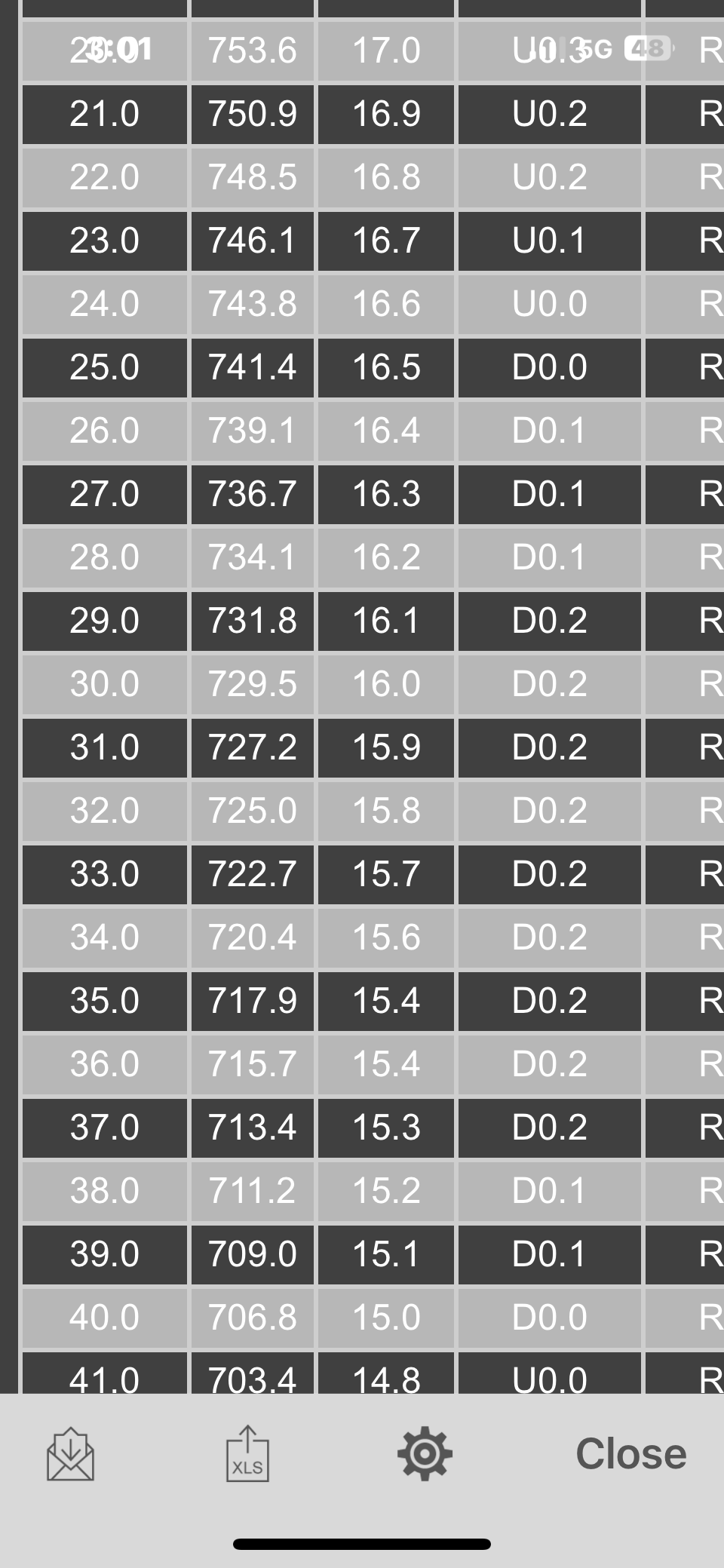

I shoot to measure scope height instead of trying to measure with a ruler/caliper on some scopes. Target about a foot in front of the rifle and then measure the distance between aim point and impact. This is your scope height. This allows for the MOA you mentioned in the rail. Can be very hard to do this because you can’t really focus that close (so I haven’t been able to do this will all scopes). Have to cover scope and put a pin small hole to see through (Google it).
Either way you can figure out the exact scope height that works for your ballistic app and your parameters by continuing to shoot. Found that out here. Whether you start by ruler, calipers, or shooting, the apps (Strelok for example) will allow you to update your scope height to a more accurate setting after you see how your actual impacts relate to what the app says or should be.
It has been a while since I’ve updated mine (over a year), but it works something like this… (you can search to find this too. Seems like I remember CCut or someone sharing this a few years ago.)
Enter your info (scope height, pellet, speed, etc) into the app closest you can get it. Zero your rifle at your 25, 30 , or whatever yards you want for your zero. Shoot at a closer range, like 10 yards and see how far off you are from what the app tells you. Adjust your scope height in the app until you find a match for the adjustment you should have at 10 yards based on your actual impact. Test and see if the rest of your scope dope works now based on the app.
