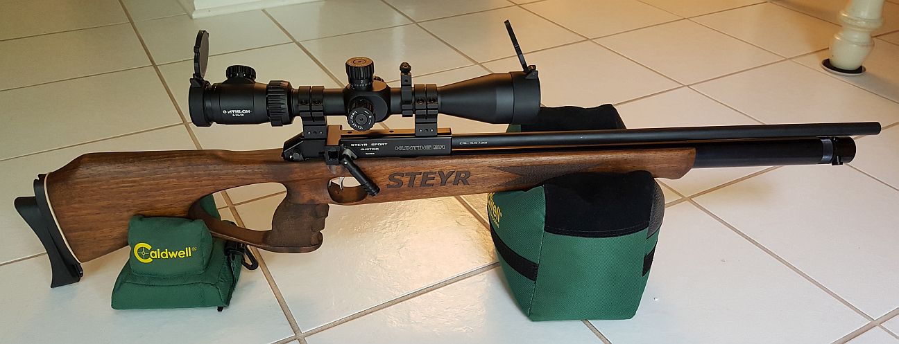

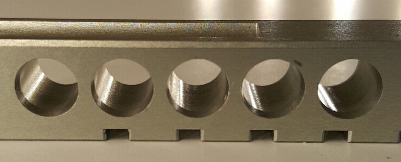

I just bought a beautiful Steyr Hunting 5 Automatic from AJ.

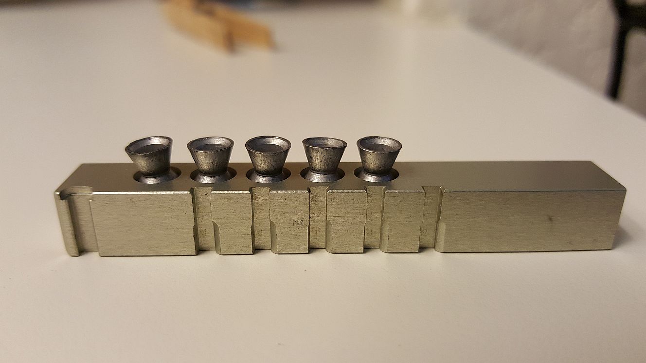

I have JSB 15.9gr pellets that measure 5.52mm in a PelletGage. I dropped them into the magazine without applying any pressure, as shown in the picture below.
Is this the normal height BEFORE applying pressure to push them into the magazine so that the skirts are flush? I don't know what amount of force I need to apply, but I'd like to hear from others before trying. I don't want to damage the only magazine I have.
(Also, I just wanted to test the new photo feature on the forum and this gave me an excuse)
That is what it looks like and it should just go in without much force and I would push them straight in with my finger tip to seat them at least a mm more than just flush so they are all seated inside and not just flush.
I wouldn't worry about damaging the magazine by seating the pellets with your finger and it shouldn't take much force to seat them if you use normal pellets. I do not recommend trying to shoot slugs through it.
Note there is an etched picture of the pellet on one side of the magazine to indicate which direction to load them. Enjoy!

Yup, thats the right way. I wouldn't worry about the soft lead damaging the magazine. I found that the 5.53 fit best in my magazines. Sometimes the smaller heads slip around in the magazine and you have to make sure the pellets don't get unseated when you try to insert the magazine. The bigger question is which pellet shoots best out of your barrel?!
Ive found that the pellets that need a little push to load them into the magazine tend to shoot better out of the H5 rather than the ones that drop in easily.. The lead is not gonna go any damage to the magazine.. Just make sure the pellets aren't ridiculously tight to the extent where the pellets get damaged on their way in or don't get flush with the magazine..

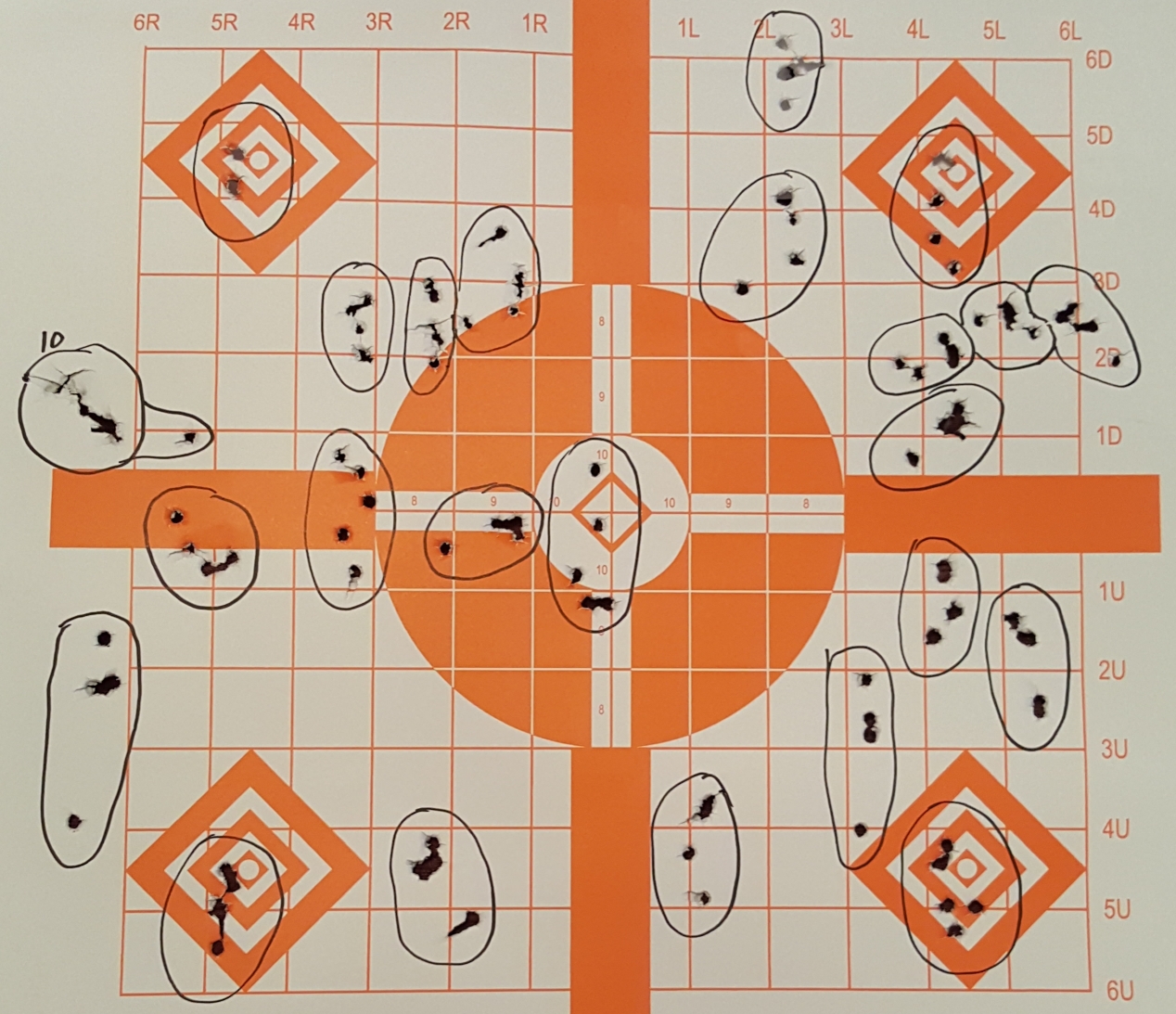

I took the gun to an indoor 100-yd range to test it out. To travel light, I only took 4 types of pellets: JSB 15.9 and 18.1, and Air Arms 15.9 and 18.1. I started off at 25 yds. Here are the results:
(1 inch squares)
Needless to say, I didn't see any point in shooting at 50 yds. I didn't know what was wrong. Maybe the gun was damaged in shipping, but I believed the gun was good. I figured it was something that I was doing wrong.

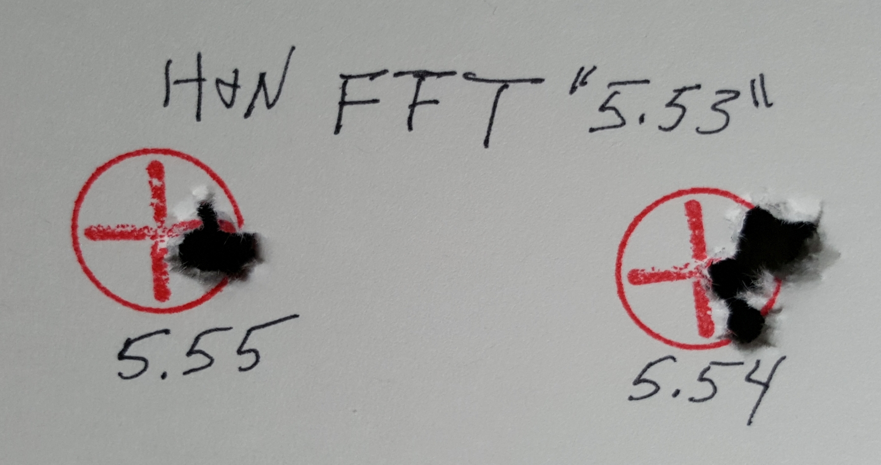

AJ suggested that I shoot Crosman and H&N pellets in it, since that is what he used with the gun, and it was very accurate. I had some H&N FTT 5.53 pellets so I sorted them using my PelletGage. The measured pellets fell mostly into two groups: 5.55mm and 5.54mm. I tested both on my 14 yd target and saw a big improvement.

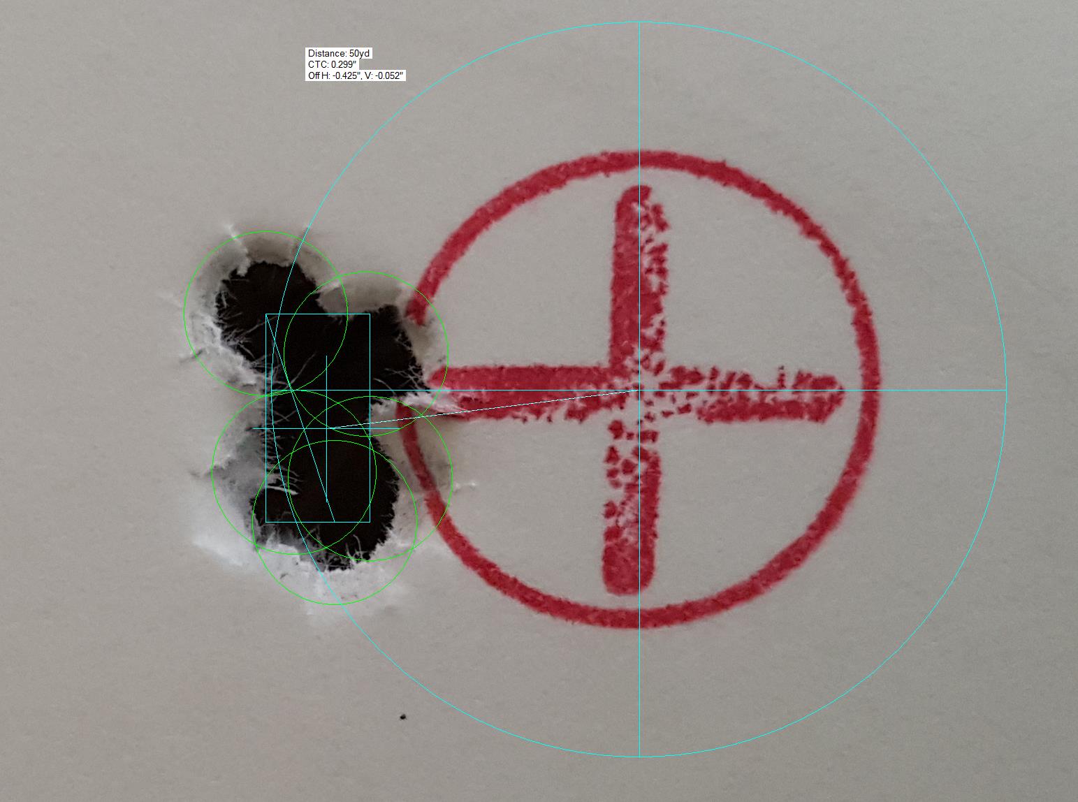

I decided to try the 50 yd range. Even with some wind, the groups were good. Here's my best group of the day, shot with the same pellets that I used the day before at the indoor range, only this time they were lubed with Napier Power Pellet Lube:
I used OnTarget TDS to add the measurement info (CTC: 0.299", etc).

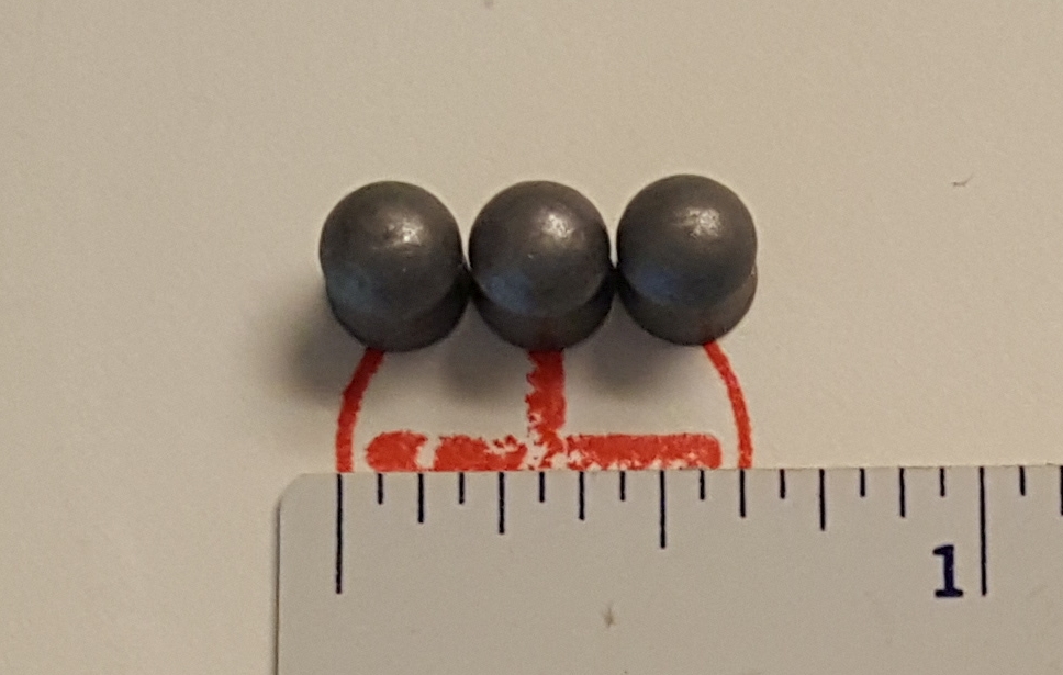

Here's a photo of the target for reference. We use a self-inking stamp from Office Depot to place multiple targets on the back of paper plates. The punched holes tear very little.
(.22 cal pellets)
