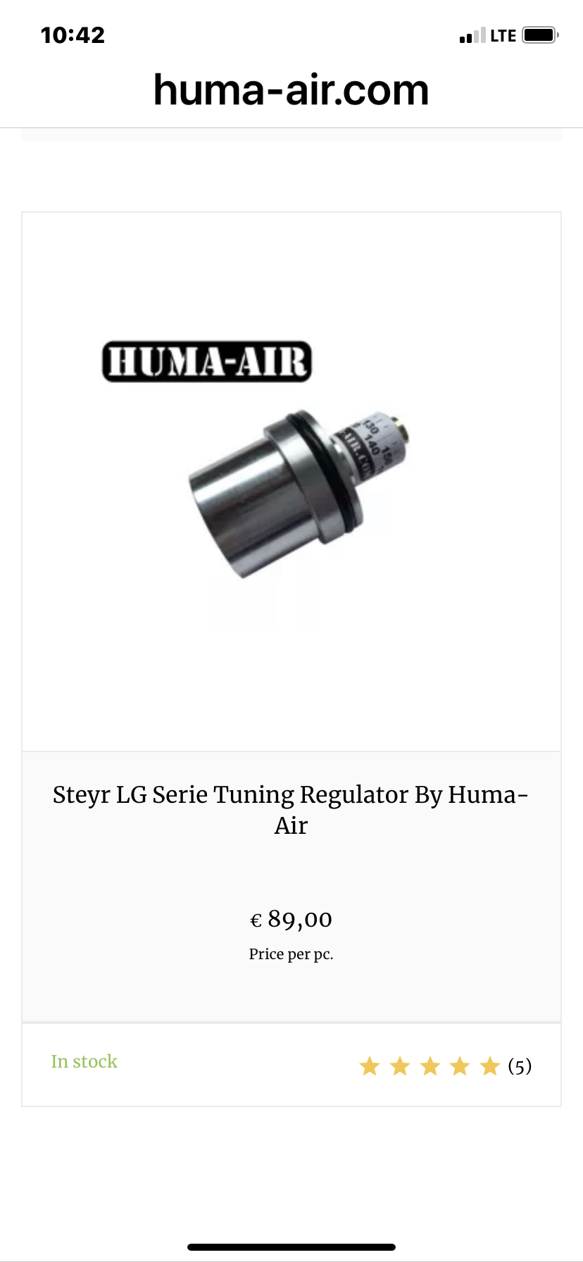

The LG110 has a Steyr regulator. As far as l know, there are no aftermarket regulators, including Huma, made for the Steyr but l could be mistaken. Don
Reactions: davit66
A Huma in this case ( In a STEYR LG rifle ) The OEM reg is put into bypass by turning seat adjuster CCW out a few turns or removing it completely.
So long as the bottle valve activator piece in reinstalled after adjusting or removing the seat all will be fine. * Tho HIGHLY recommended that the OEM reg have it's internal o-rings serviced ( SPOOL ) as it could lead to a leak down the road.
