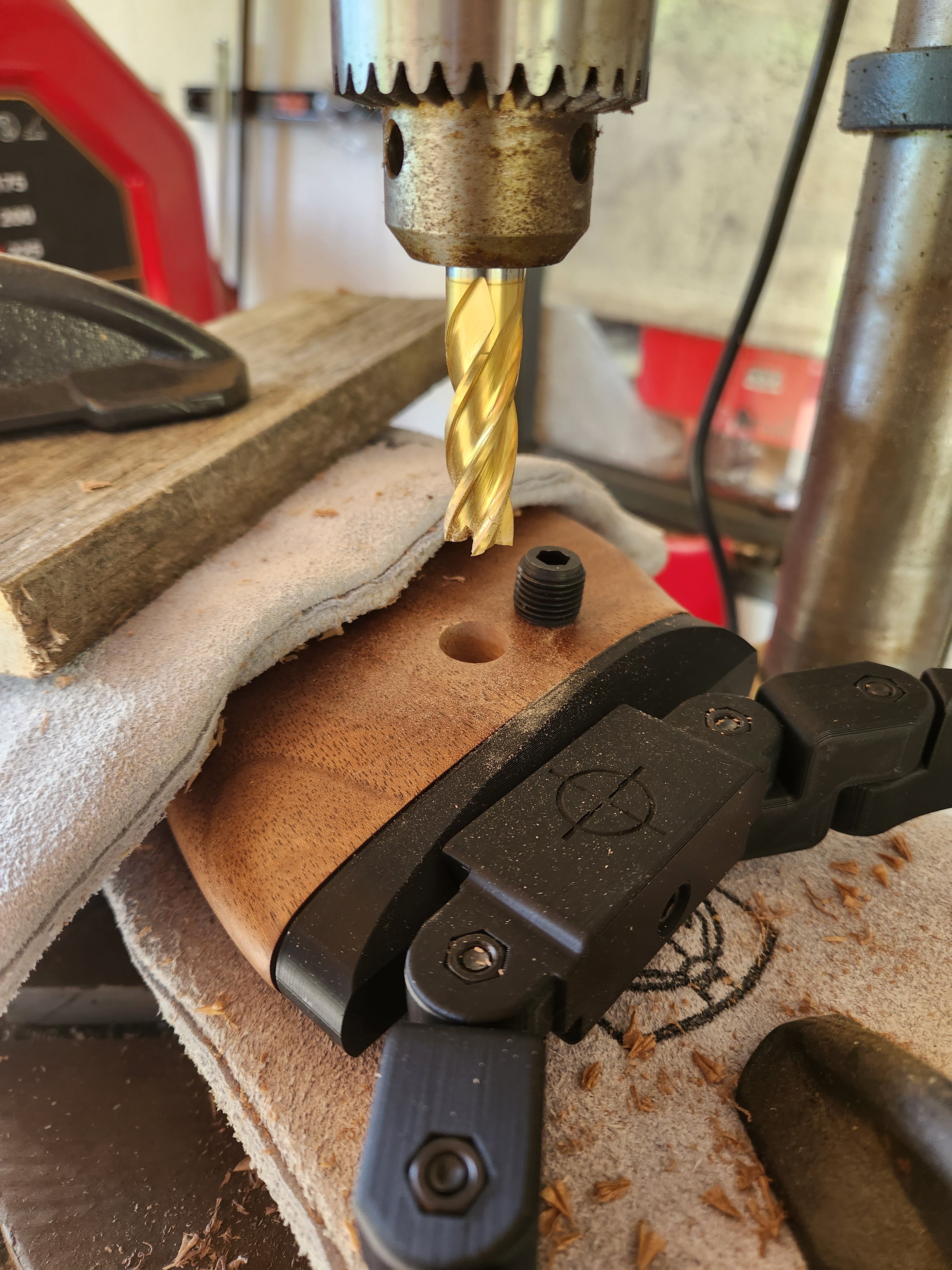

@RM100GUY, I plan on shooting it tomorrow. Too breezy today for accuracy. I did run about 300 pellets thru it today & no jams. I was playing with my new toy & checking FPS, etc. It was 800 or less with the 18, 850 with the 15.89 & over 900 with the 13 grains. That was after turning the hammer spring adjuster in one complete turn. I don't think it will develop much more energy with this short barrel, but I can live with 850. Mine has a factory shroud; after several flyers, I took it off and noticed a slight bump at the muzzle; a screw is used to hold it together. The screw was tightened, leaving an indention into the baffle where the pellet exits the muzzle. I took the screw out, drilled the end/hole out a few thousand over; this removed the indention & put it back on. I only shot a few afterward, but that may have been the flyer creator. I thought the factory shroud worked pretty well for its limited capacity.

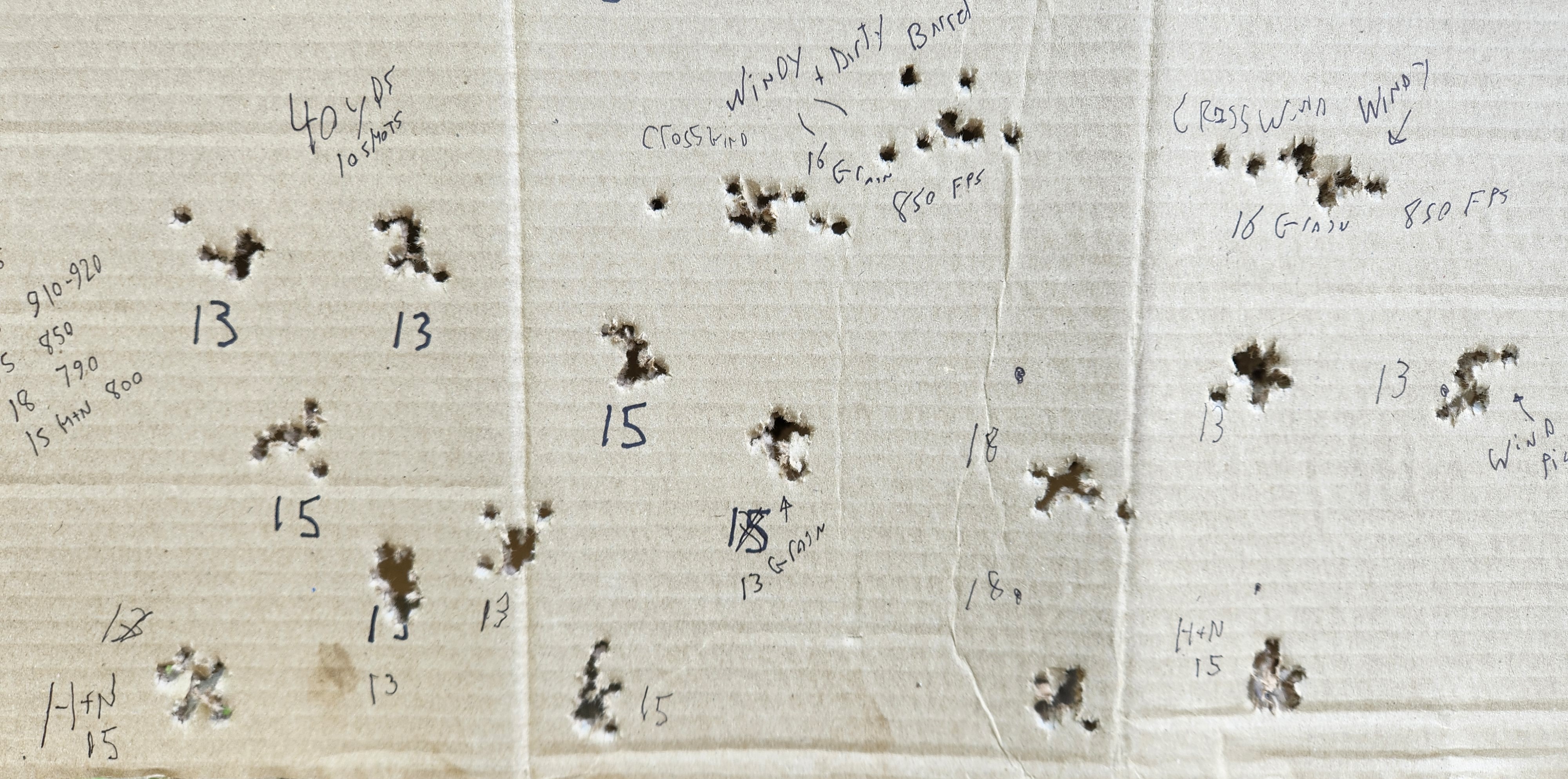

I shot at least 500 shots today; not a glitch. All these groups were 40 yards & 10 shot groups, fired as fast as I could get back on target. I used 13, 15, 18 grain JSB & 15 grain H & N. My rifle seemed to shoot a little slower today & I cranked it up another 1/4 turn. I found that after 250 shots, it wants the barrel cleaned. I had some crosswinds at the time, and some of the groups show that & the worse groups were before I cleaned the barrel. So far what I am seeing, I can live with. I like the trigger. It is better than the one on my FX Impact, not as good as the one on my AGT Vixen, IMO of course.
Reactions: RM100GUY

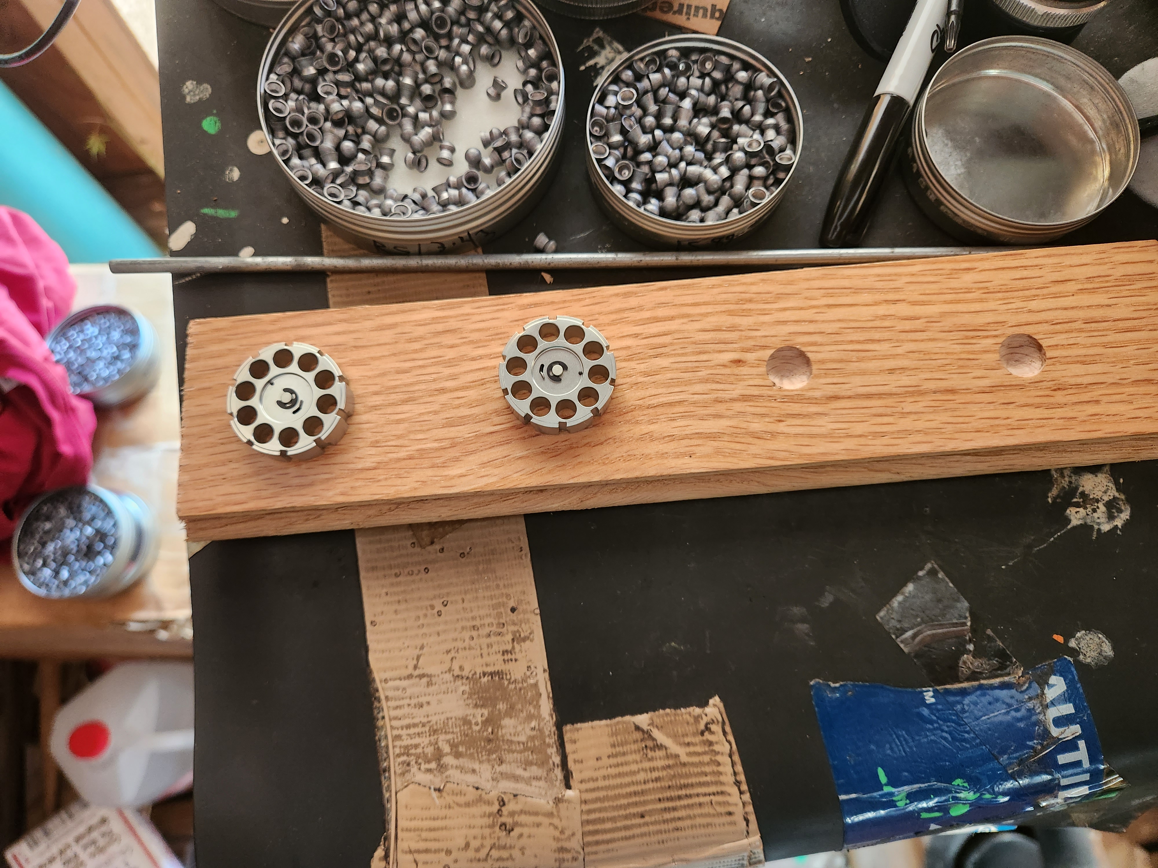

Oh, here is one thing I did today. I put some holes in a piece of hardwood to set the slot on the mag in, then with a closed ink pen, I pushed the pellet till the nose hit the board but was flush nearest the chamber or barrel throat. I don't know if this helped or hurt, but at least every pellet was seated the same. The 15-grain H & N pellets were the tightest fit in the mag and shot at 800 fps, while the 15-grain JSB flew at about 840-850.
I've done the same (seating the pellet) with a couple of co2 pellet guns...AND my Steyr LP50 Sport. I saw this in a YouTube video some time back.
Yes, the accuracy does definitely go...up for most shots. There's always the self induced...flier !
Thanks for the hint.

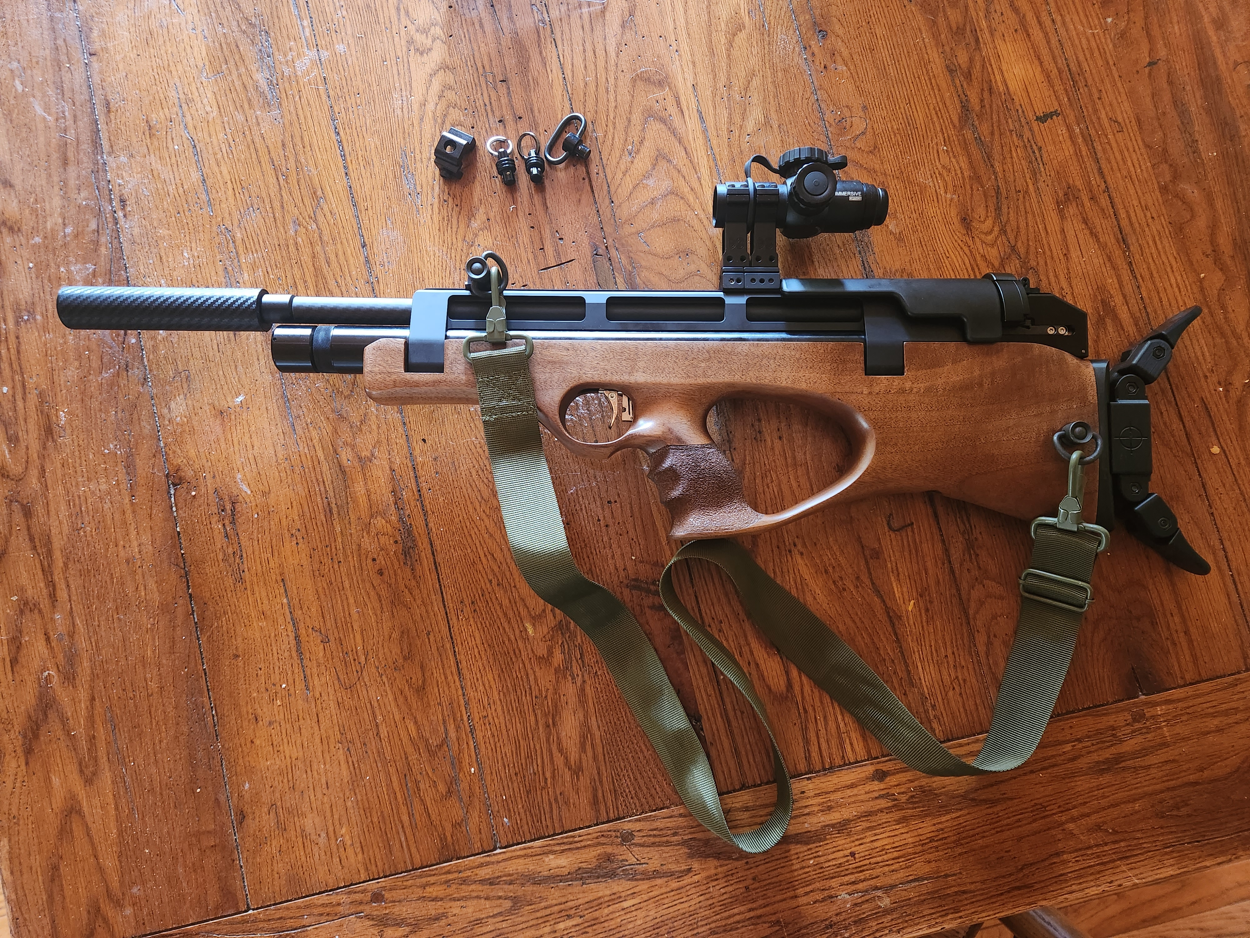

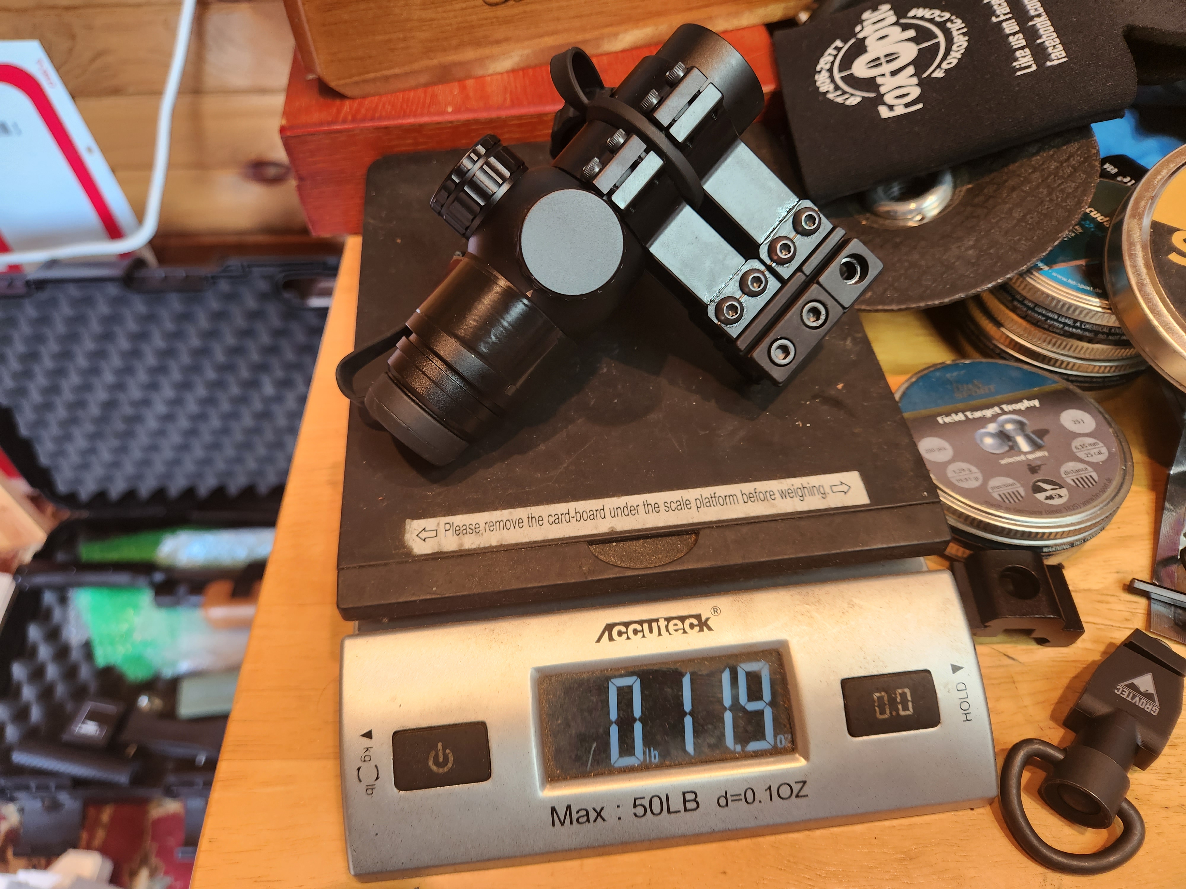

Ready to hunt at 8-pound 2 oz, w/o mod, a hair less than 8 pounds. It slings nicely; I will add a paracord loop between the sling hooks & QD swivels for noise reduction. I carry all my rifles, so weight reduction & slinging is a must. Rarely shoot from the bench except for sighting in or testing accuracy/fps.

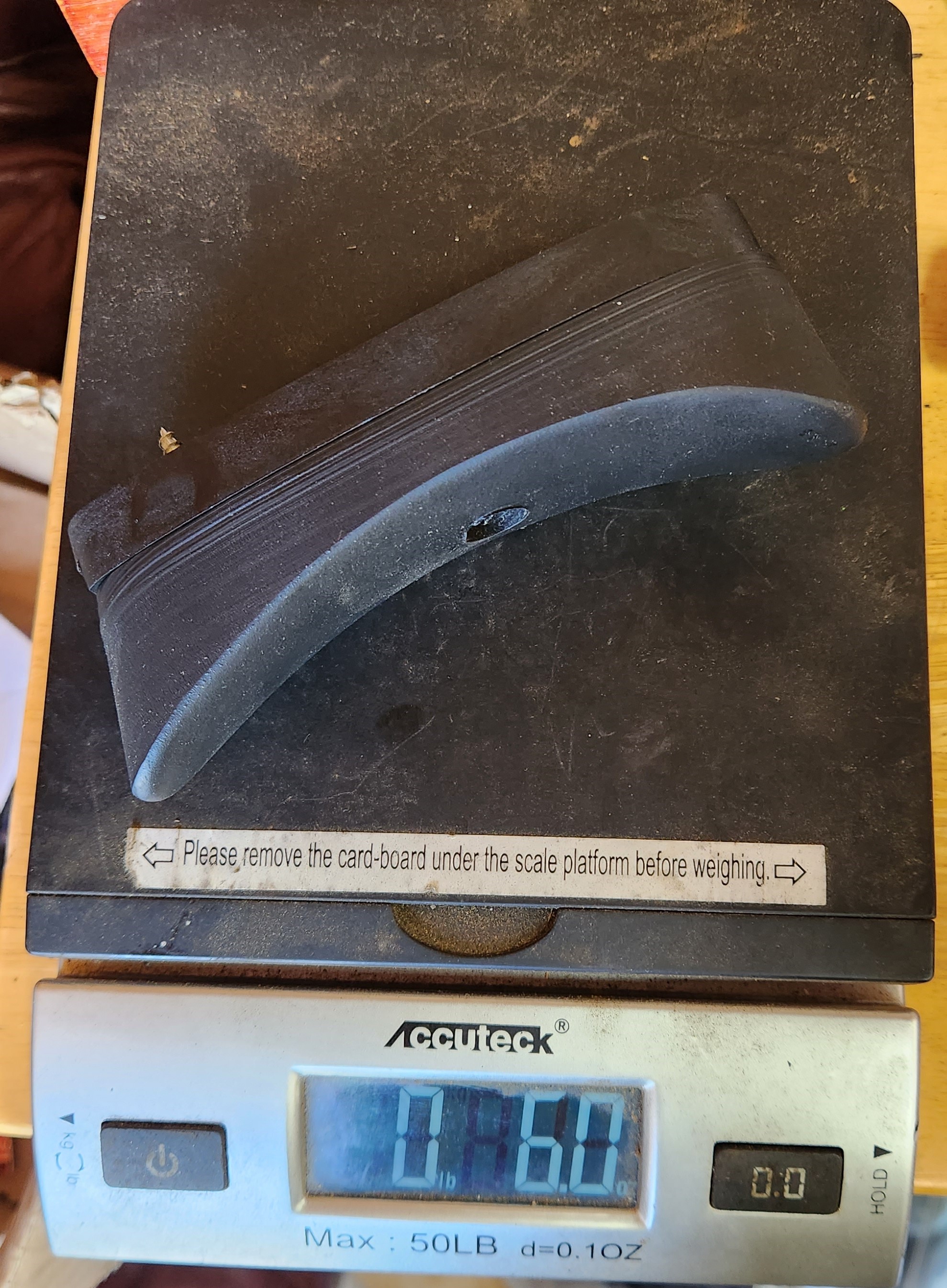

The immersive 10x24 is at the optimum height for me to have a quick natural behind-the-scope experience. I used D3 30 mm x 11 mm rings 1.3 high & 2 BKL risers. If you want to go for lightweight, remove the factory riser, which weighs 6 oz. That is over half what my scope & rings weigh. The factory butt plate is heavier than this one too. Another thing is the Walnut stock is lighter than the laminated. I think My walnut is 1.8, and I heard the laminated is 2.3.
D3 rings, https://www.ebay.com/itm/264268435836?hash=item3d87a0517c:g:u6cAAOSwF3Vc2xkf

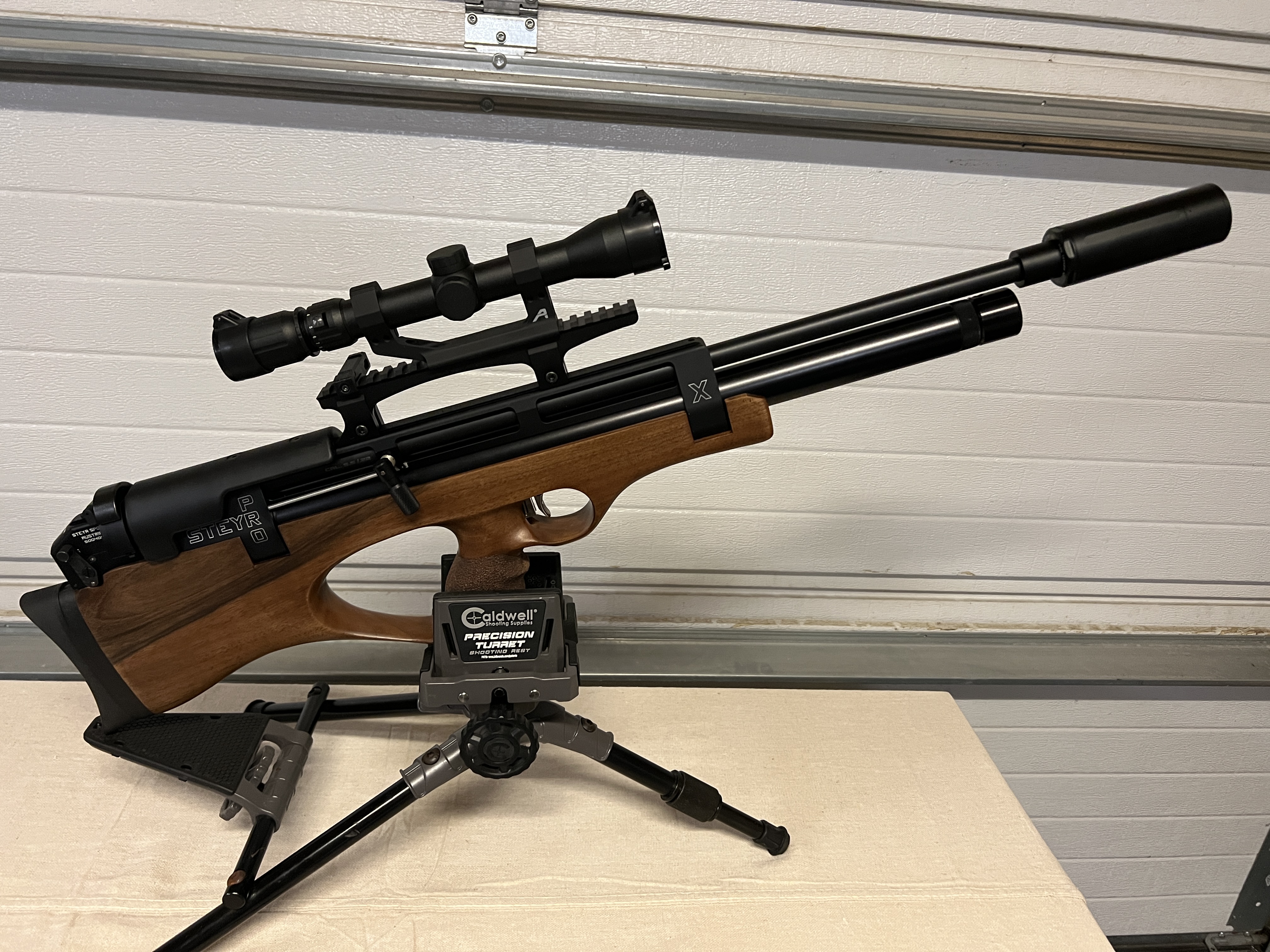

I did find the Pro X rail too high. Here's what i did with mine, real simple: This is from my post https://www.airgunnation.com/thread...hree-semi-autos-updated.1278083/#post-1379083
The final change has been to my Steyr Pro-X, and its really a minor one. I found that the Pic Rail that the gun came with was simpl,y too high for my comfort. While it worked fine, and i shot the gun well, I prefer a lower position for my scopes, or, to put it another way, a tighter cheek weld. So I took the Pic rail off and used a Dovetail to Pic rail adapter to mount the scope. The difference is shown below:
New/Now
Original
