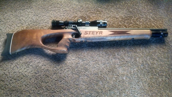

Here is a picture of mine. It's the 40 Joule Scout. I added the white line spacer on the butt pad, and added checkering on the bottom of the foream. Also sling stud on butt, and recessed sling cup under forearm. Awesome 35" short, and light weight rifle. 7lb 3oz WITH scope and mounts. It is not that loud. Much louder than all my other PCP's, but they have shrouds or LDC's. I wanted to keep it short, and noise is no problem in my forest home location. About as loud as a cap gun. Way quieter than a .22 rimfire, firing a ".22 short" round. The trigger is right up there with all of my match rifles, especially after I reduced the first stage travel. 875 fps for 60 shots with JSB 15.9 pellets. The balance of this gun makes it feel even lighter than it is.

Awesome rig! Wish mine was that short. Are you sure about that shot count? If I recall correctly thats about what I'm getting out of the full length version with longer barrel & air tube.

Thanks Michael. Yes, it seems to come off the regulator right around the 55-56th shot, then I get 4-5 consistent shots at about the same velocity after that, before It starts dropping more dramatically. I've checked it on my Chrono through three fills to 3K psi, because it was a higher shot count than expected. I spoke to Richard from Krale several times before I purchased this, and he said to expect around 50 shots with the scout. I don't know what the reg pressure is set at on these rifles, I haven't touched mine.
I too really like the carbine size rifles. This is an amazing shooting machine.

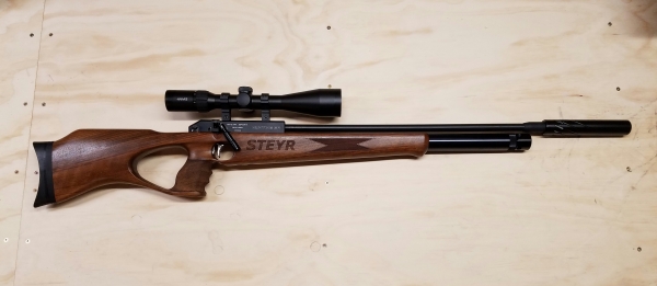

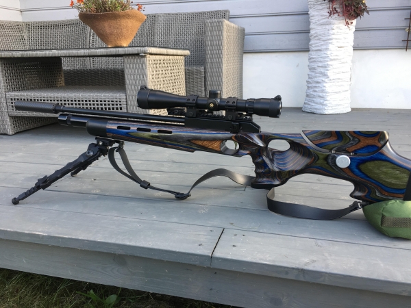

Certainly,,,,,its off getting the regulator adjusted right now but here is my Steyr LG110 HFT

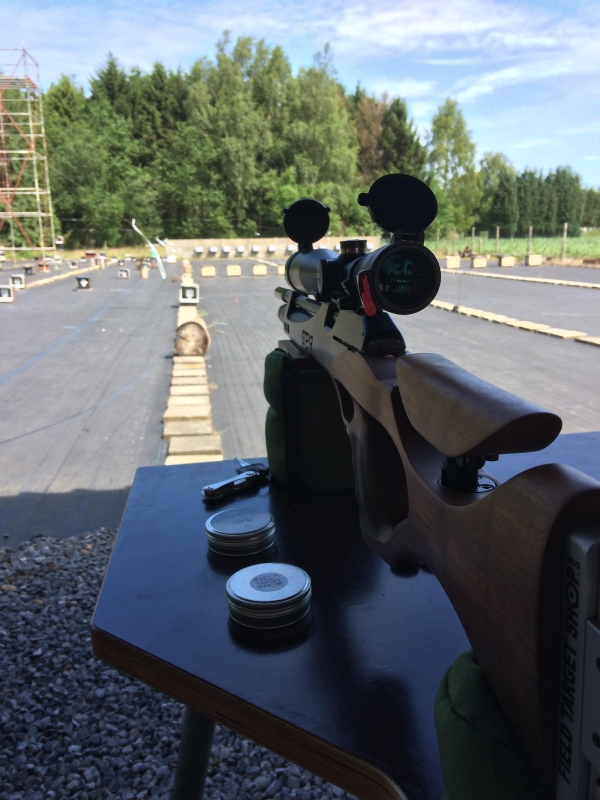

Finally a thread about (IMO) the best made airguns today ;)
I mainly use mine for 100 meter target shooting but it is so easy to change it to an other type of shooting that I sometimes set it up for benchrest or HFT.

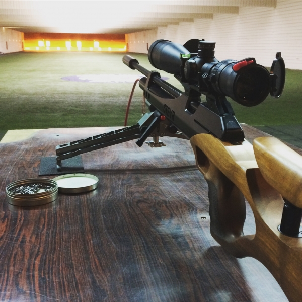

My 100 meter setup:
20 MOA bridge for optics, Meopta Meopro 6-18x50 on top. The moderator is an ATEC wave carbon (great little moderator!) and the bipod is a Tier-one FTR bipod.
I also have an atlas bipod to fit underneath it:

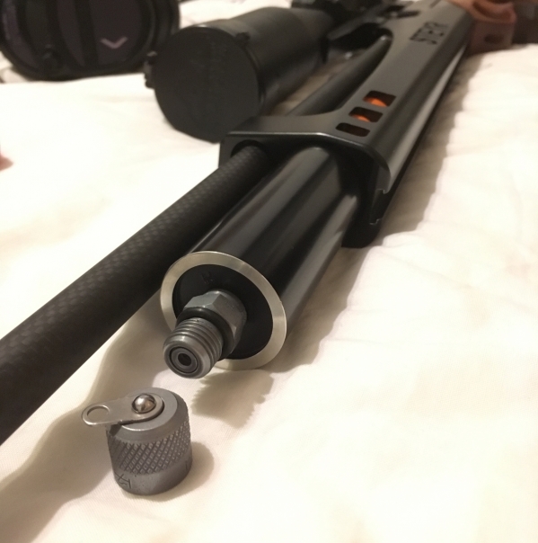

Also added a quickfill to the cylinder:
This is a temporary measurement connector (minimess) because I've dismantled the internal regulator to use an external regulator. This makes it easier to try out what would be the best regulator pressure without being bother by potential sticking of the internal valve of the foster fitting.

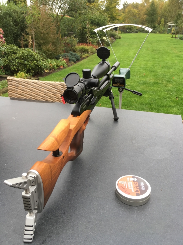

And within 10 minutes it is set up to shoot other disciplines:

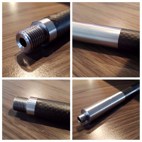

And the most beautiful thing on my steyr at this moment is my new barrel :)

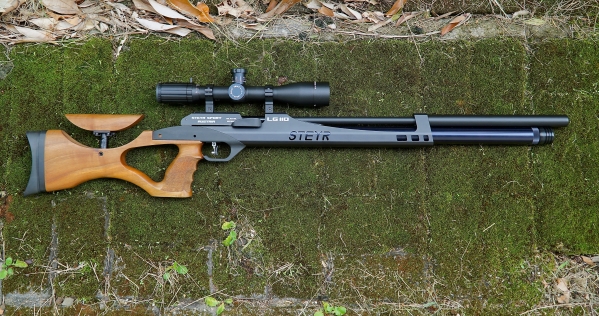

Here are some pics of my bird perforator:
