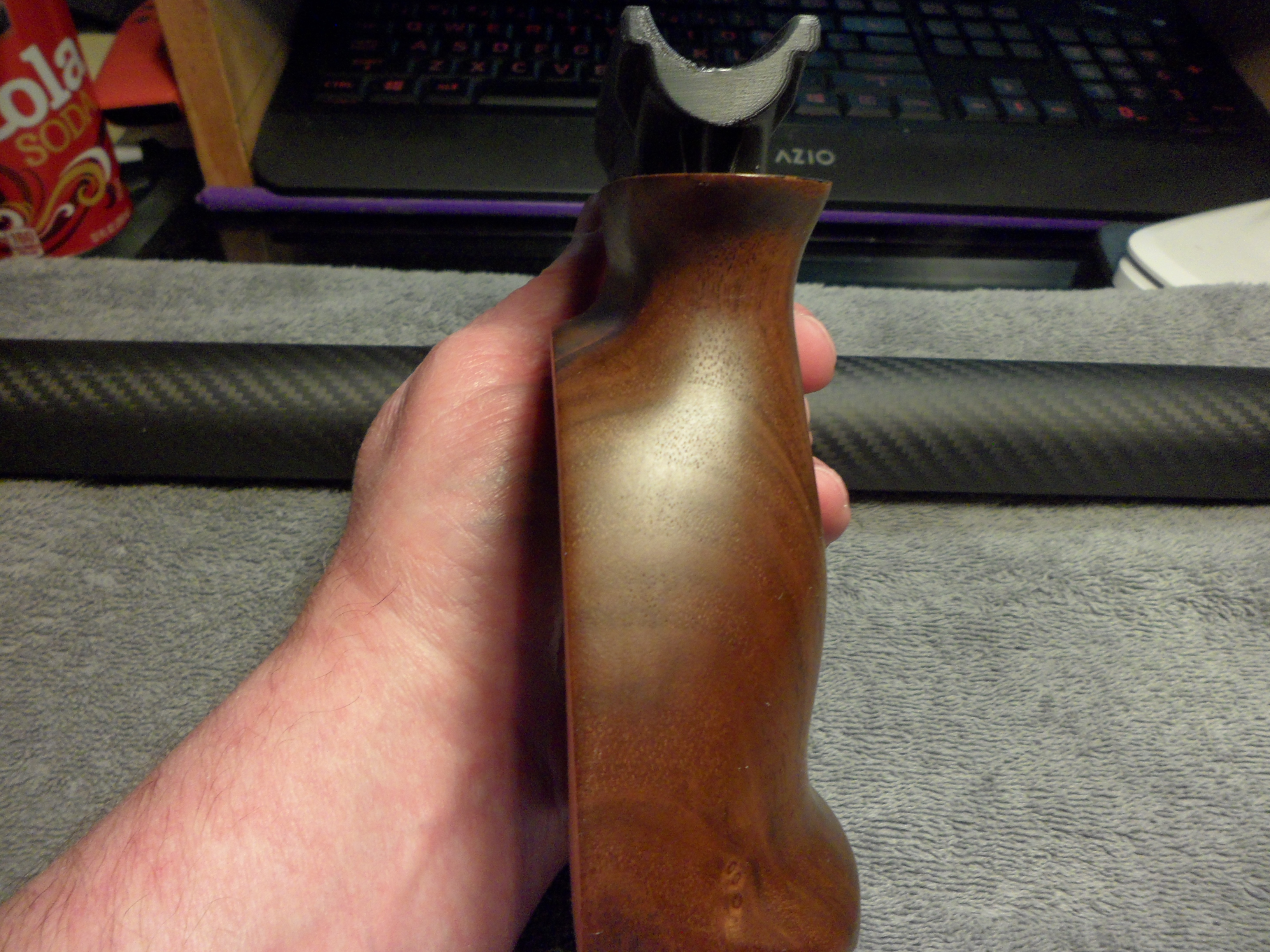

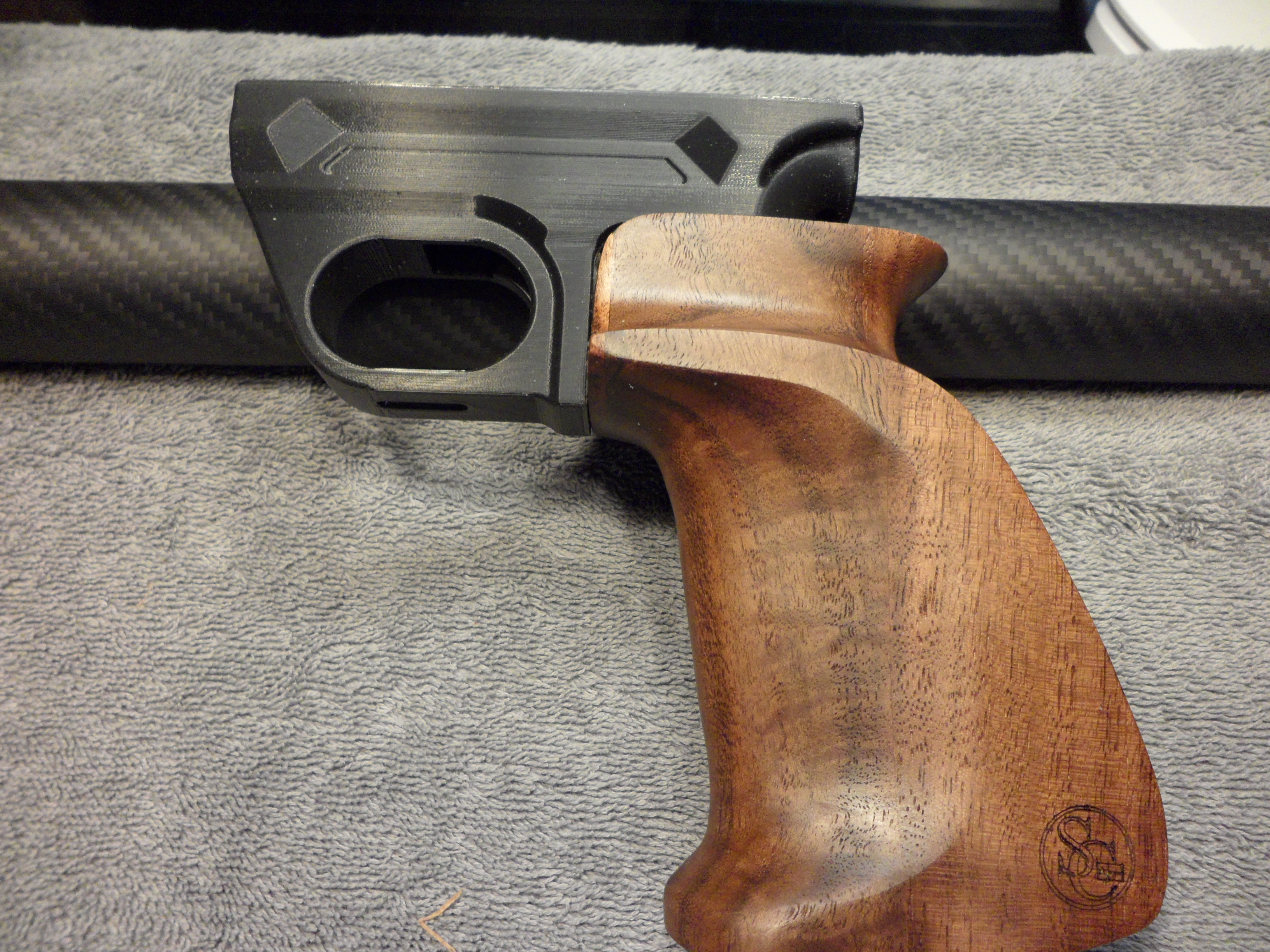

so i have seen SC list a FX grip for a long time and hearing that they are AR-15, and thought when he put the one on sale to see what we would get
the SC inlet was about 9.12mm wide and BR was 9.64mm, well that isn't going work and of course the screw was not going to work either BR is 5mm but who cares and a 50mm m5 will be needed
what is going to be harder to work on the Walnut or the 3D printed frame and that answer is the walnut but i did clean up some areas in the inlet and that got me .07mm +or-

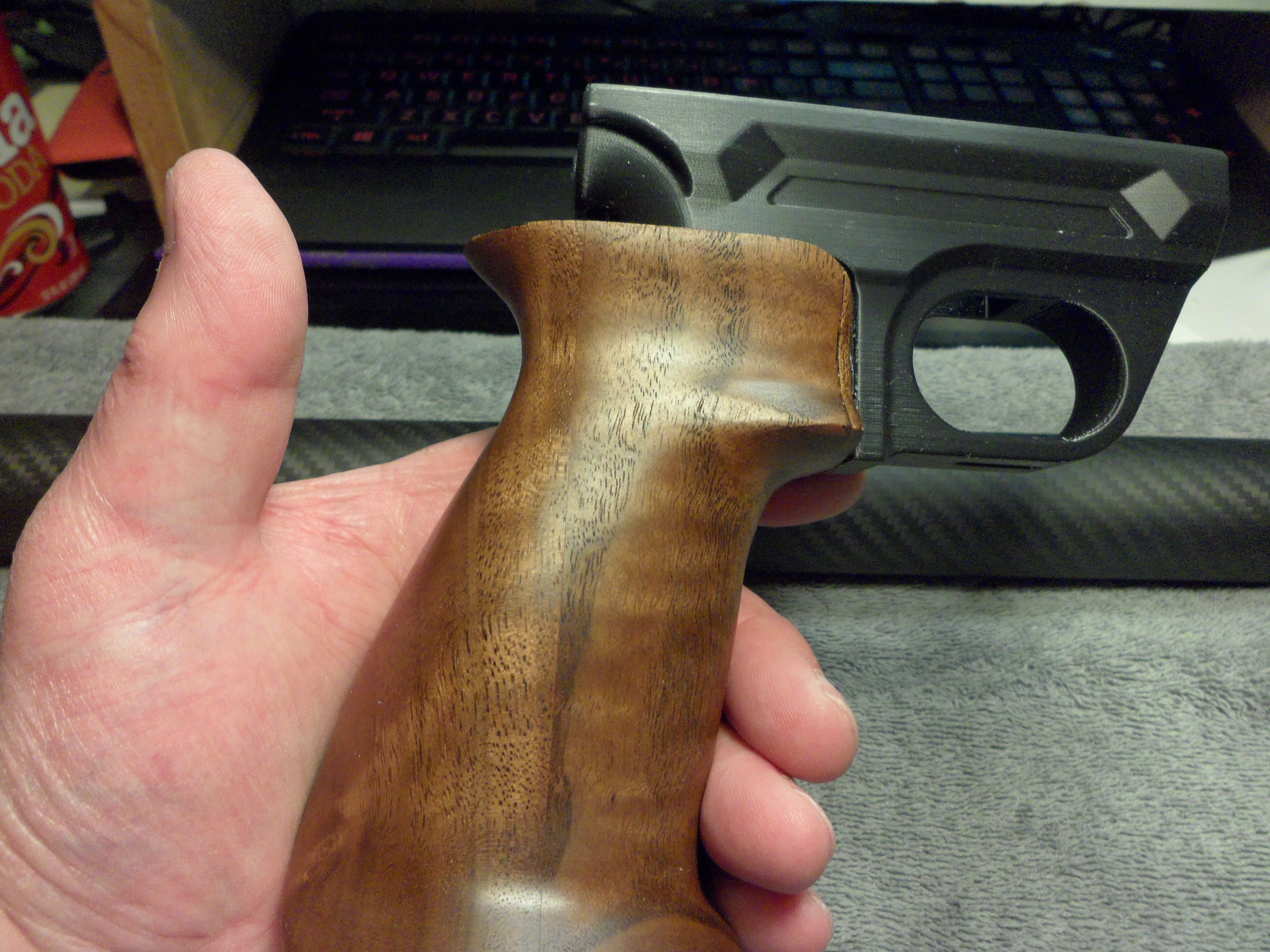

scraped the BR frame down to make it small enough and it took about 45 minutes and got this

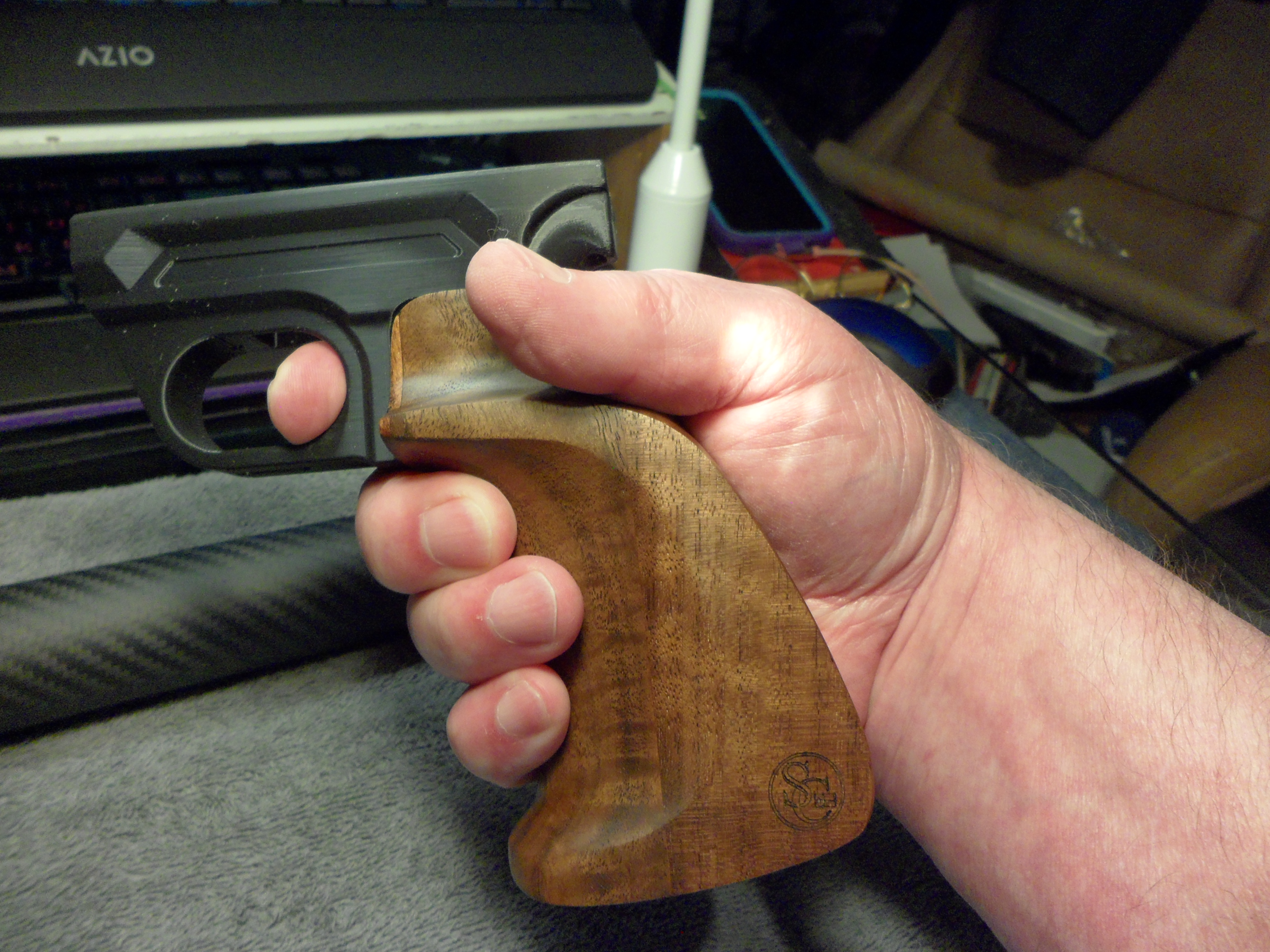

it is nice looking setup feels great in the hand and it is a little project that i have wanted to try
is it a perfect fit maybe not but you have to love a walnut grip
now my hand is 105-110 wide
