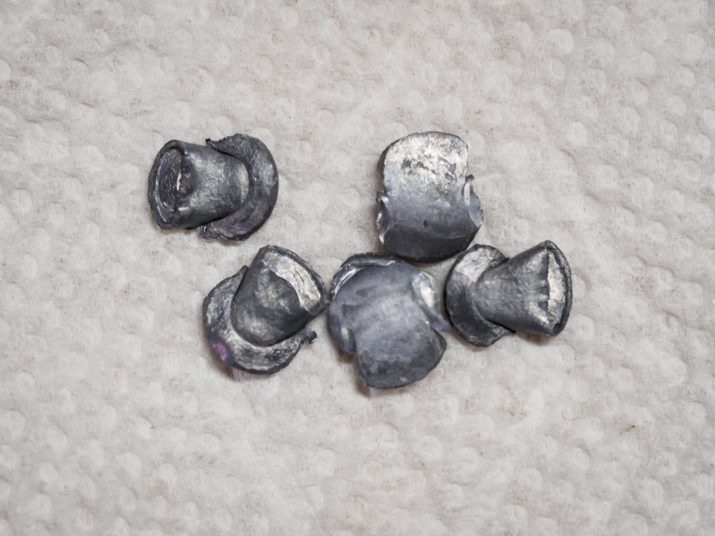

The amount of dust surprised me, so I performed a little test after thourougly cleaning out the trap. I ised my 300S to shoot five match pellets weighing 7.6 grains each into the trap then emptied the trap. What I recovered was five unrecognizable chunks of lead with an average weight of 7.3 grains. The missing 0.3 grains was presumably lead fragments and dust. There must be a better way.
