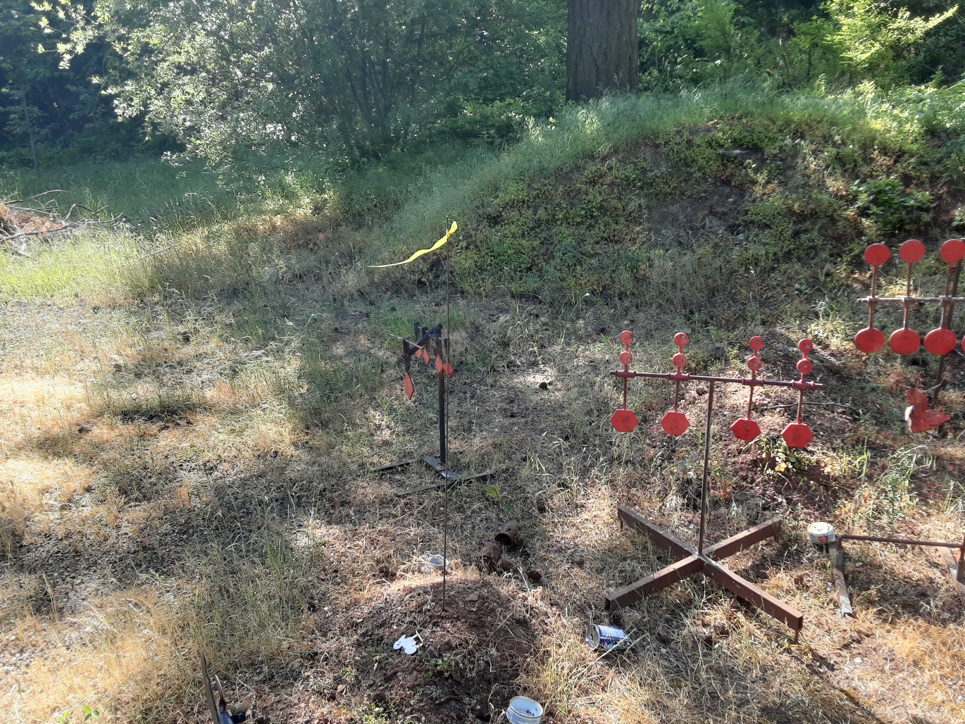

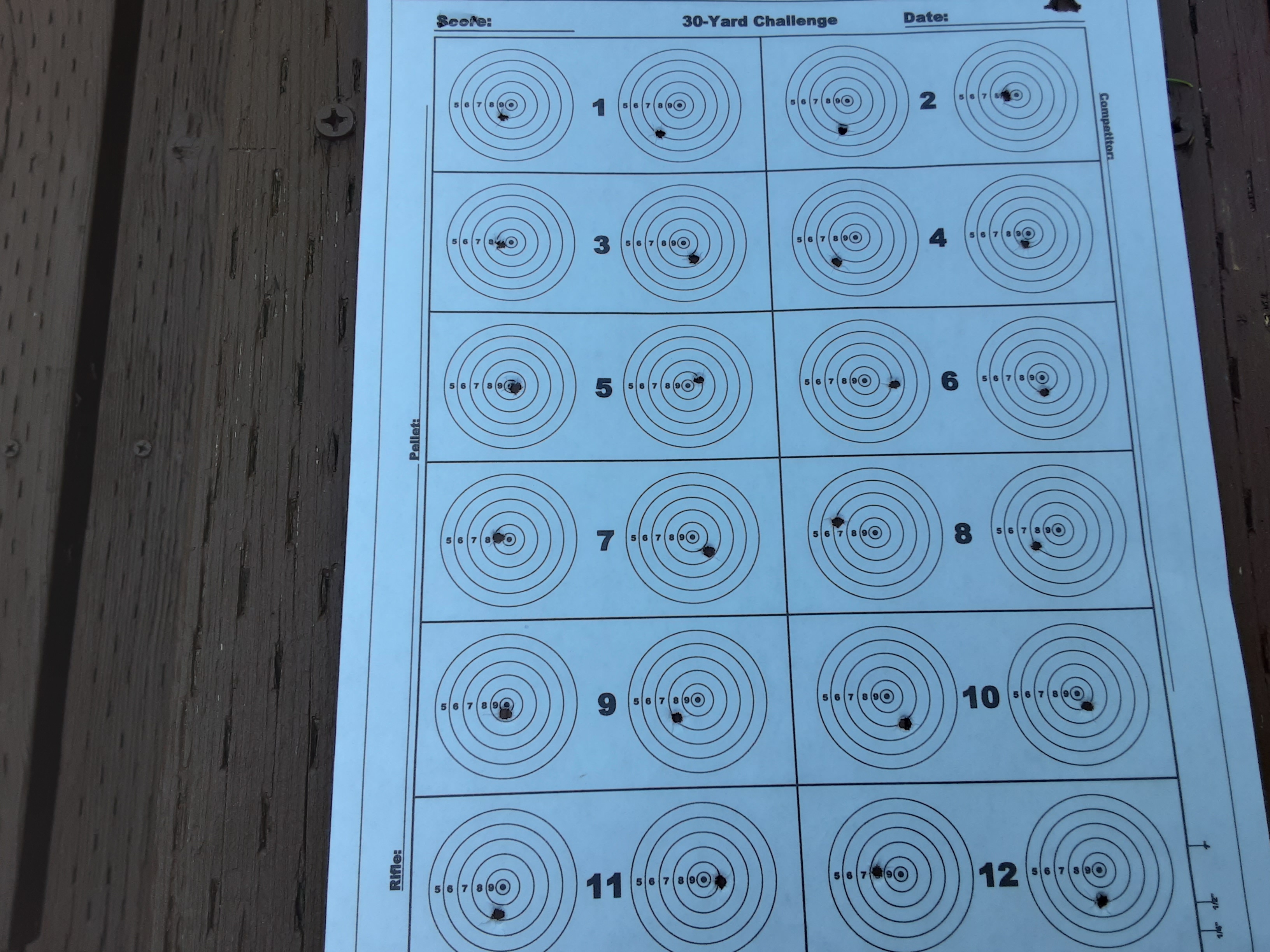

Here's a 30 yard target attempt with the Vet compact .177 . I'm getting better holding off for wind anyways. Looks easy but it's like shooting a fly on each attempt.
The wind ribbon shows the condition. Just crosman 10.5g pellets from the box.

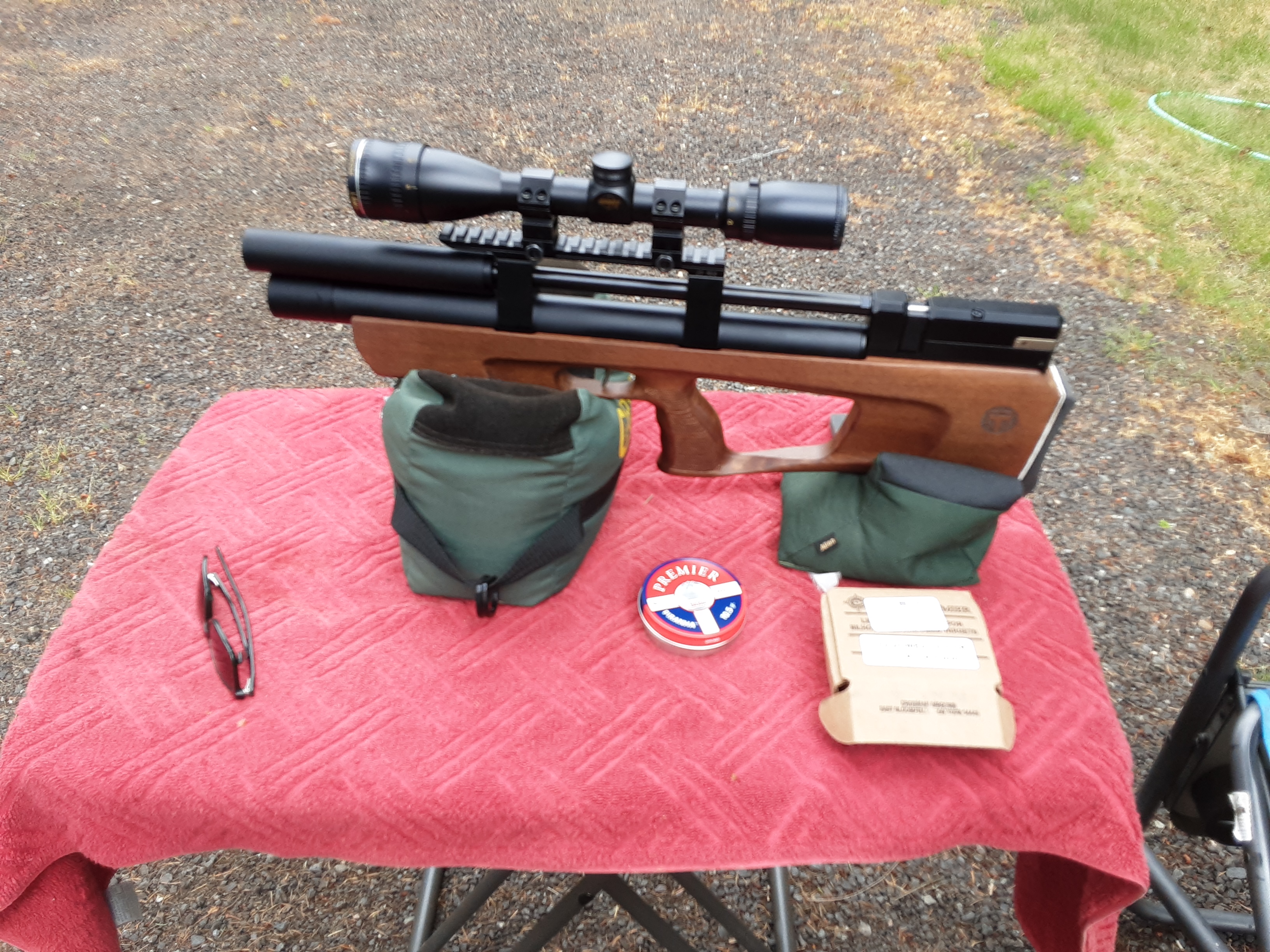

Here's a shot string from my compact in .177. 1/2 turn out on HS adjustment. Not a full shot string but enough for me to conclude.
Notes
Pellet:crosman taipan short
Weight: 10.5 gr
Shot count: 22
Low: 870
Hi: 877
Avg: 874
STD Dev: 2.0
Spread: 7.0
5/30/23 1:01:18 PM,872
5/30/23 1:01:53 PM,870
5/30/23 1:02:14 PM,875
5/30/23 1:06:02 PM,872
5/30/23 1:06:26 PM,872
5/30/23 1:06:56 PM,872
5/30/23 1:08:01 PM,872
5/30/23 1:08:31 PM,875
5/30/23 1:08:56 PM,875
5/30/23 1:09:31 PM,877
5/30/23 1:10:55 PM,872
5/30/23 1:11:58 PM,870
5/30/23 1:12:26 PM,875
5/30/23 1:15:14 PM,877
5/30/23 1:16:00 PM,875
5/30/23 1:16:21 PM,875
5/30/23 1:16:53 PM,875
5/30/23 1:17:27 PM,872
5/30/23 1:18:04 PM,875
5/30/23 1:20:01 PM,872
5/30/23 1:20:36 PM,872
5/30/23 1:21:27 PM,875
