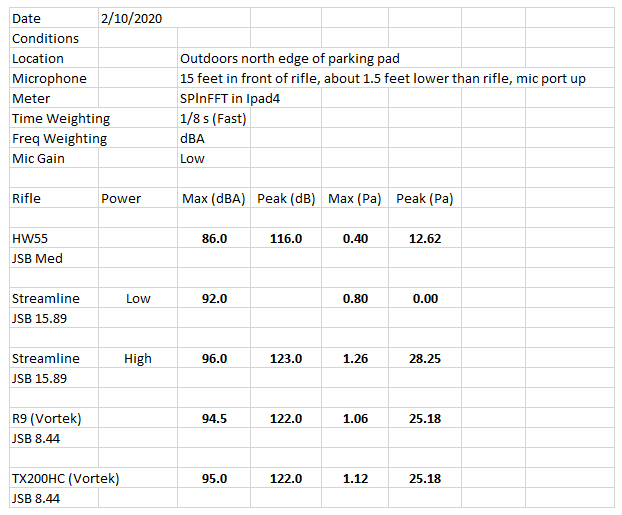

However, there is a solution.... I find that there is a method that will produce useful data, even with different test protocols:
A silencer test that compares enough silencer models using the
same conditions for all silencers tested — such a test will produce data that can be comparable within the confines of the test.
➔ The challenge is that whoever runs the test
should have a good amount of silencers on hand....
I know mrbulk (Charlie) is one such airgunner who not only has a bunch of silencers, but also invest time to test them — and to publish his results for us. THANKS!
The above mentioned tests by Silent Thunder Ordnance (STO) are another good example.
There are a few more tests I mention in the
Specs Table.
To make this testing happen we could pool our silencers — send them to a trusted individual who is interested in conducting the tests — and then we get a both broad and comparable test results. It worked great for STO's test, why wouldn't it work for us at the AGN community?
