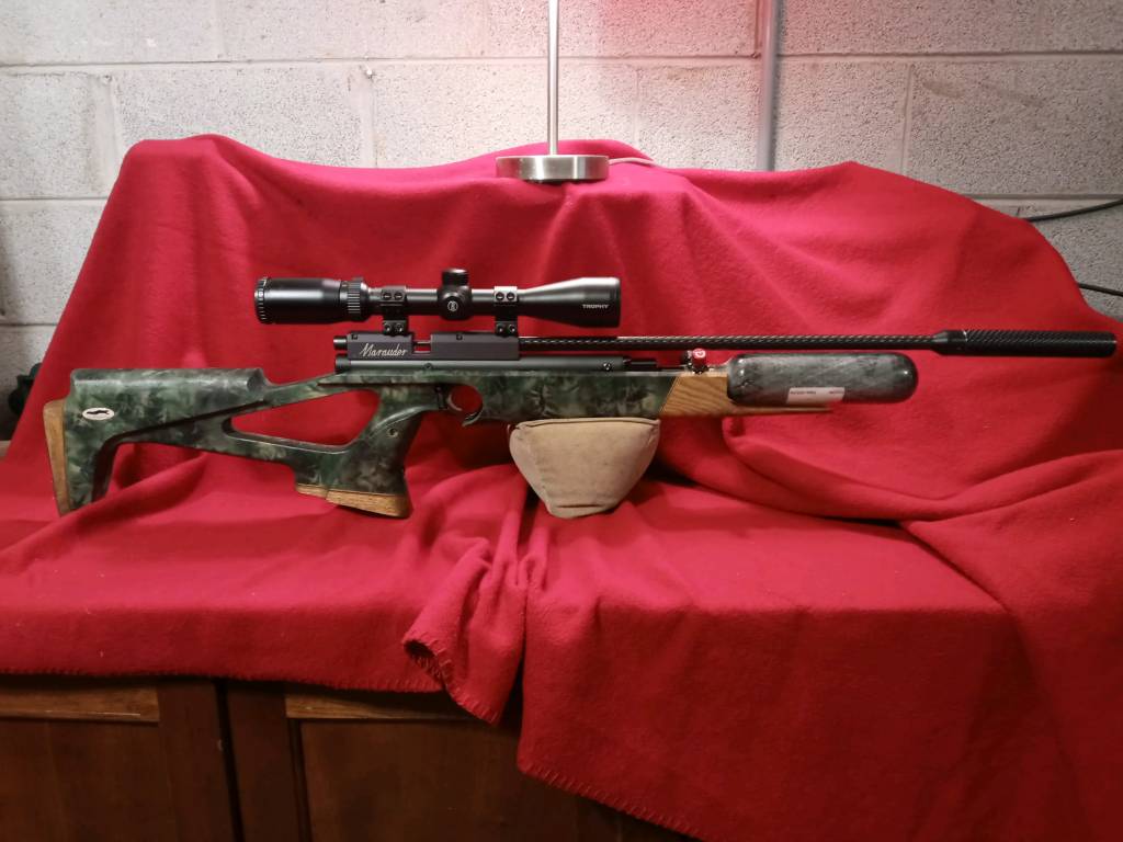

You just trying to get 20 fpe out of a p-Rod?
I did a bottle job on my P-Rod after the 1720T bottle thing turned out so well. 20 fpe was no problem, but I was going for 30+ fpe.
Ended up going back to a extended tube/non regged set up. Better power than a 2200 psi regged bottle. But 20 fpe was no problem whatsoever.
The Huma reg probably is the way to go, gonna check out the website, even though I know it'll cost me!
P-Rods sure are a blast!
Ron - if you'd like me to send you a Marauder Pistol tube cut to 10" and drop block ready, the one used in the above pic, just pm me your address. It's laying around and needs to be put to good use.
