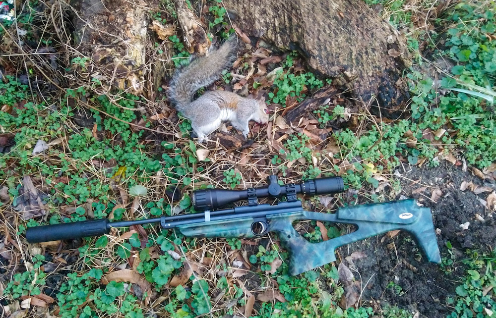

This one was sub 500fps with crosman 14.3gr .22. Dropped on the spot and did not move. @25 yards
I also got one with a diana bandit .177 detuned to 650fps at the muzzle @30 yards in the same fashion. 8gr crosman pellet as well.
