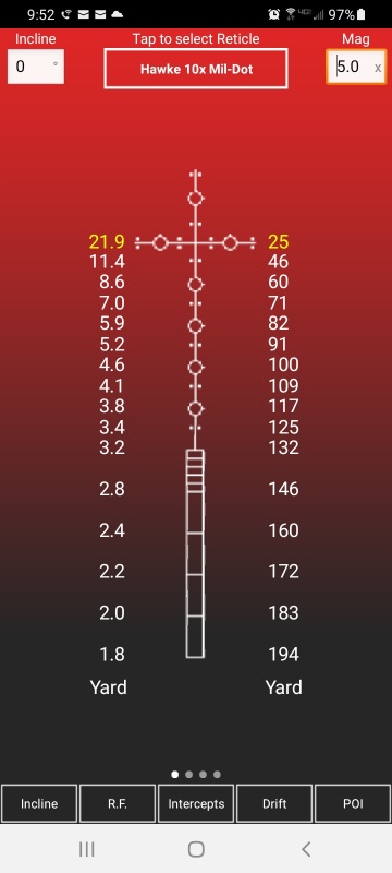

about 2.5 mil holdover (for this configuration)

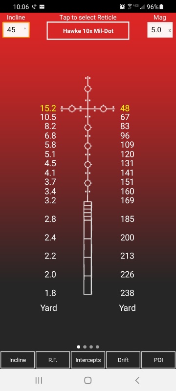

Same configuration at 45degrees up is now zeroed at 48yard instead of 25yards. If you want a quick correction aim base on the horizontal distance, rifle man's rule. A high power PCP will shoot pellets at 850 to 800fps for best accuracy. Sub-sonic and pellets also have BCs much lower then bullet.
