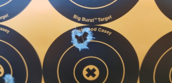

Tom I watched most of your videos today. I also liked and subscribed to them. Good stuff. So, I looked at the test target for my gun again, it was shot with JSB 15.9 grain pellets. The only thing that has changed since the test target was shot is that I added a DonnyFL Sumo silencer. I took it off and shot a bunch of awesome 10 shot groups from 30 yds. I took the Sumo out to the garage, bored it out and viola, problem solved and it's still quiet as ever! It was barely clipping but enough to throw off my groups with an occasional bad flier. The bad part is that I was advised to get a .25 silencer for my .22 and I didn't, I forgot, my bad! Problem solved though, feeling a lot better. I'll stretch it out this weekend and after weighing and lubing pellets,
I should have some super groups. Thanks for all the help everyone. 10 SHOT GROUP FROM 30YD. Didn't measure but about 1/2 inch! Kevin
