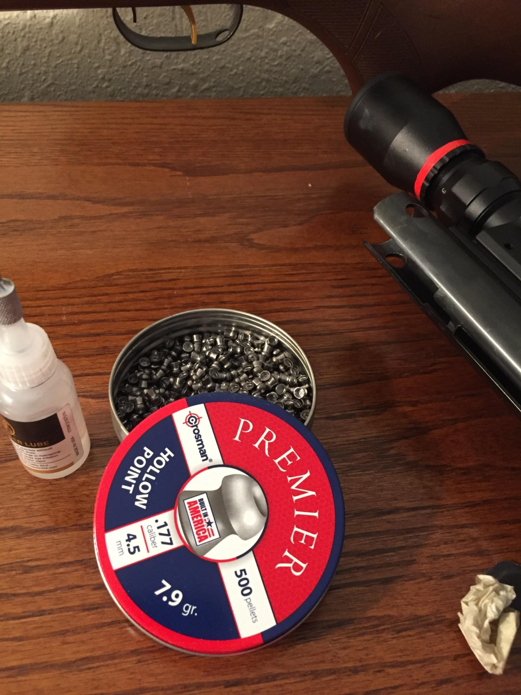

Yo! I finally bought these due to your amazing marketing.

Per Yo's suggestion I'll check out the local Walmart for the hollow points and look into the brown box Crosman's as well.
