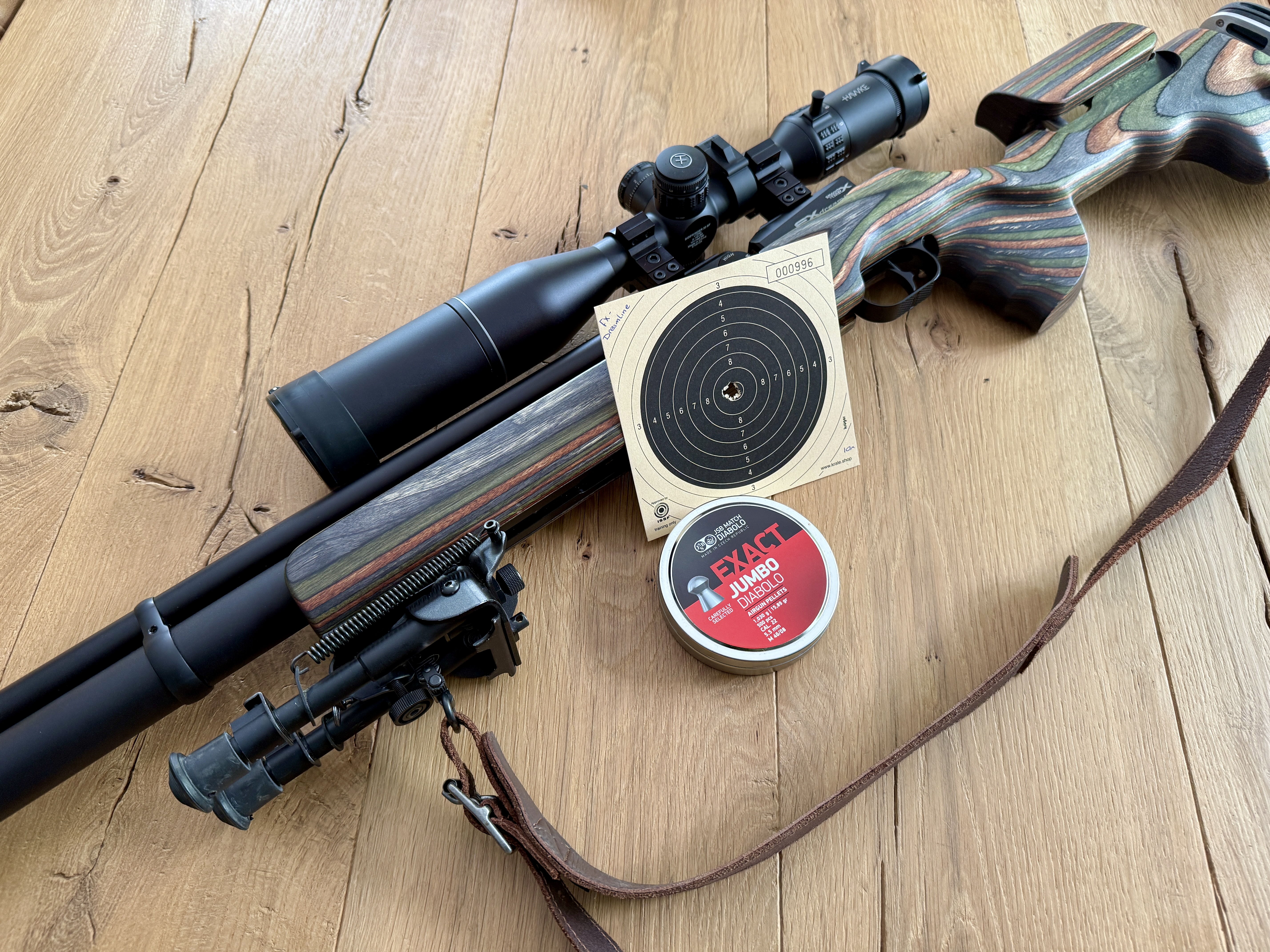

Number 1): the FX DRS Tactical (out of the box, 41 joules shooting 18 grain .22 JSB's at 25 meters from a bipod).

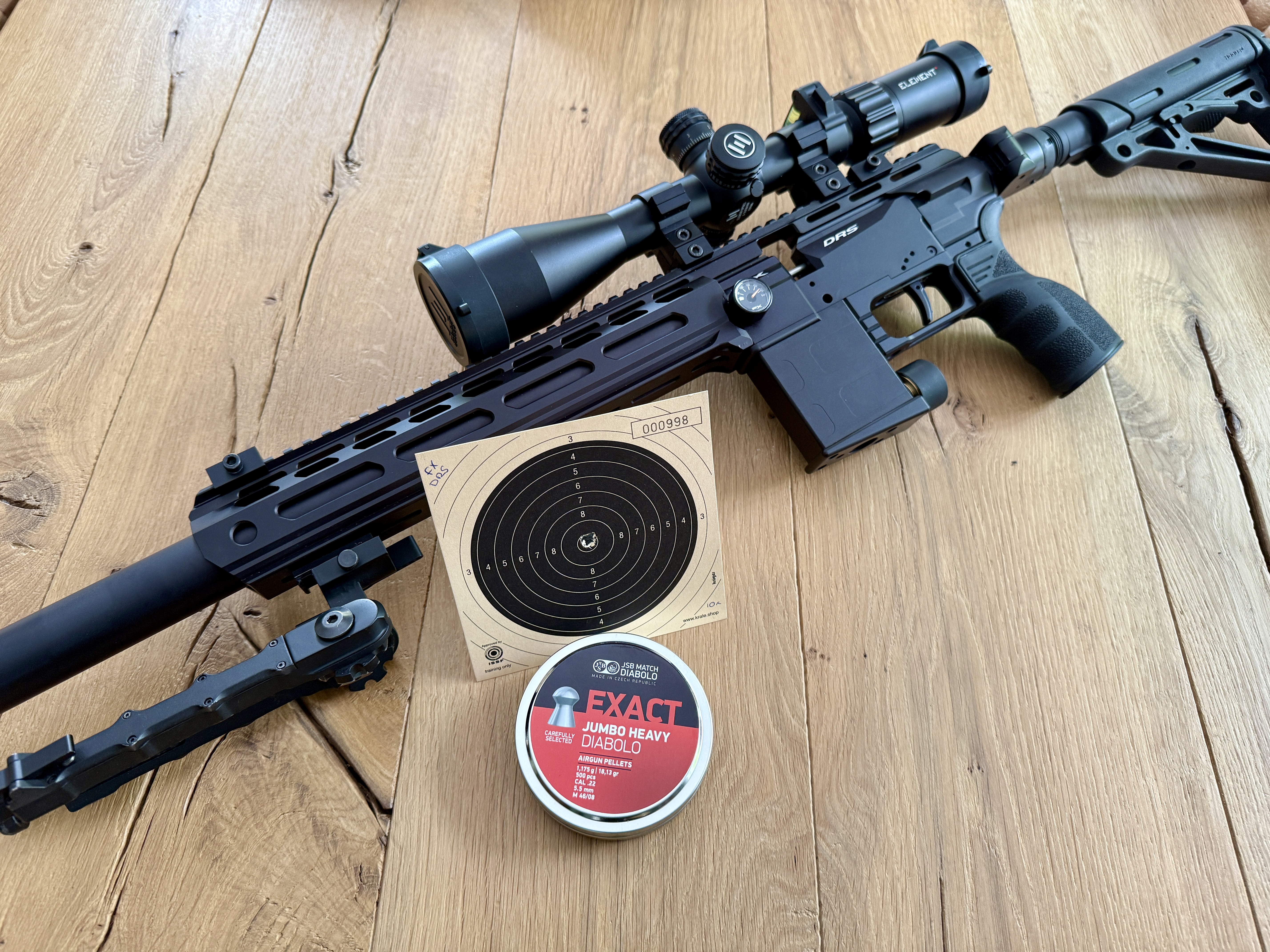

Number 2): the FX Dreamline GRS (medium settings, 31 joules shooting 16 grain .22 JSB's at 25 meters from a bipod).

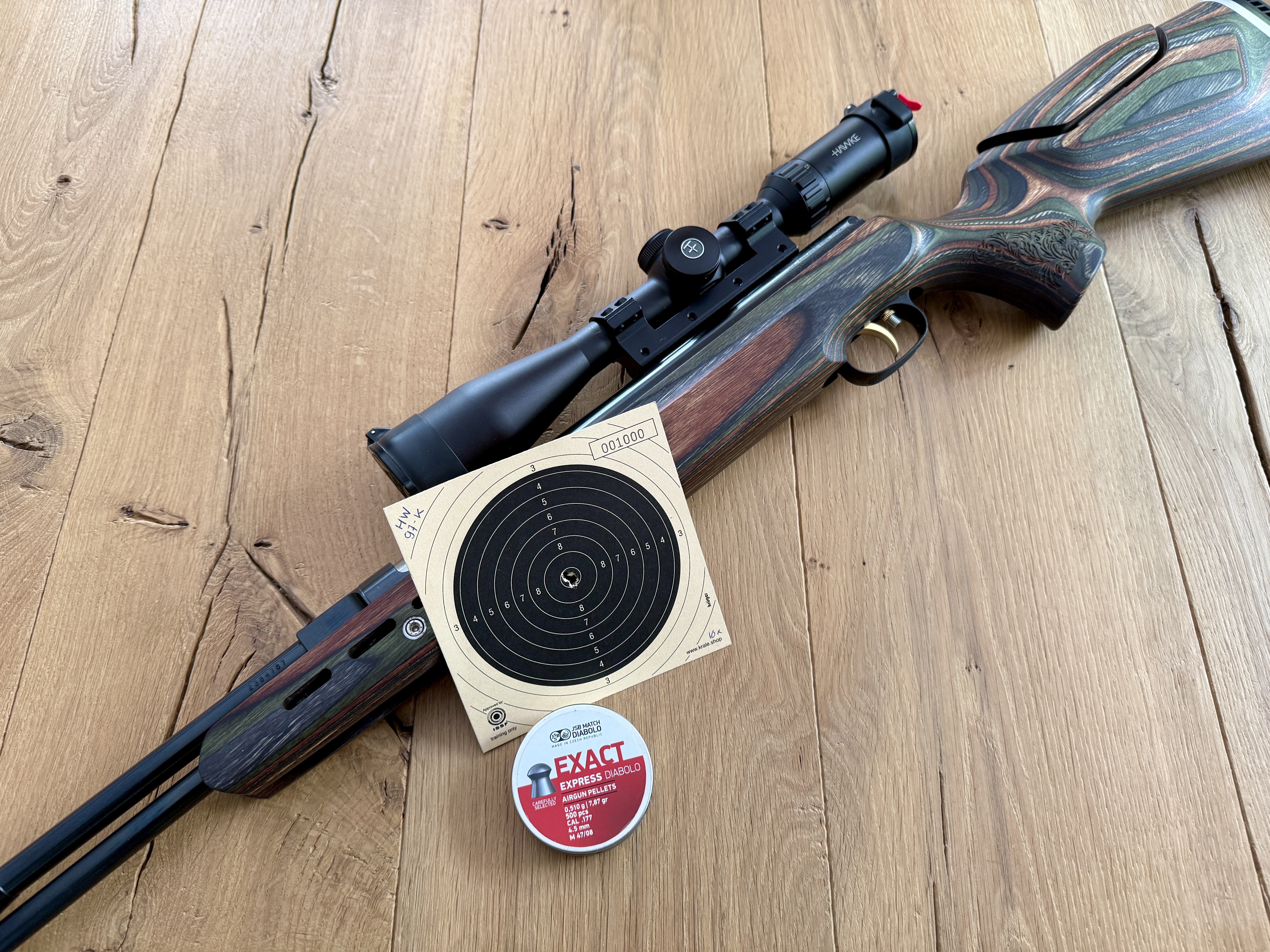

Number 3): the Weihrauch 97 (stage 2 tuned, 21 joules shooting 7.87 grain .177 JSB's at 25 meters from the bench on a pillow, rested on my hand).

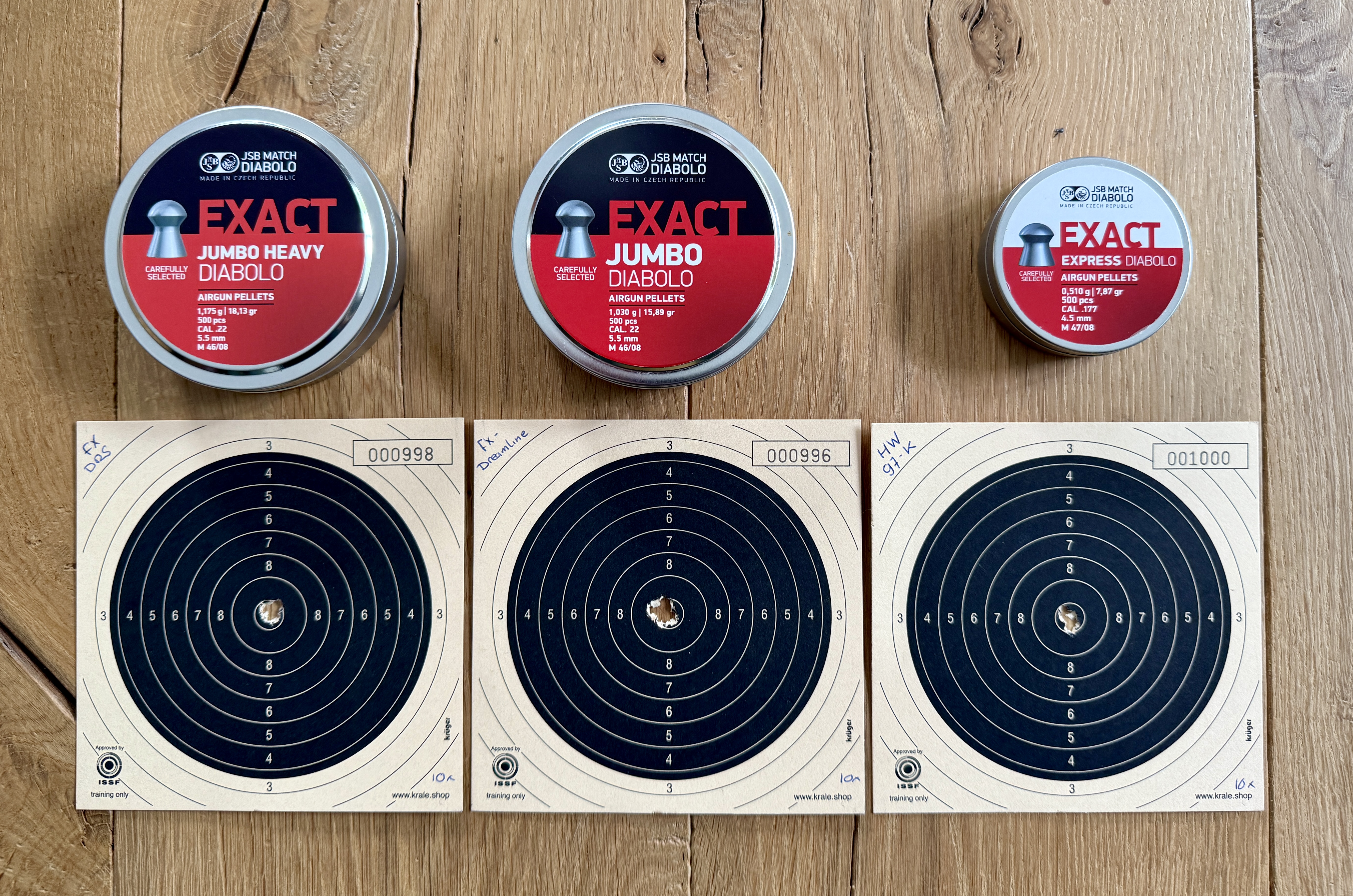

So are springers accurate. Well, you be the judge of that. My guess is that they are according to these 10-shot groups, shot from the prone position, on 50-meter ISSF visuals shot from a distance of 25 meters.
Is a springer good enough for ethical headshots? This 21 joule (15.5 ft·lbf) most definitely is, at least up to 45 / 50 meters. The HW97 has set me back (unscoped, but including the new stock and internal tuning) around €1400 euro's, which is more than the average PCP by itself, but lacks the air tank, compressor and other stuff you need to keep a PCP going. In other words, you can shoot all day without running out of air. But please do invest in a good quality springer like a Weihrauch, because the Rekord trigger alone is worth the extra money, and it will last you a lifetime if you take good care of it.
