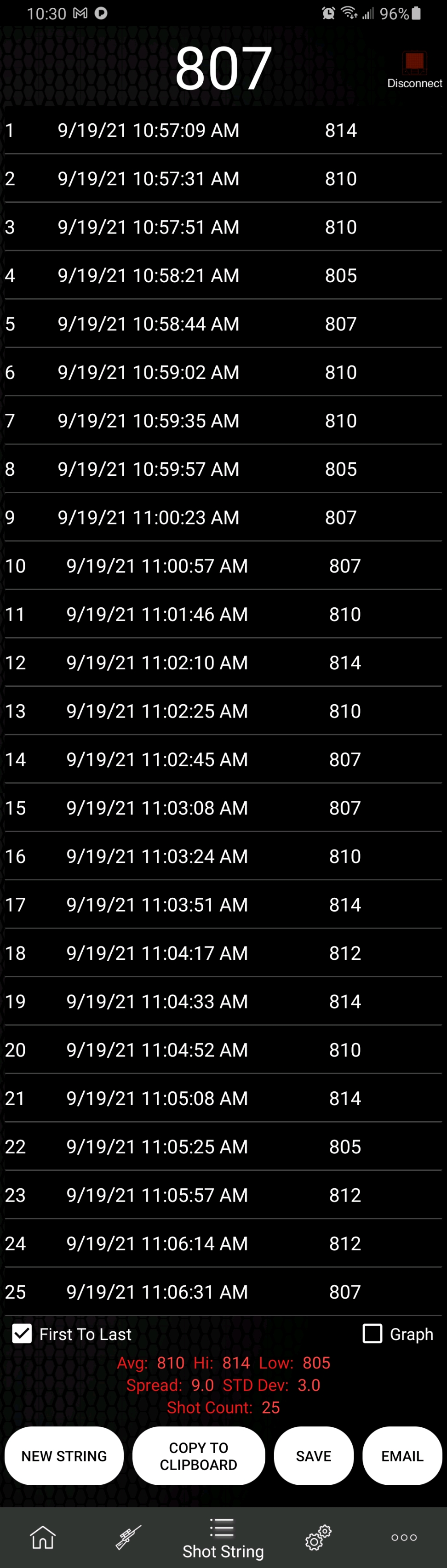

This is actually with my .177 97K. No spacers at all and I'm using the plastic top hat and steel guide from a Vortek PG4 kit. The spring itself is the standard 12fpe spring Vortek supplies their PG4 kit BUT cut two coils longer per my request. I gave the spring ample time to set. I'm pretty close to 700 pellets through it now and I've settled at 810fps give or take. Chrono string below:

Thank you for the info man! I'm very close in power already so I'm just going to snip out a 1/4 of a coil and see where that puts me. Appreciate all the words of wisdom and I will look into opening up the transfer port some as well.
